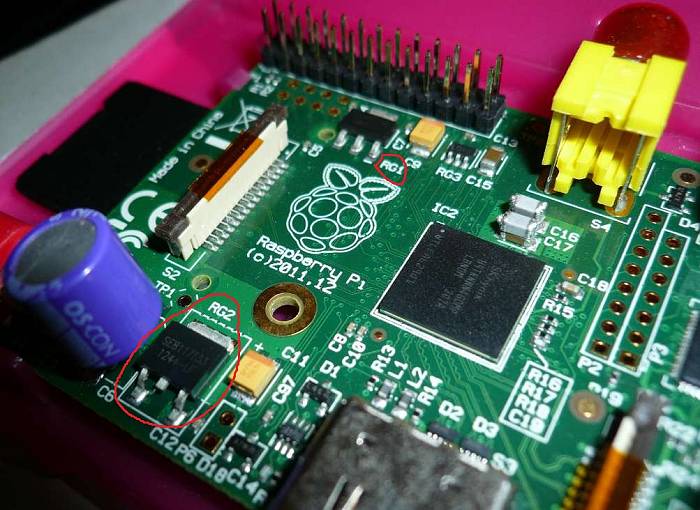

Search on the net, nothing much found about:
To improve cleaness PS for raspberry(raspfi)?
Any better ideas modify onboard regulators except
building a linear 5v power supply(LT3080/LT1083)?😉
seaward electronic SE8117 3.3v regulator.

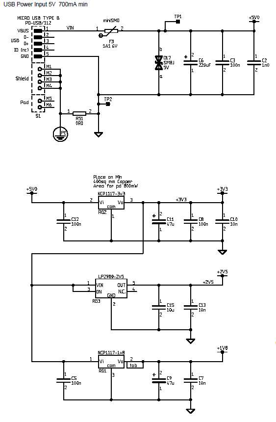

*RG2 on raspberry pi rev2.0 schematic
Both regulators has an tantalum caps for output (are they bad?)
RG2 3.3v has a 47u (c11)
RG1 1.8v has a 47u (c9)
Schematic for Raspberry Pi Rev.2 pcb
http://www.raspberrypi.org/wp-content/uploads/2012/10/Raspberry-Pi-R2.0-Schematics-Issue2.2_027.pdf

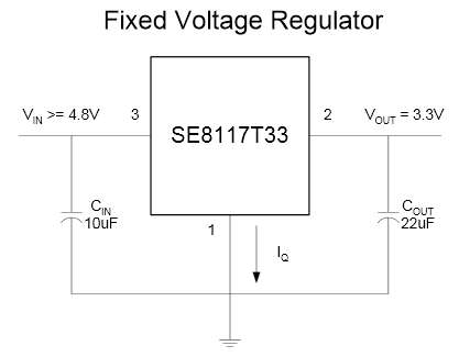

SE8117T33 Datasheet
http://pdf.dzsc.com/SE8/SE8117.pdf
