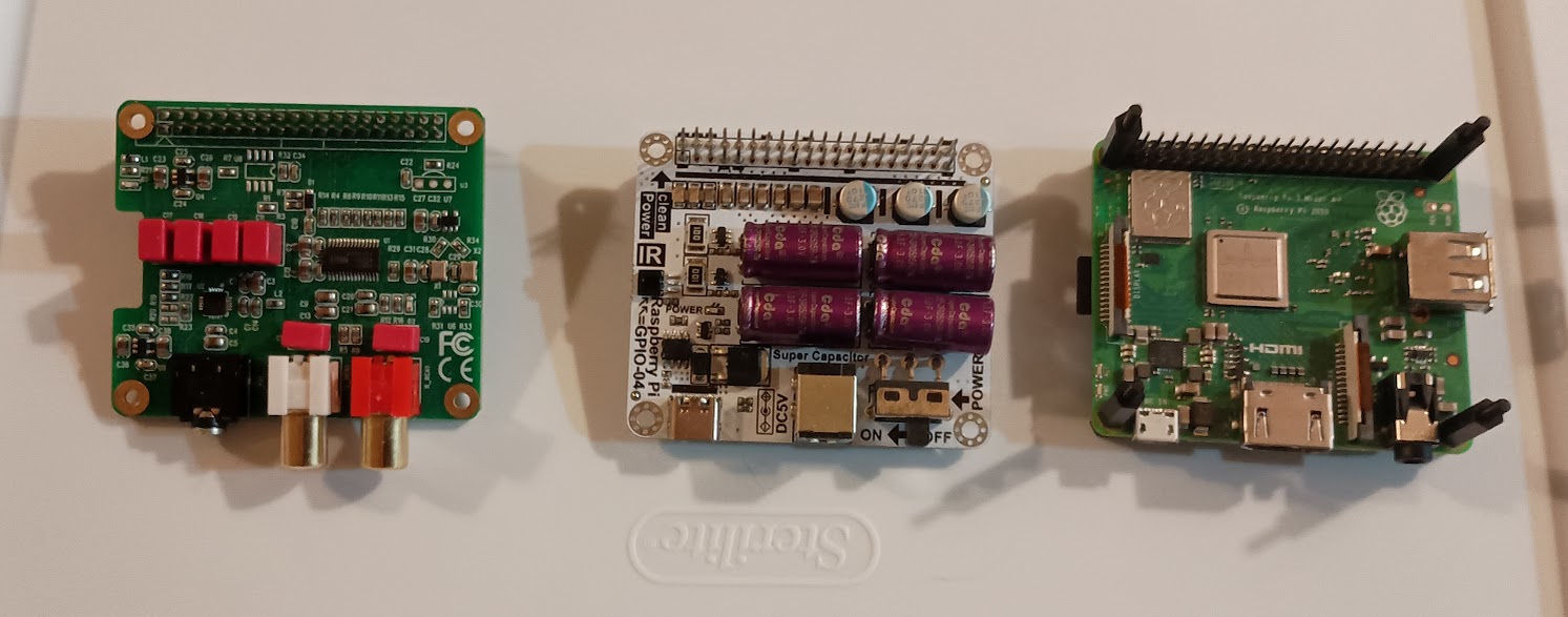

I use a Rpi 3a+ with an InnoMaker DAC hat that has a nice Hi Z headphone drover in addition to the RCA outputs. Also a power filter board, fed from a 5V 5A power supply. Running PiCorePlayer. There's a bit of setup, you have to enter the Wi-Fi info either by connecting a keyboard and monitor to the Rpi or editing a file in the root of the SD card. Then you have to set up Logitech Media Server on the Rpi, set your permissions for your streaming services, maybe set up another server for that, and you're good to go! I have a 2nd set up in my shop, it works as a satellite without needing to set up another LMS. Ez Pz.
