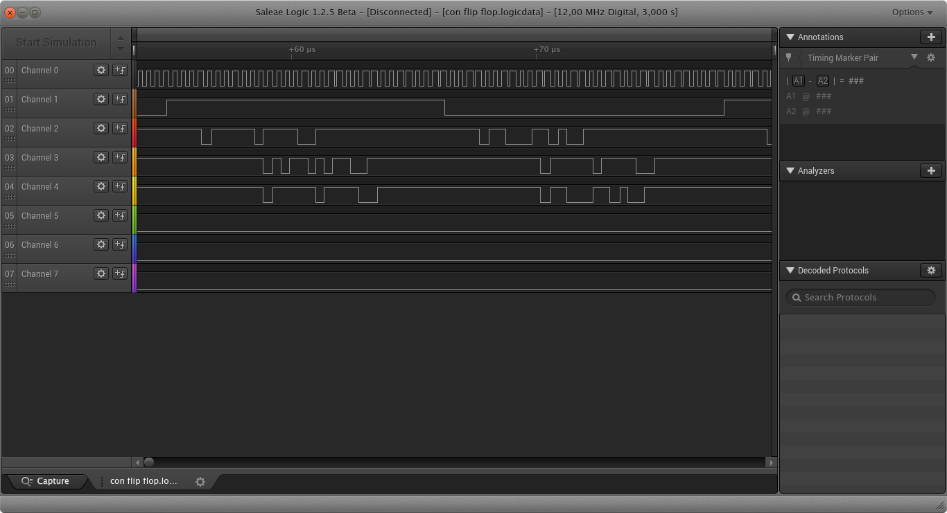

I confirm that with volumio 1.51 on my RPI can't get 24 bit over I2S. I've check with logic analizer

Signal is like this screenshot
Ch 0: Bit clock
Ch 1: Left/right
Ch 2: Data
Ch 3: 39 bit delay data
Ch 4: 7 bit delay data
Sample rate is correct but as you can see only 16 MSB comes from RPI.
Last 8 bit are empty (0).
