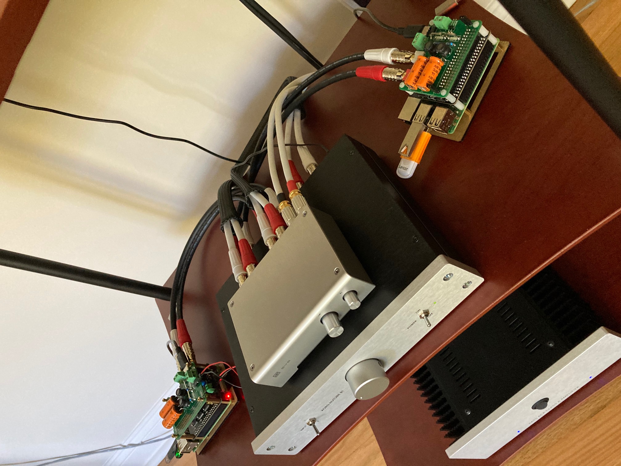

Also there is Mark Johnson's DC power filter circuit which I made a board for, with the USB-C input receptacle for the official 3A RPi wall warts. The board has mounting holes to stack on top of the DAC HAT, and for the HiFiBerry cards at least, can provide power through the offset GPIO block. In fairness, I didn't notice any improvement in sound quality when I used it on top of a HiFiBerry DAC2HD on my RPi 2B. Below is a picture of my Pi's with the filter card on top.
Lots of things to try, iow.
