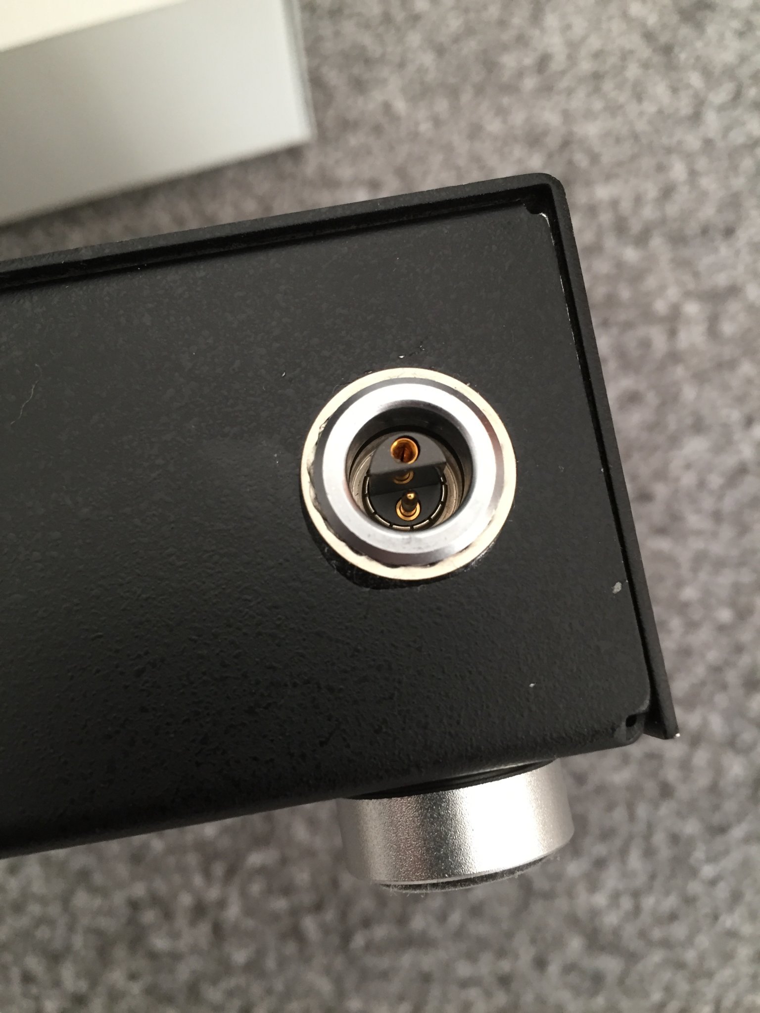

Ah well I throw a fancy name. One could use Lemo connectors with very good results. Way better for the purpose.
