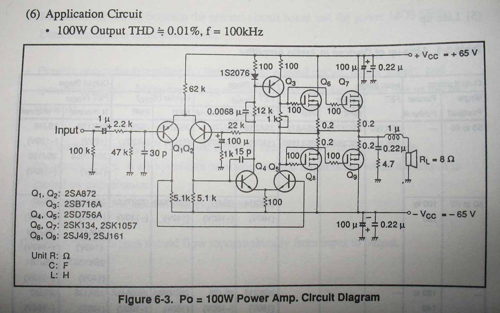

I wouldn't call it "badly designed". I wonder though why Nico has so little current in the VAS stage? The drive capability for the mosfets will be very low meaning a slow amp.
The amp will also run in class B (possibly) since the D1 and D2 is not enough and certainly not trimmable. The Gate threshold voltage is normally aroung 2 volts. This means that the two diodes must produce 4-5 volts at least compared to 1,4 volts right now. It's worth mentioning that the gate voltage can be down to zero volts so in this case you'll have trouble with too much idle current.
See the original in the attached file.
That design is from a Hitachi lateral mosfet application note.
It was designed about 1980.
Maplin took it for their lateral mosfet 75WRMS power amplifier.
Many hundreds were sold.
I have built a couple.
I even improved it for my own use and got a pcb made.
I added CCS on LTP. I replaced diode in current mirror with transistor. Added decoupling to front end to stop hum from power supply.
My version sounded much better.
