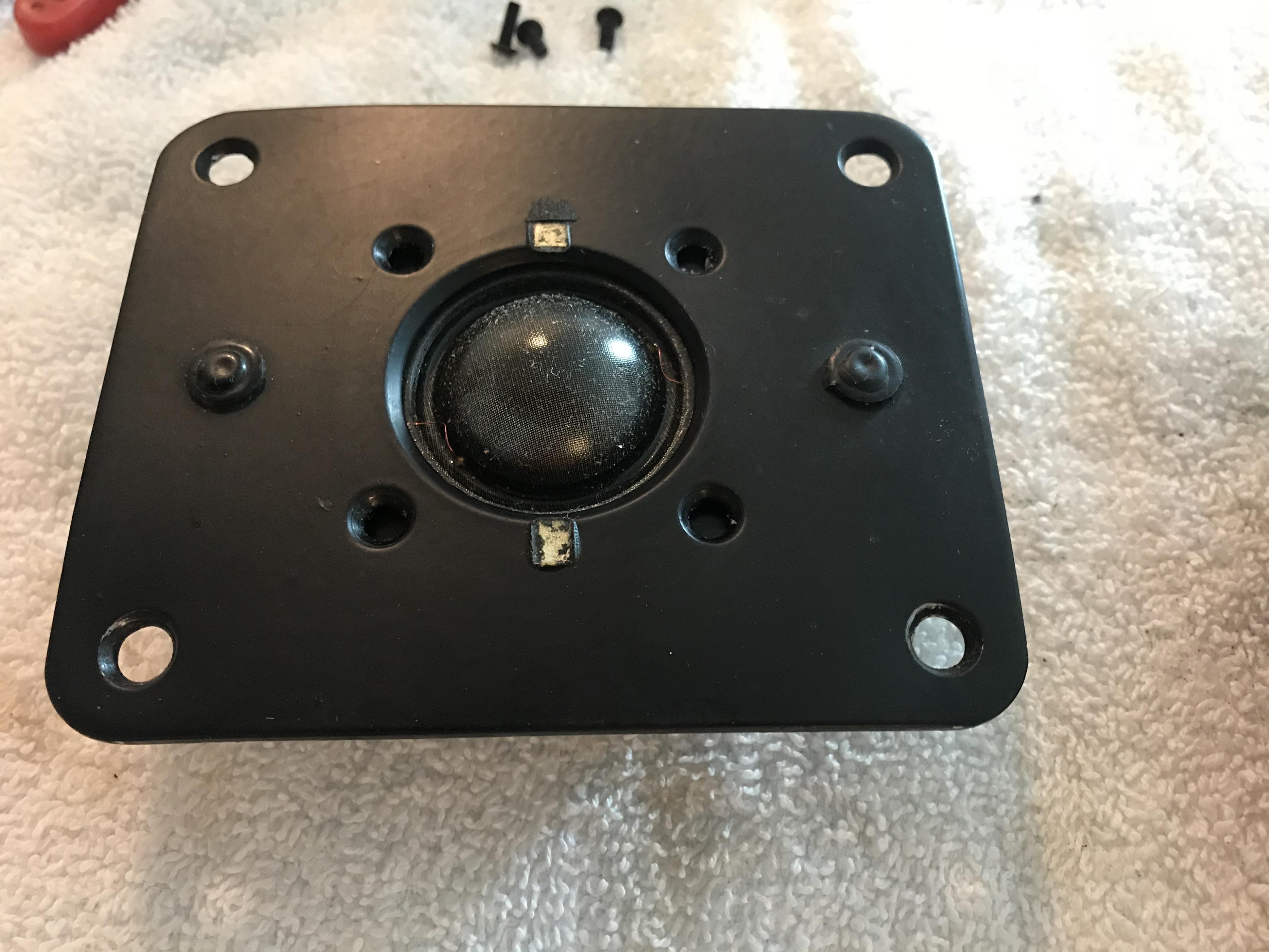

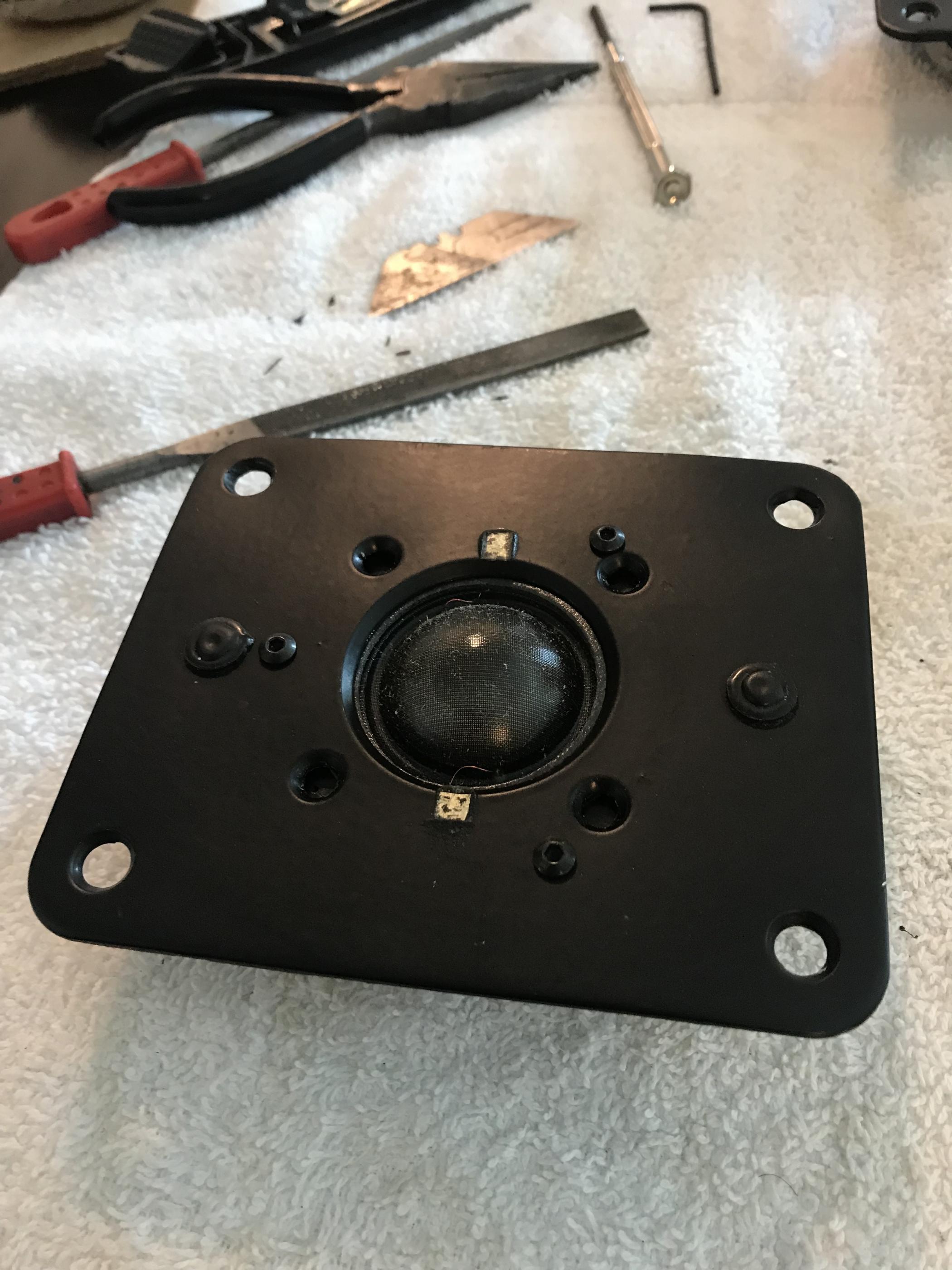

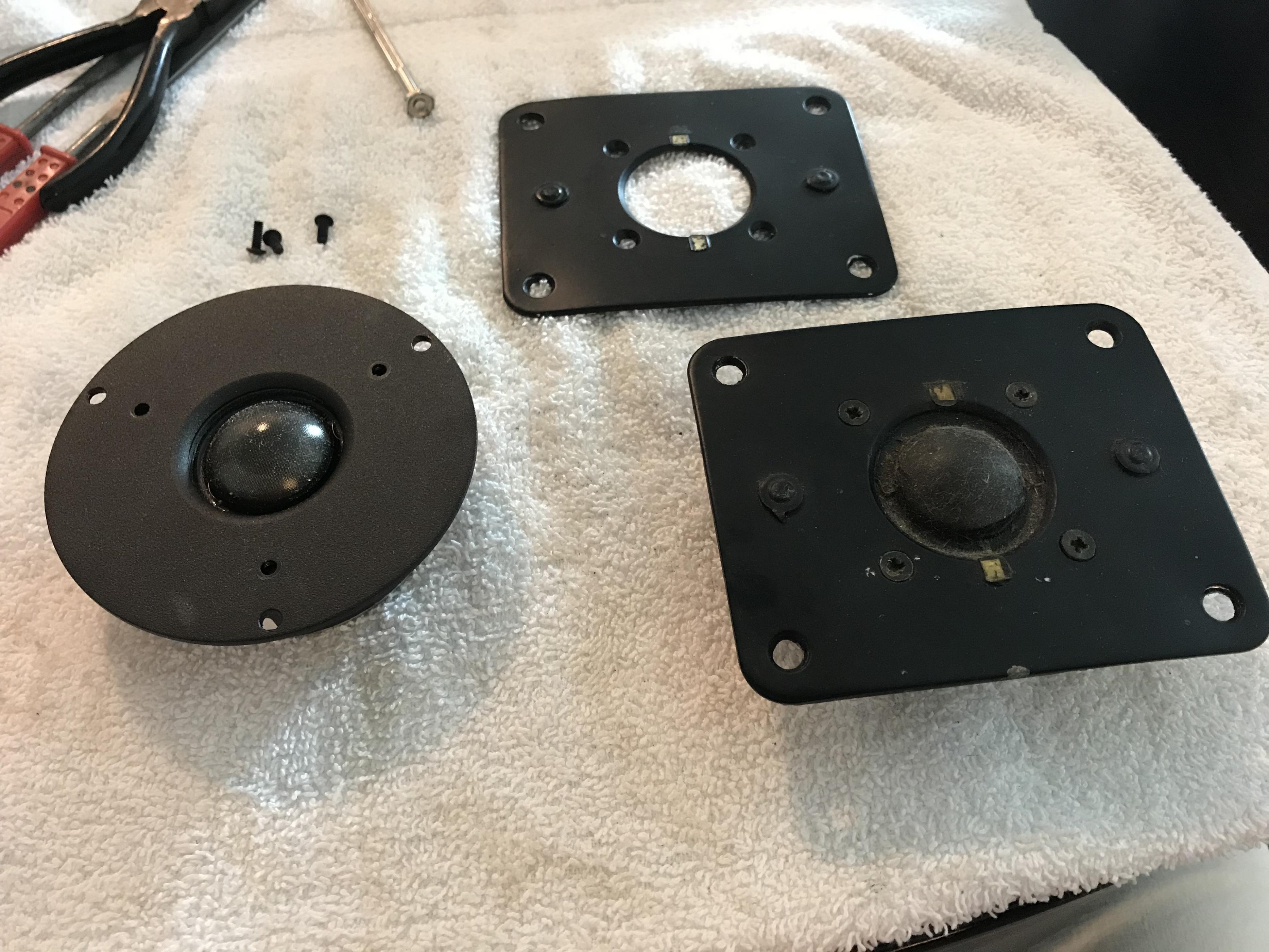

Morel have replaceable 28mm voicecoils and a removeable aluminium front plate with a 33mm aperture. The aperture just leaves room for the voicecoil leadouts to stand slightly proud. FWIW, you shouldn't try to pull off the voicecoil itself without unsoldering the very fine wires at the connector pins.

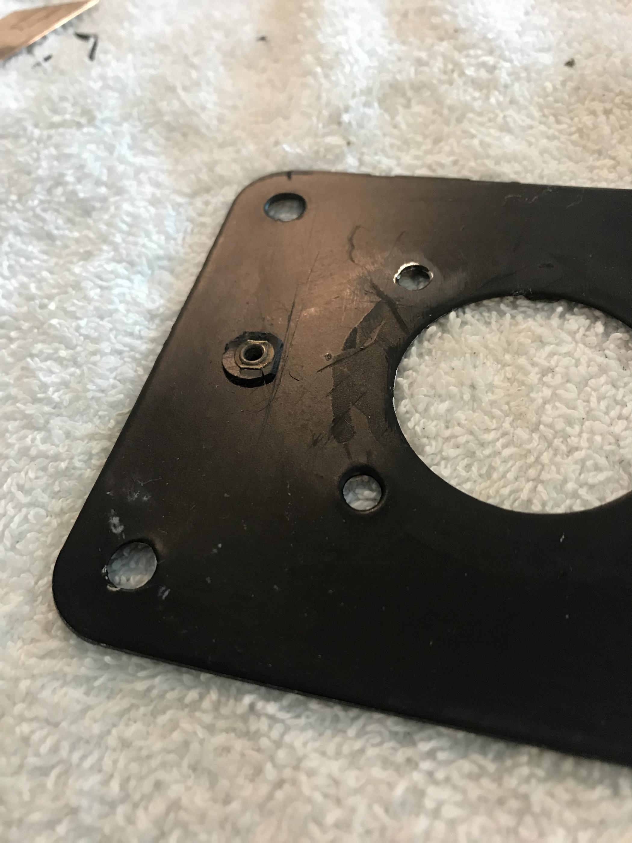

This is a 94mm tweeter, so I don't see anything hard about stretching the 90X110 mm rebate to fit. But using the original faceplate is evidently doable with three accurately drilled new holes .

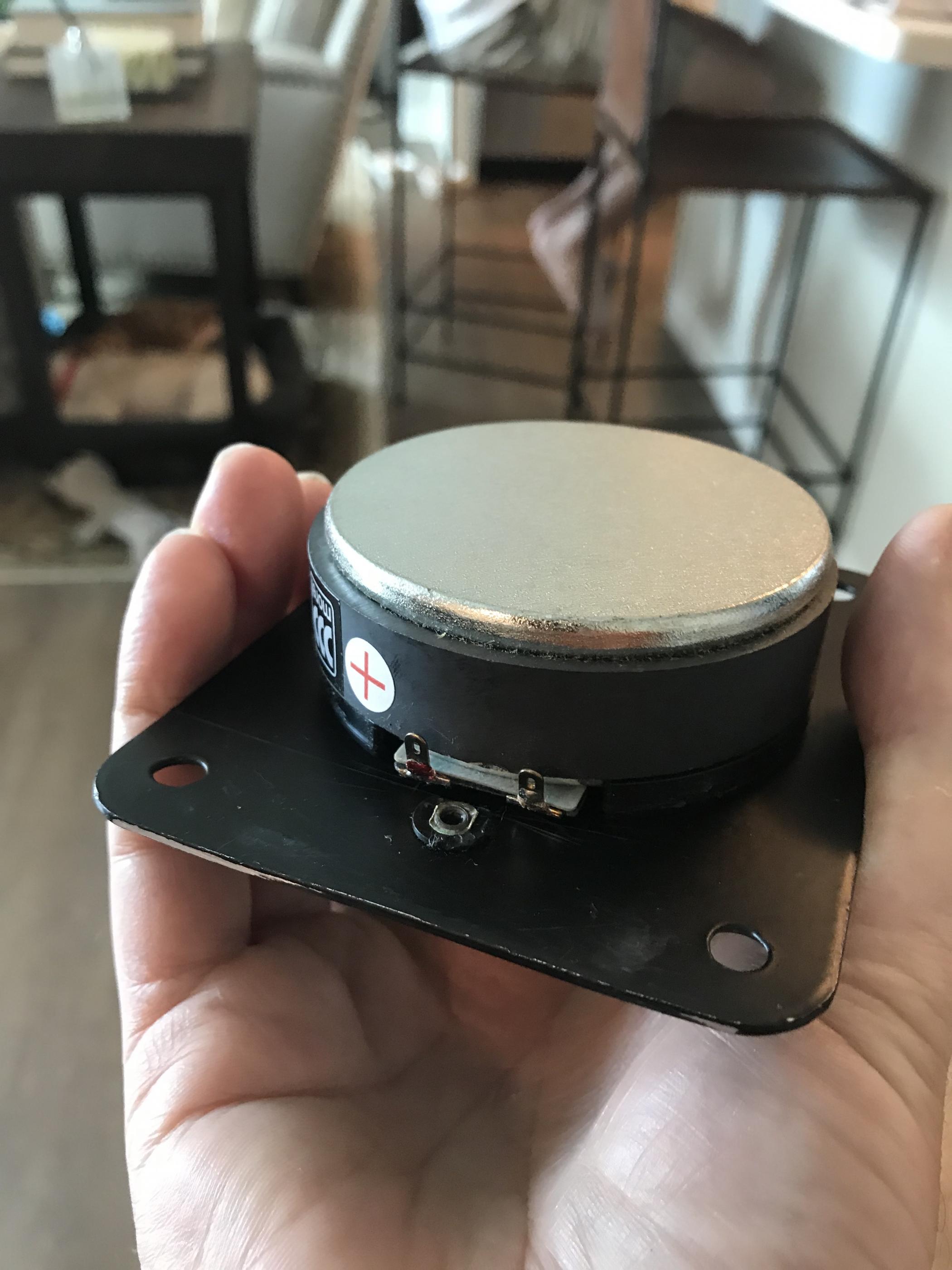

It's a 89dB jobbie, which is actually lower than usual. But since you have some sort of level adjust, hardly a problem. I just got my own out of retirement, and they actually sound very nice on a 4th order filter, which I suppose deals with the highish 18 ohm Fs impedance well.
BTW, make a note of tweeter wiring and polarity when you disassemble. Saves some head-scratching later! LOL

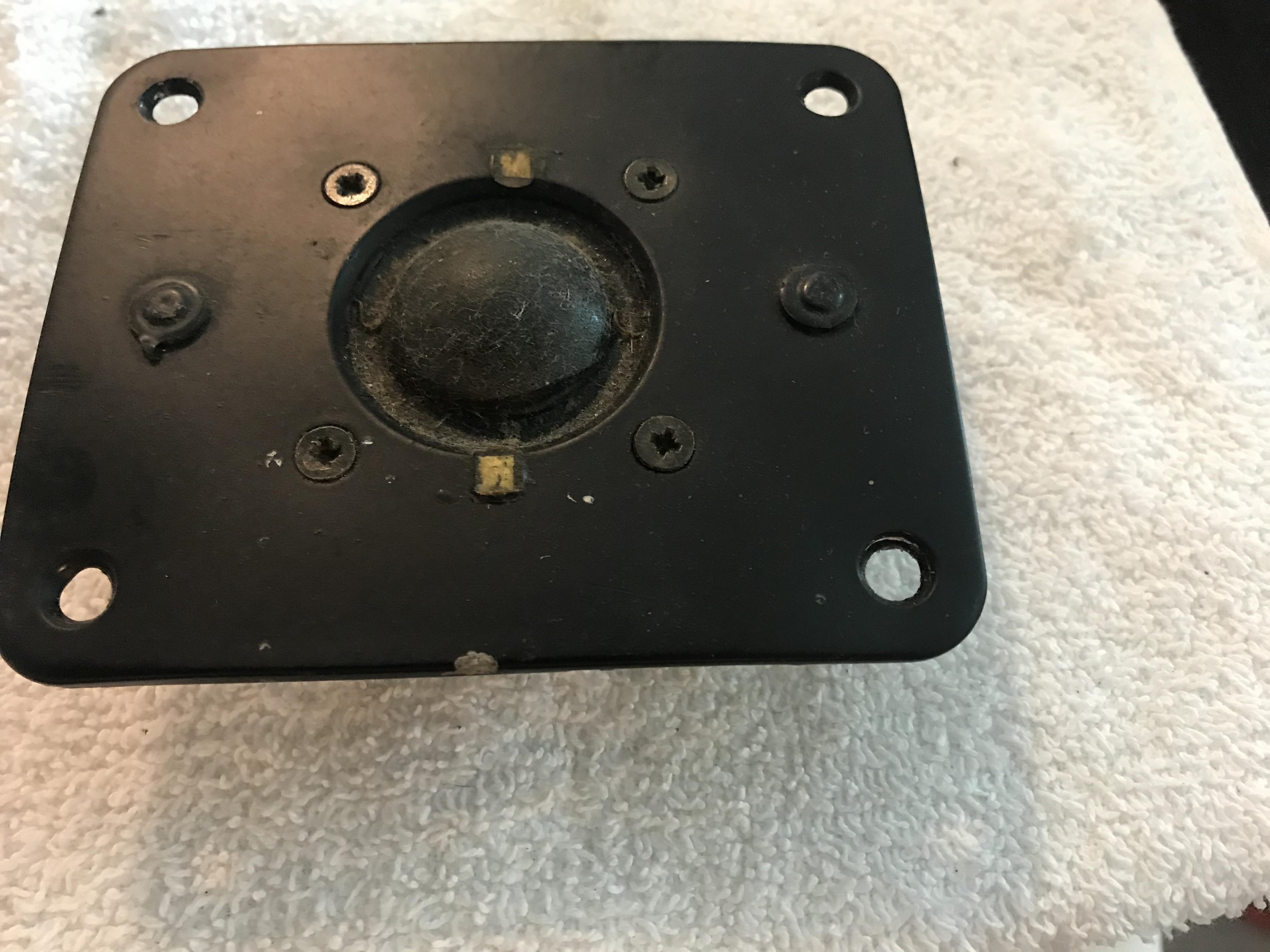

No real luck at all. The repair shop i found made something that didn't fit. And ultimately didn't meet the audio quality I expected.
So I did it myself as described in the thread.

I must say the Morels seem to be every bit as good as the dead tweeters ever were.
On initial listening, I thought I needed to increase their levels a bit. But then I put on several different records and liked what I heard.
So, I'm going to leave them alone for a while and not "cheese them out" avoiding the "more is better maxim!"

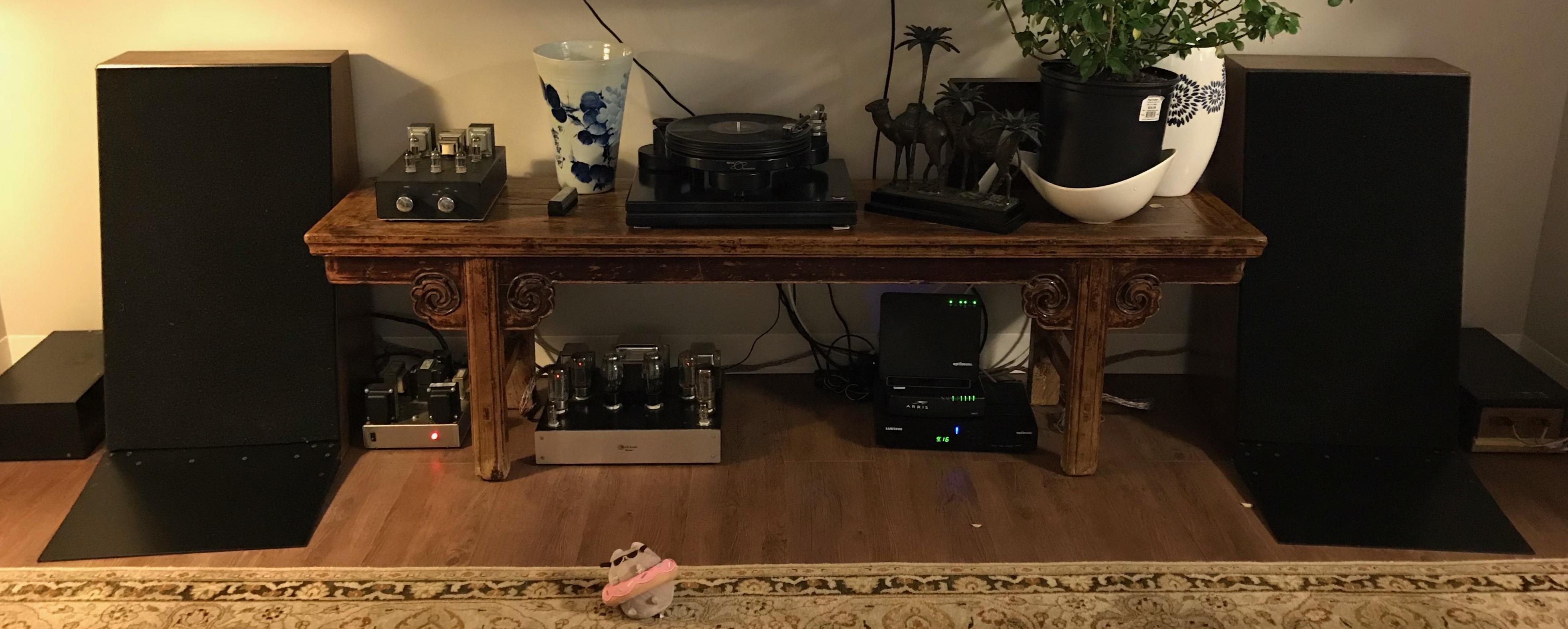

Hi!
iconic loudspeakers!
Some here claim that loudspeakers like that, with drivers just above the floor, inevitably set the soundstage accordingly - unrealistically low, just above the floor.
Can You please comment on that, as a user?
Yes, the soundstage is oddly low. I find myself sitting forward and leaning downward sometimes. There is an obvious sweet spot that sounds amazing. I do get instruments and sounds that seem to be all around and outside of the loudspeakers at times - so happy with the overall imaging.
I think these loudspeakers sound very accurate, uncanny on some material. Maybe that's to do with the reduced floor reflections?
