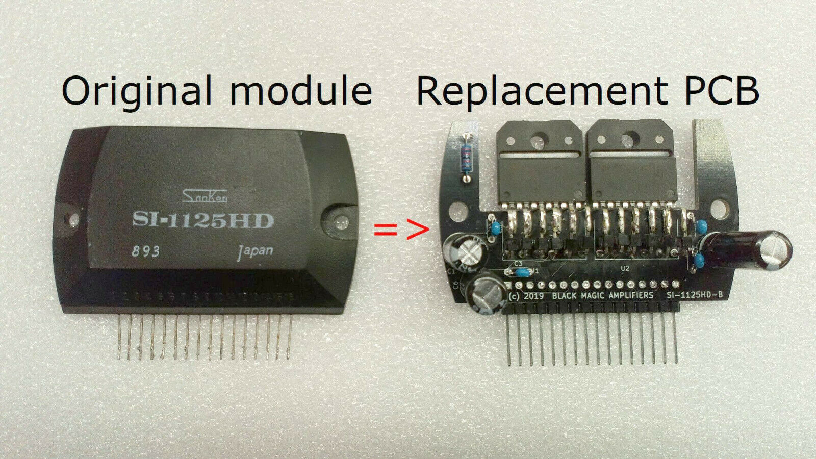

I came across an interesting possibility - whilst searching for a replacement Sanken..
Its an LM3886 based drop in replacement! - see pic
One question I have - It says in the description
"This board is designed to be used with a split power rail to give the lowest distortion and will require a capacitor to be bypassed on the host PCB - very easy to do."
My understanding is that I already have a split rail there being +30Vdc and -30Vdc or am I misunderstood?

And with that in mind I have spoken to the BMA company wrt to the Sanken SI-1125/1135-HD 'Drop-in' Replacement (LM3886 based) Amp Module...the company checked over the circuit of the Receiver and they believe it will work ok...with only a single Gnd Reference modification - (remove cap and join/short the remaining solder pads together to achieve that.)
So that replacement module is on order...will drop it in do the gnd ref mod and see if we have a winner.

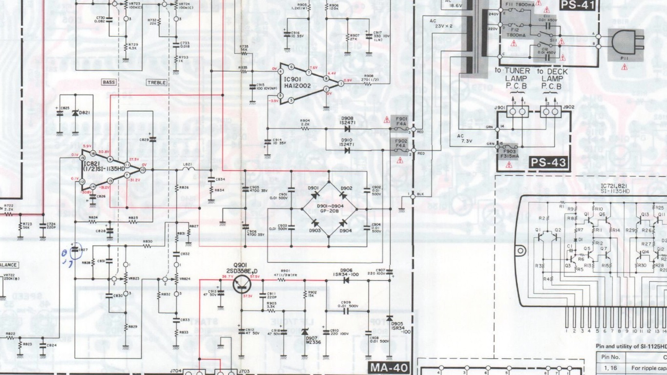

Worth checking the speaker relay. I've just swapped out the relays on Mitsubishi M-A01 amp due to some very similar issues with channels going quiet or getting crackling.
It's a very easy thing to check, as you just need to touch the positive of the speaker wire to the input on the speaker relay (D909 in the second image you attached in the first post) and see if that gets you a clean output. If it does, you've found the source of your problem.
Not saying this is your problem, but the silvering can come off the contacts on a forty-year-old relay easily enough, and it's a simple thing to check and a cheap thing to replace.

Hi all, I stumbled across this thread with great interest. I have one of the above systems and I'd be grateful if anyone could tell me how to locate the fuses mentioned in the OP. I've gone and blown the left channel fuse (i hope) all else is good and the left was good til I thought I'd try and get away with connecting the left speaker "live" my own fault I know.
Steve
Problem sorted, my impatience (which led me to have this problem in the first place) had me taking the back off and located the fuse pretty quickly, sure enough it was blown. As luck would have it I had an old receiver in the garage which had a comparable fuse in it, but it all started with the schematics posted here, so thanks very much indeed for that
