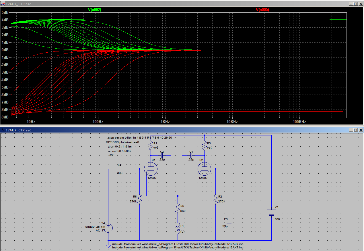

The interesting thing is that even a small about of inductance gives near perfect matching in the mid to upper frequencies. The amount of inductance simply moves that matching lower in frequency so if the amplifier is intended for limited bass output (bi-ampimg for example) the inductance is not critical.
In this circuit even 4 or 5H gets you down to 100Hz before diverging by more than a couple of dB. Will have to check the effect of adding some more resistive tail.
Ran a quick sim. Additional resistive tail limits the maximum deviation but not the frequency at which diversion comes.
5H at 100Hz is 3K reactance.
3K is much more than 1/Gm of a 12AU7.
OTOH, at say 10mA total tail current, a dumb/cheap 3K resistor drops 30V. So a say -24V rail (or elevated grids) and 3K resistor does the same as 5H does at 100Hz, except also all the way to zero Hz.

If you are going to use an inductor as a current source for a LTP, consider the real impedance of the 2 coupled cathodes.
At 250V P-k and 10.5mA, the 12AU7 Gm is 2200uMhos (455 Ohms), and u=17.
(Yes, with a 300V supply, the plate voltage will be lower than 250, & other values will change too, but this is just to get a ball park set of values).
Post # 22 has plate loads of 22k Ohms.
22k/17 = 1295 Ohms
The impedance of one cathode is 1/Gm + Rp/u; 455 Ohms + 1295 Ohms = 1750 Ohms.
The LTP cathode pair is 1750/2 = 875 Ohms.

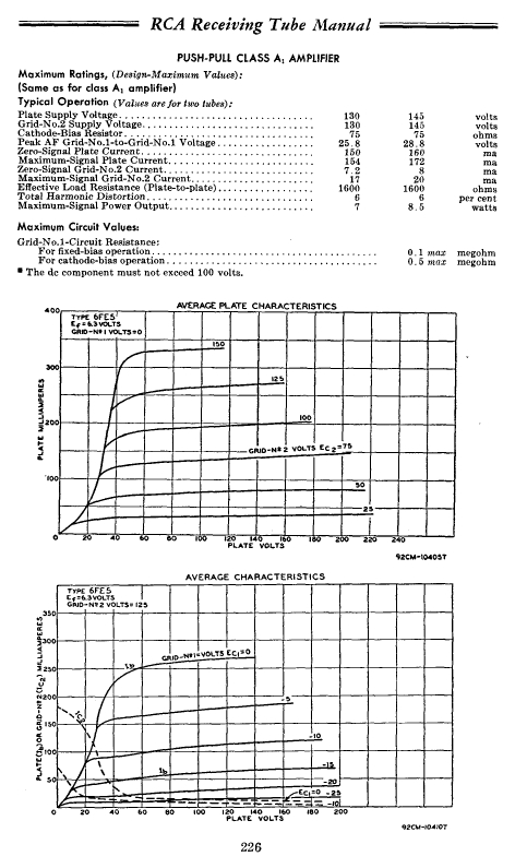

Here is some data from my testing of the 50C5's. The 50C5 has the same size plate as the 6AQ5 which is rated at 10 or 12 watts depending on how it's used. I am assuming that the 5 watt rating on the 50C5 is conservative since it's intended for continuous operation in class A table radios. Testing reveals that a 6AQ5 will red plate at less power than a 50C5, but this depends more on quality of construction that anything else. The 6AQ5 is a cylindrical design which requires colinearity to avoid red spots. the plate is very close to the glass so that red spots make holes in the glass!
Plate voltage was 340 volts, screen voltage ranged from 110 to 150 volts. This page shows the 6600 ohm / 150 volt data. It affords the best overall efficiency, keeping plate dissipation below 10 watts at power outputs up to 30 watts. Screen dissipation is a non issue until clipping is reached, hence the limiting system for guitar amp use where clipping is the norm.

Data for 6FE5/50FE5
Thanks, I have a scan of the RC-18 and an RC-30 and it's not in those. I have paper copies of several interim versions, but they are still in a box somewhere.

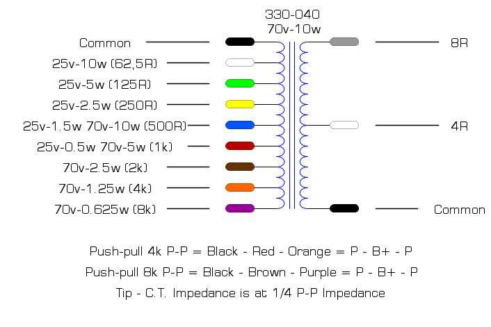

I remember what I was looking for - it was info on the 330-040 70v-10w transformer!
I decided to make a definitive reference for it, so anyone who decides to use one in the future doesn't get lost in trying to figure it out.
Attached is a diagram with expected impedances and how to wire it up for push-pull. Cheers!
