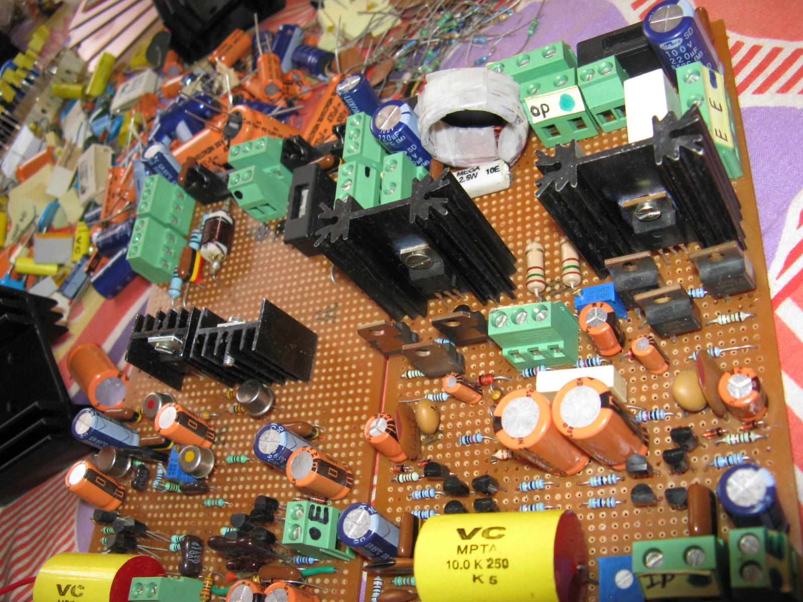

I am currently building his AMP on a general PCB, it is just TOO good!
It doesn’t oscillate and I have learnt a lot through his book,
I will remember him but sad that I couldn’t thank him as I had planned once I complete it.
I have sacrificed my families’ time and spent 6 weekends on his book and assembling the circuits,
Even in office whenever I get time I read his book, I miss him real bad.

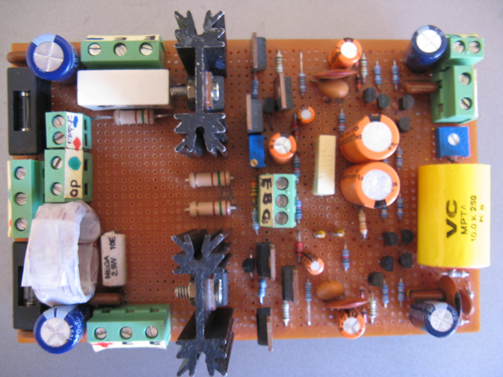

Smathias,
Looking at your pictures I understand you used a mirror image topology with current mirror loads in the diff amp, also using cascoded VAS and two pole compensation.
There are many people here saying the VAS idling current is undefined. I share their issue. I tried to build that amp many times and it very seldom works. When it does today it will not tomorrow because of temperature change upsetting the VAS Iq again ... I started lately a thread about it...

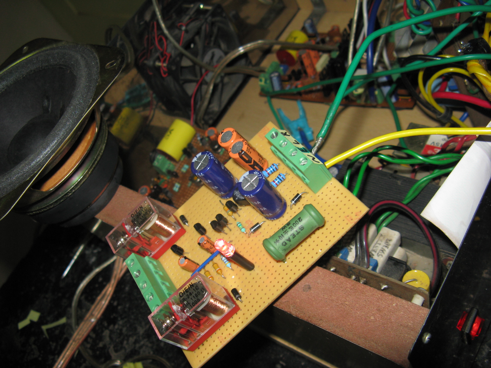

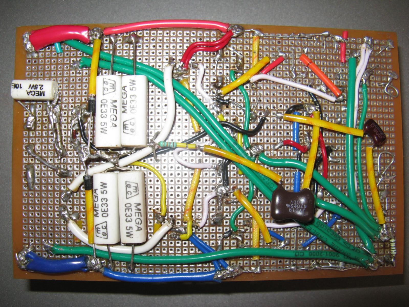

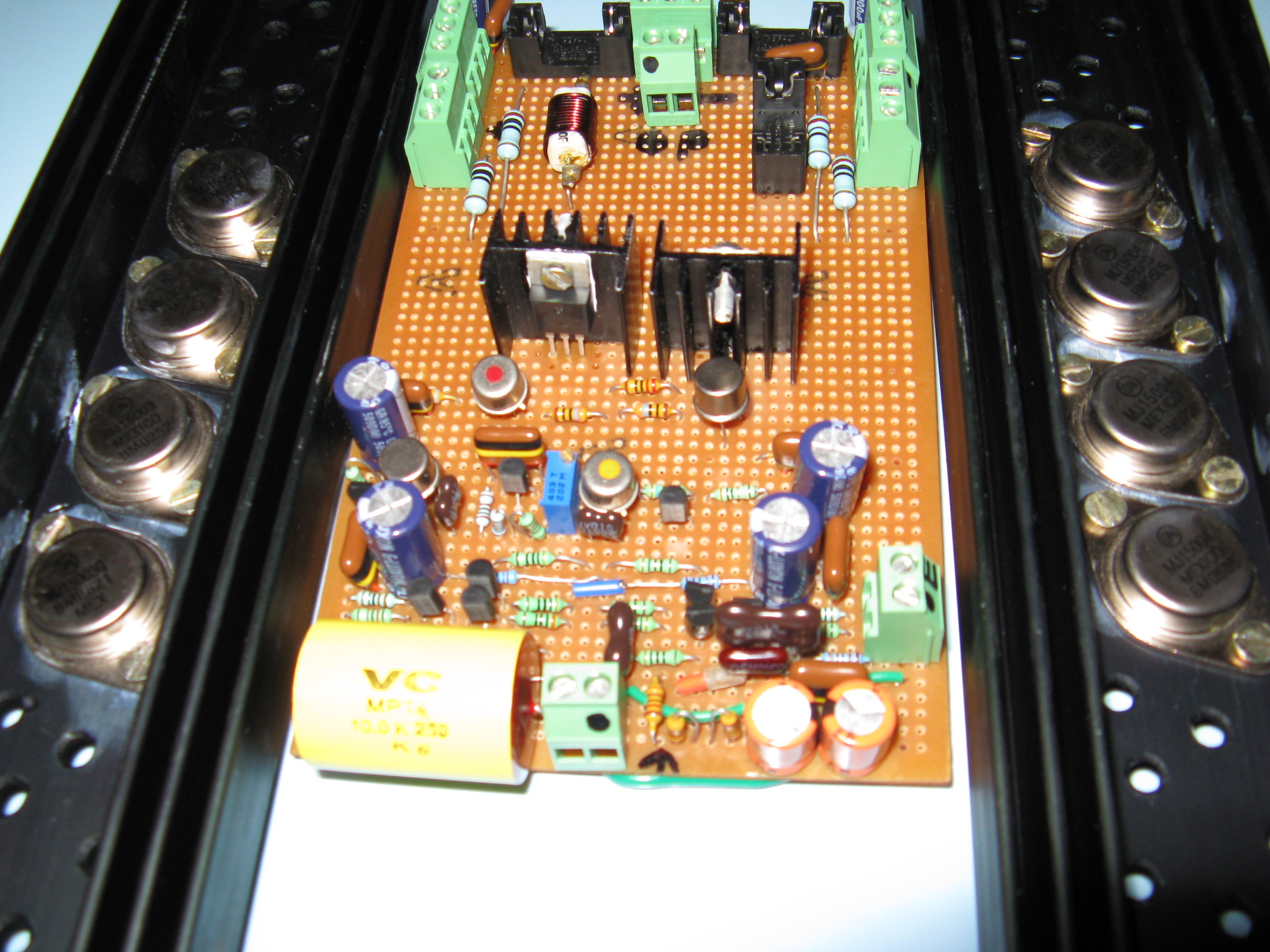

Hi Oliver73,
Yes it works perfectly fine and currently spent so many hours on fine tuning it.
I have assembled Slone's circuit of Figure11.12 on a general PCB but the BIAS/Vb multiplier was not stable. Though it worked fine but when i tried to adjust the voltage to 2.88V across Q19 it was not stable and once overshot and damaged my out and driver stage.
So to solve this problem all i did was to removed Q11 & Q12 and modified the circuit around Q13 & Q18 and it is PERFECT and very stable! I have Q19 on OP heat sink along with trim pot. I am using output Triples with feed forward circuit so the negative feedback has different values. It is stable with no oscillation and I can share video/photos what I have done so far, I am using MPSA42/92, TIP41/42 and MJ15003/4
I would say Slone’s topology is superb!
It turns on and off softly and no thumps at all, it sounds good to my ears better than Blameless.
