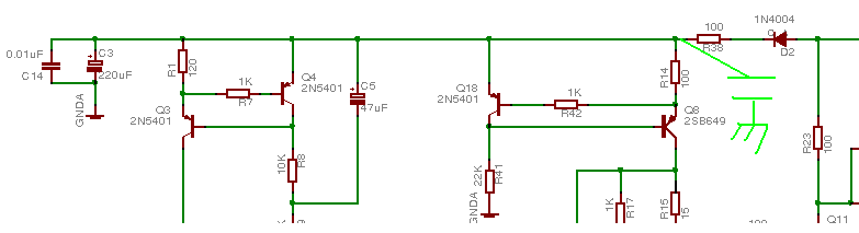

Have created a separate CCS for the VAS (I think!). Will you please check it? See Q18 and R41.
What value should I set R41 to? I guess it can be anything which allows about 2-5mA to flow from supply rail to ground, right?
Can I knock off R42 now?
R41 should allow about half the current that the CCS passes, but as you suspected there is a very wide accepatable range. You may find that one small range of current particularly suits Speed OR Stability OR temperature compensation. If you are VERY lucky you may find that you can get two of these, but I have neither the patience nor the expertise to recognise the desirable characteristics (I may have omitted something even more important).
R7 and R42 can be omitted.
The CCS on the LTP can operate from a much reduced Vrail so a resistor and cap could usefully take up the space you gained. ie. r9 is deleted and a new resistor is inserted between C5 and Q4.
So there is a possibility that the value of R41 will affect stability? I'm beginning to feel a bit nervous.AndrewT said:R41 should allow about half the current that the CCS passes, but as you suspected there is a very wide accepatable range. You may find that one small range of current particularly suits Speed OR Stability OR temperature compensation.
Incidentally, if I have to take your feedback and that of others on the other thread I started (about Fig 11.4 Blameless), I'll be running VAS really hot, at perhaps 25mA. In that case, R41 will have to carry about 10mA of current? The current setting is for about 2-3mA.
Cool. I had hoped as much.R7 and R42 can be omitted.
Great.The CCS on the LTP can operate from a much reduced Vrail so a resistor and cap could usefully take up the space you gained. ie. r9 is deleted and a new resistor is inserted between C5 and Q4.
BTW, won't I need a resistor between C5 and Q8, not Q4? If I don't put the resistor to the right of C5, it won't be a smoothing voltage divider, I thought. If it's just to reduce rail voltage but not to smooth it, what benefit does it give?

Hi Tc,
R38/C5 reduce rail ripple AND keep Vrail high. Q8 needs to swing rail to rail to allow the output stage to work to maximum output. C5 will probably benefit from being increased. (R9=0.0)
Rextra(between C5 and Q4)/C3 reduce rail voltage to some lower value (anywhere between 50% and 90% of Vrail) and feed the tail of the LTP CCS with an almost completely ripple free supply.
You mean C14 and C3?thanh said:Why don't you place C4&C13 between input stage and VAS?
In that case, will it be better if I just allow for separate regulated 15-0-15V supply (of the kind used for opamps) for just the input stage?AndrewT said:R38/C5 reduce rail ripple AND keep Vrail high. Q8 needs to swing rail to rail to allow the output stage to work to maximum output. C5 will probably benefit from being increased. (R9=0.0)
NO!.
the LTP needs full voltage on the collector load.
It's just the tail that can operate with less rail voltage.
With resistor load for the tail current you want a very high rail voltage to try to achieve constant current.
With a CCS loading the tail, then there is not such a need for a high rail voltage and you can take advantage of this by using a long time constant RC to attenuate any ripple on the tail, or cascade two RCs, or add a zener instead of the second cap. Many options due to using the CCS.

v10: with separate CCS for input and VAS
I separated the CCS of the input stage from that of the VAS, and made the VAS CCS into a double-transistor CCS of the kind Randy uses in all non-mirror-image schematics. (Apparently they regulate current better than double-diode or LED-based CCS, and also give better PSRR, which is important for single-ended topologies.)
The PCB layout has been updated to accept the second CCS (Q18 and passives) and all tracks running to INGND or the PGND points have been separated, i.e. unrelated sections of the circuit do not share a common track to one of the ground points. So each ground point now looks like a local star-ground.
Awaiting any further feedback.
