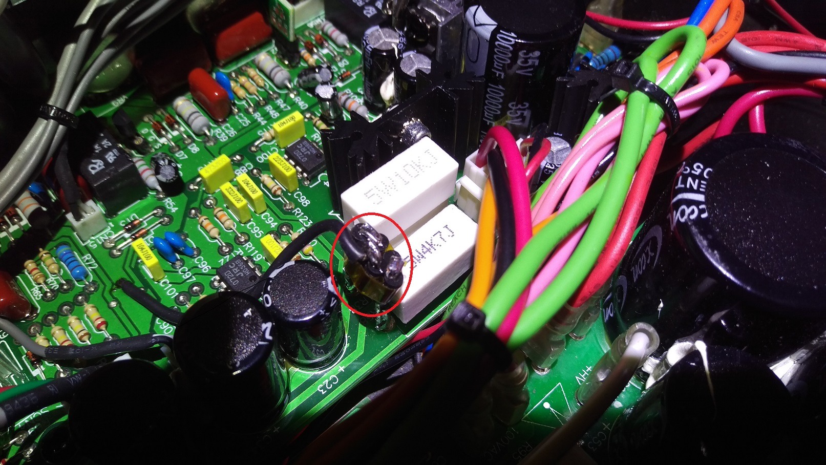

I put a 10k 5W resistor in parallel with R38 for a final resistance of 7.6k and installed a string of three 100V zeners. Left R58 at 4.7k and installed zeners there too. Voltage settles at 326V after the zeners warm up (get up to 70C). Better than the 380V the LND were seeing before, and it will clamp any voltage spikes.

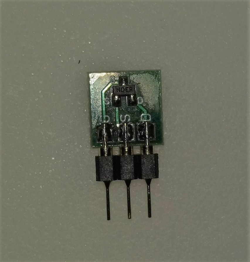

Mounted an LND250K1 on an adapter and threw it in Q2. Verified that it's functioning properly and then toggled the switches for CH1/CH2, Boost, and power a bunch of time. It's still working. Even a 50Vrms output of Q2 looked good. A 1kHz tone sounds clean now.
Guess I'll call this a win for now and give the amp back. If he has a trouble with it in the future, I have a lifetime supply of real LND150N3 on the way.
