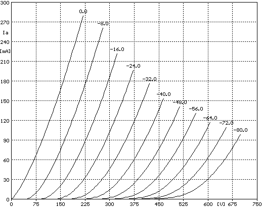

Below are a set of KT88 triode curves for you to look at and try some loadlines on. An a full datasheet can be found at http://frank.nostalgiaair.org/sheets/084/k/KT88.pdf

Yes indeed I have. The STC datasheet from www.retrovox.com.au is excellent and has a full set of triode curves plus graphs showing the H2 and H3 as a function of input voltage fpr some op points. The curves look excellent, and I love the ST bottle and topcap, but they seem to be a particularly unloved tube. The DHTs, and the popular tets and pents are all you hear about.fdegrove said:Brett,

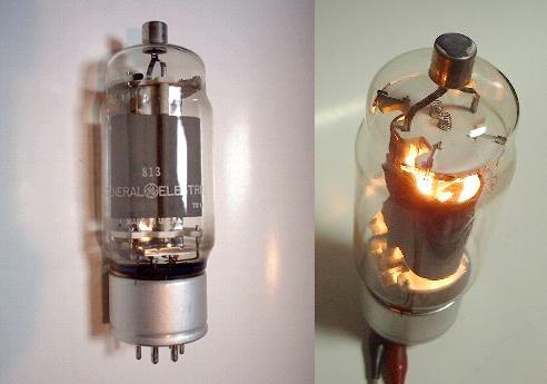

813
People,
My guess is that as long as the real McCoy was around people did not want to complicate their life too much.
Keep on posting stuff like this though and you'll see what happens to the stock price.
Add to that the top cap and you start to see why some people are uncomfortable with this tube.😉
Rgds,🙂
People,
Rgds,🙂

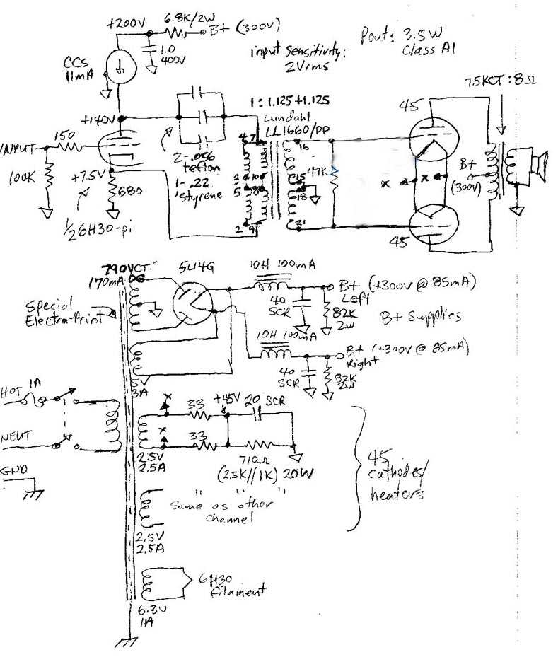

Hi 45,
That's Kurt Strain's PP45 amp there. All I know is it works, he liked it nearly as much as some of the all DHT SET parafeeds he used too, and better than his 845 PP. Lots of stuff 3 or 4 months back on the Asylum Tube DIY board.
The coupling caps into the primary of the IT are too small for fullfange, but he used it to drive the top half of his Oris horns (150Hz up). Later the driver was changed for the ECC99 with apparently good results.
You can easily modify it for 2A3's by changing the OPT to something with a Zp of about 5-6K, the 710R cathode bias the correct value for where you run the 2A3's, and maybe specify bigger heater windings on the power trans as the 2A3's draw more than 45's. Personally, I'd up the bias on the driver to about 20mA too. Both the ECC99 and 6H30 sound better there.
My hunch is it'll sound better than the Ralph Power design. Garry Dahl, who actually did the first version of that now uses a full PP setup (Olson Aurora's) with parafeed IT and CCS deiver loads. Keepind DC out of the trans could only work better IMO.
Do you have the schematic for his CCS, especially the last bootstrapped version? I lost mine in a HDD crash, and wanted to use them in something else.
Cheers
