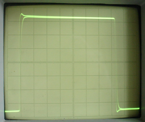

Here are some scope screenshots at 10kHz, without and with "complex" load.
The load is 4,7Ohms resistor with 0,1uF film polystyrene cap in parallel to it.
Output voltage swing is 4V peak-to-peak.
With sine signal, the load does not cause any effect, apart from some output sine reduction according to amp's output impedance (at the picture without load input and output sines are adjusted to be of the same amplitude at the screen. Afterwards, the load is connected).
With square wave, the load does induce substabtial oscillations at the fronts (time scale of the picture with load is greatly extended). At this, I do not think that I should look for additional correction and speed down, since such sharp stimulus and load conditions can not exist in real life.

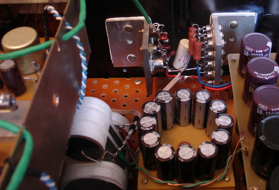

Thanks, Mike, for sharing this info. In your approach, its not evident for me that we should add series resistors to film caps. Rather I would prefer adding resistors to lytics. We also should remember that lytics have internal ESR around 0,02...0,1 Ohms.
I consider big lytics as "dirty" parts, that should be kept as far as possible from the active schematics. Their operation is subjected to various not finally established "anti-sound" mechanisms.
I did try to get better insite in what going on with shunts, I used precise immittance meter, and measured Z vs f curves. But I did not get repeating and illustrative results.
I 'd like also to warn about simulations of effects of big lytics at PS rails. Usually external distortion is added to the rail and penetration of the distortion to output is registered in the model. People conclude, look, if lytics produce distortions, we model them and see that they do not reach output. Their is a conceptual error here, the distortion from a lytic is not external, it is "generated" by the lytic itself, and formal C of the lytic can not further absorb this distortion. One should remove lytic's C from the model.
Yeah - with that many electrolytics you could add a small R to each one and the overall impedance is still low.
I will try this approach next time I make a cap bank - thx 4 the idea
But I still might add a small R to my film caps - I don't like the extreme uneven impedance vs frequency graph of film caps - prefer to remove that resonant impedance dip with some R.

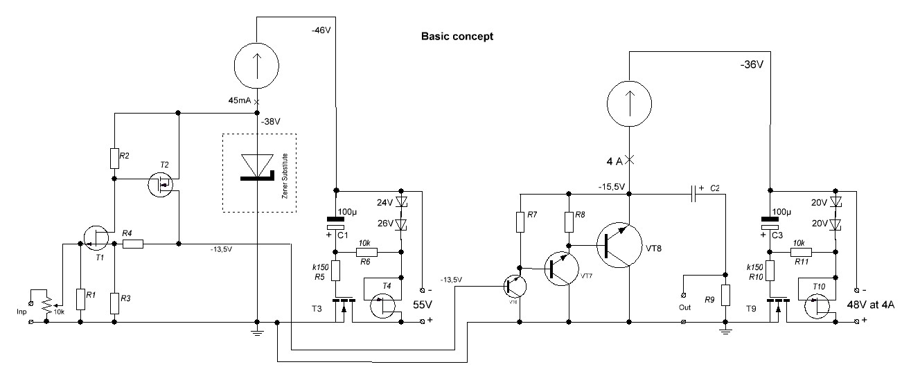

Hi Vladimirk,
I took another look at your design to learn a bit more. I’m not sure if I understand it all but here’s a few comments that if wrong, you must correct or it means I didn’t understand it !
The input is a JFET-MOSFET pair in a topology similar to Sziklai-with-gain, it contains a localized feedback loop which improves linearity, lowers output impedance and can provide plenty of current. The JFET input device has enough gate-drain capacitance to prevent oscillations around this local feedback loop. A very nice input stage, off to a good start !
You have a fully regulated power supply for the front end that starts with a series regulator (T4 is a current source for the zener diode string which holds gate of the T3 source follower at a clean reference voltage) followed by a shunt regulator (current source and zener structure). The shunt regulator provides a return path for a.c. currents that flow through the input stage. I call this approach the ‘electronic capacitor’ because it replaces the usual need for a power-rail capacitor. To say this is better than a capacitor is to say that the ‘zener structure’ is better than a capacitor. Is this really the case ?
The output stage is triple-Darlington loaded on a current source. There is a series regulated power supply. The output stage is capacitively coupled through the speaker to ground. The current source load removes any signal from the power rails. The output capacitor is directly in the signal path and must flow high current with low impedance - it needs to be large.
You chose -Ve rail single supply, you want to have the output signal currents circulate back to the gnd and you want to use NPN transistors. If you used more traditional +ve single rail you would have to use PNP. You could eliminate the output capacitor with a bridged design (or a large shunt regulator), but it would be even less power efficient.
Question: an alternative approach is to allow the output signal current to flow through the power rail, meaning you have both an output capacitor and a power rail capacitor. The power rail can still be regulated to make it clean and to isolate it from the power supply. Then you would be free to modulate the current source in sympathy with the signal. This is the approach that I see taken by Nelson in the Aleph, and by Wavebourn in his Tower and perhaps you might say the JLH 1969. I believe the reason is that a modulated current source load for the output responds better to real-world loads. Did you try this approach in comparison ?

Bigun, thaks a lot for your consideration of this schematics, and I confirm that you have mentioned the main specific solutions used. I'll try to do my best in providing reasons for them, during the next day. Of course, there are some reasons, based mainly on my personal experience. I am really grateful for your friendly concern.Hi Vladimirk,
Let's go step by step. About this specific question:
Previously I believed that the shunt power supply is a pretty stupid decision, because it waste energy and creates design difficulties with heat dissipation . Quality series voltage regulators seemed to be providing all the necessities. This view changed after experimenting with a simple common source amplification stage. Kp903 fet was used at the input, and above it – high-voltage SIT transistor kp926 as a cascode. Another kp926 with gate-source resistor was used as a dynamic load. Supply voltage was provided by 140V series stab, rather high voltage in order to improve linearity at typical output voltages 1 ... 10 volts. This solution resembles the tube stage, but with " solid state tubes “ - SIT transistors. I expected to get a detailed, “emotional”, sound, a sample of which I have from a good SE 300B tube amp. At the same time, the ability to evaluate sound was provided due to high quality of other system components (PMC EB1i speakers, Stereovox 600 silver speaker cables, Analysis Plus Silver Oval-In RCA interconnects, Shanling CD-T1500 player with matched pairs of nos Philips E88CC SQ tubes). I mention this, because the sound expertise based on ordinary Mid-Fi system is almost impossible, the listener often can not distinguish the effect of the changes undertaken.

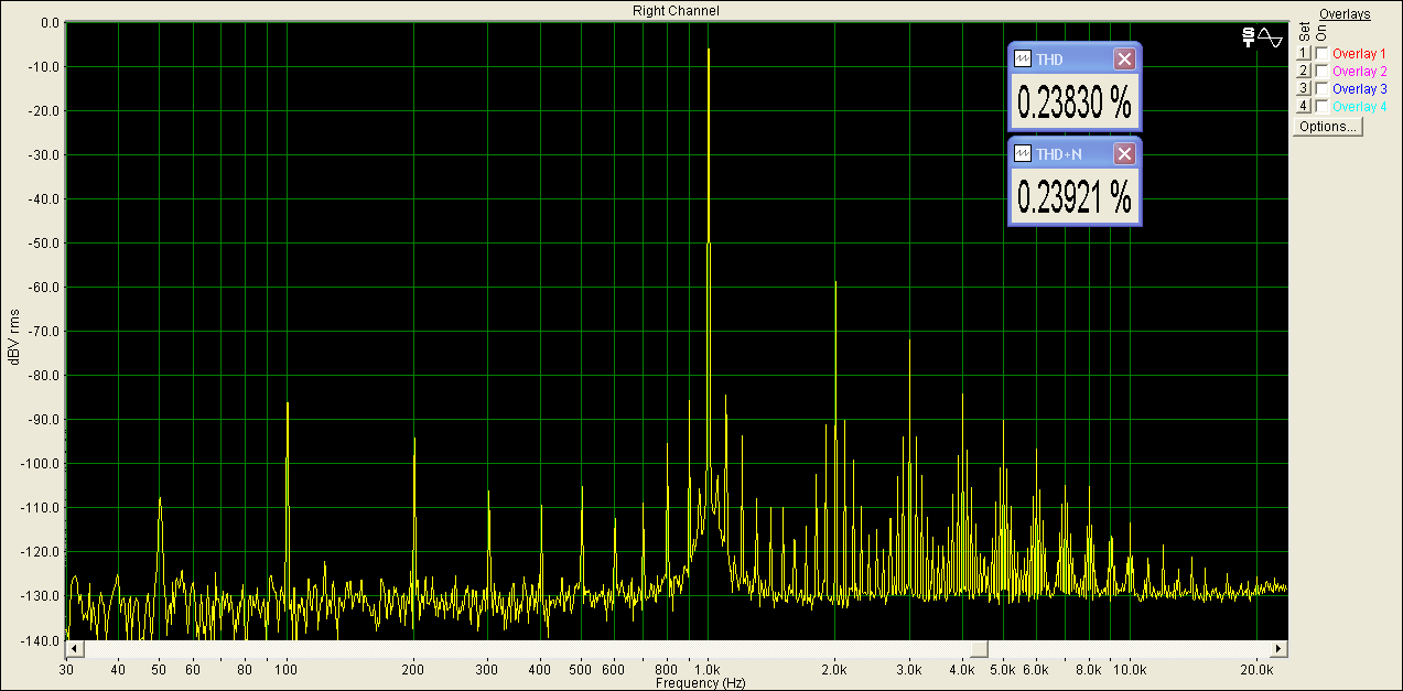

The first result of the evaluation of SS preamp was a disappointment. Its inclusion in the system immediately made sound muddy, emotional component was lost, a typical Mid-Fi sound. The implication was that transistors – are transistors, and tubes – are tubes, and the results of their use can not be similar.
Then the modification was made, polypropylene 80uF cap was used instead the electrolytic capacitor on the power supply rail. Character of the sound has improved substantially, but not to the level of a good tube device. Adding polypropylene 1 ... 15 uF shunts, also as RC with small R in series, gave changes at small nuances.
An idea of the next step came out from a desire to imitate the type of the tube amp power supply - choke input LC filter. The question was, what is the effect of the input choke, only decreasing 100Hz ripples of the rectified voltage, or something else. One can reduce the ripples easier and less costly – by RCRC filters. If power supply consists of the rectifier diode bridge, RCRC filter and series voltage regulator, then during the “open state” period of the rectifier diodes, the output signal current is circled, partially via PS caps, and partly through the secondary winding of the transformer, which can be affected by the high-frequency components of non-ideal mains voltage. In the case of the input choke, "dirt" from the power supply can not penetrate. Hence came the idea of using a shunt voltage regulator, in addition to existing series stab. Shunt power supply comprises a current source with high dynamic resistance, and a reg transistor connected in parallel to load. Current source decouples the diode bridge rectifier and power transformer. The result of the implementation of this idea was the "merger" of the SS world with the tube world, in the sense of the sound characteristics.
One of the conclusions from result - PS capacitors alone can not exclude the participation of power supply components in the signal currents, the power supply is to be separated from the main circuit by the choke or by current source. The second variant is preferable for me, because one can reduce the physical dimensions of the device in which the signal currents are localized. It is important for the suppression of electromagnetic interactions, harmful for micro-level signal components. Moreover, typical "SS PS chokes" of mH range are much less efficient than "a lot of Henry tube PS chokes".
By describing this example, I do not pretend to state, that similar good sound result is impossible with ordinary series-reg approach, but the last needs incomparably more investigations and assembling tricks, that will be valid for the specific design only.
