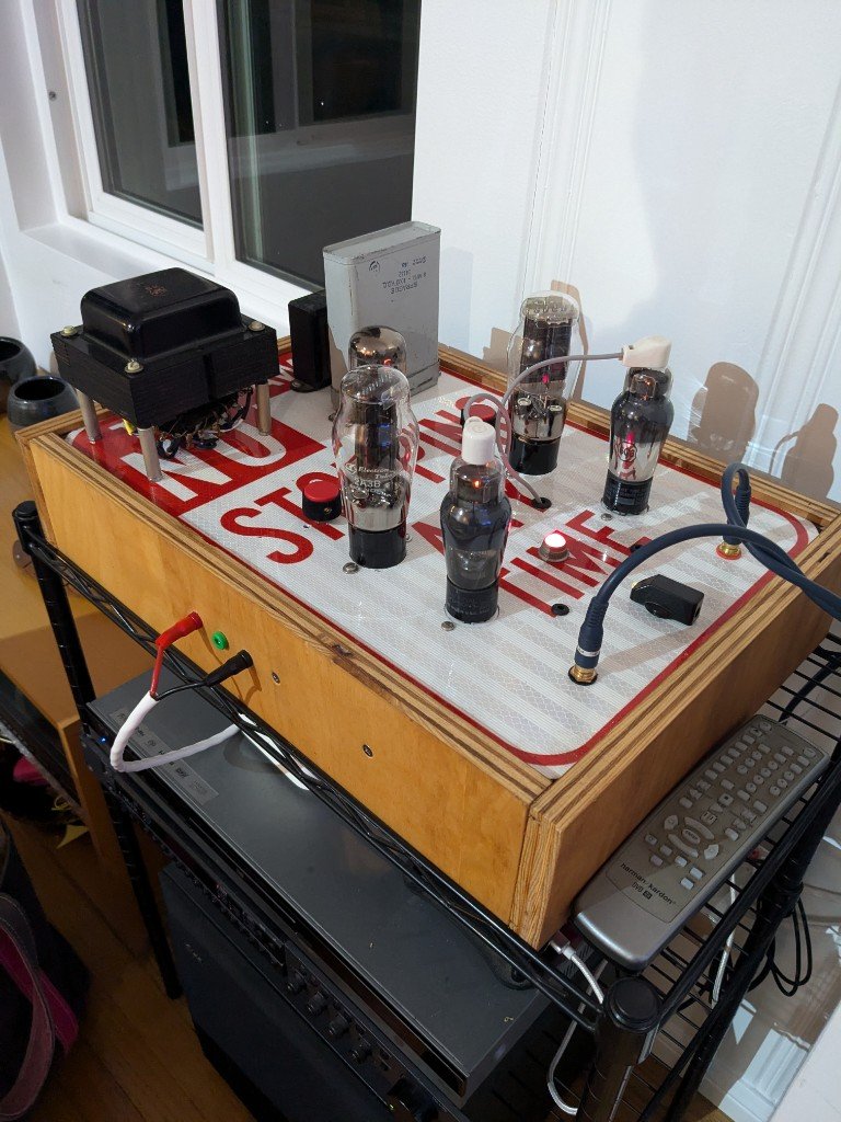

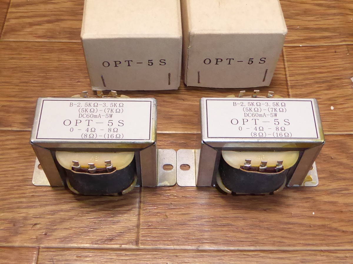

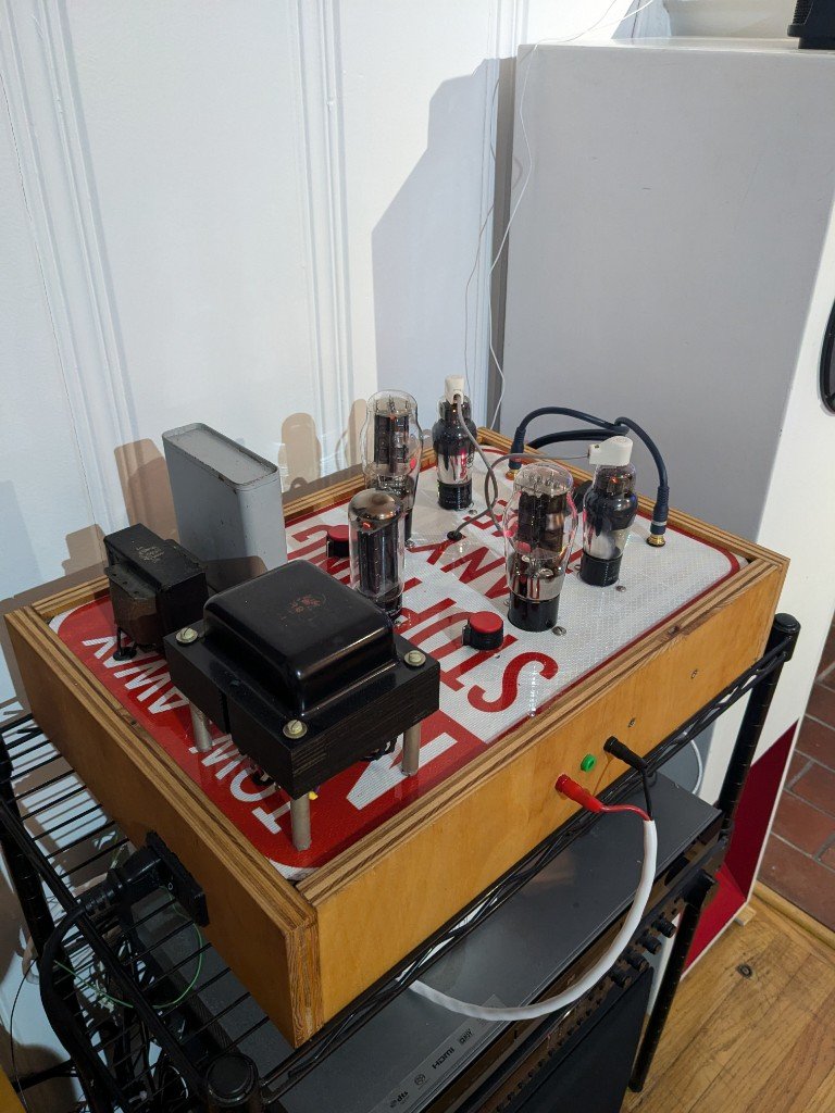

It has been some time since I built this amp. Burned it in in my garage and it is now in my living room. I mostly stuck to the original design, but I did drop the value of the screen resistor. The bottom line??? This is an astonishingly good amp. In fact, the best I have ever built. It is extraordinarily musical. Even my wife likes it. Actually she likes it a lot, so WAF for the large layout I chose is not a problem. The surprising part is that it is getting better as it ages in. I am using early Shuguang 2A3 tubes bought a long time ago in Hong Kong whilst I look around to others to try and nos 6C6s. The transformers at are Japanese OPT-5S 3.5k. I have attached a couple of pics.
Reactions: mrpunkk
How good that looks!
Do you have any measurements of how the amplifier behaves?
voltages, Zout and thd etc??
maybe also some video of what it sounds like? I know it doesn't say much, but I like to see them play.
I have all the components to make it my winter project, when I finish it I will upload some photos too.
What type of speakers are you making it work with?
Thank you very much for all the information!
mrpunkk: I haven't made any measurements, maybe later in the year. I have thd measurement equipment so I will report back, but now I am simply enjoying it. The amp is in my living room driving a pair of half Chili Chang transmission line cabinets with GRS8 drivers and Linaeum tweeters. Earlier I had it driving a pair of B&C 12CXTs in small bass reflex cabinets. That also sounded great, but they live in my garage now being driven by a 2E22 se amp I also built. I strongly urge you to do this project, I am very happy with mine. (I like very simple things!)

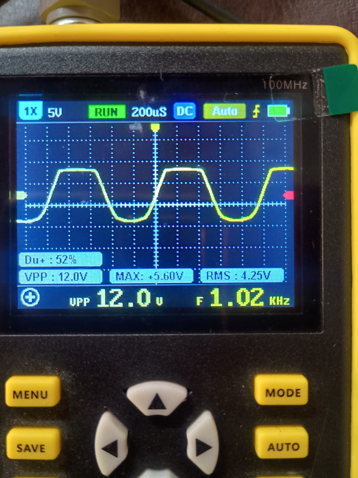

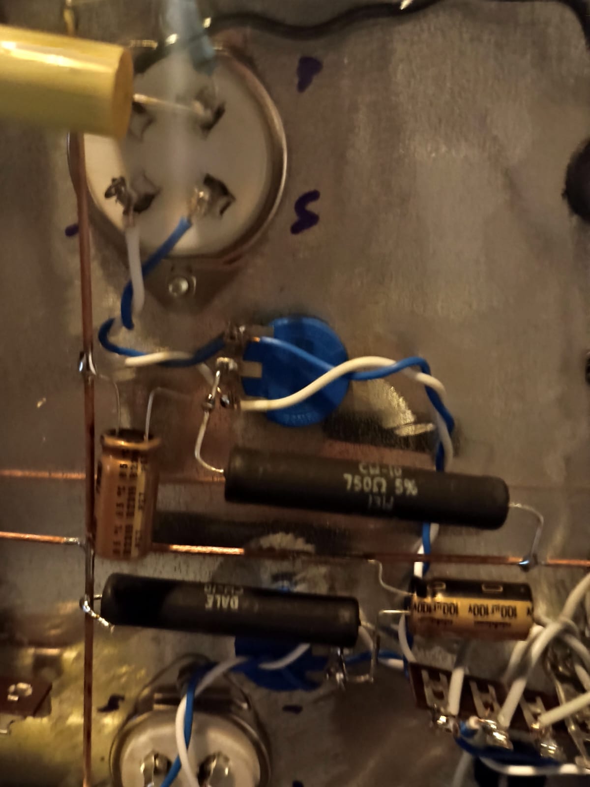

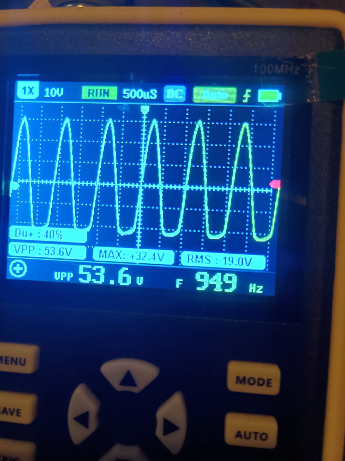

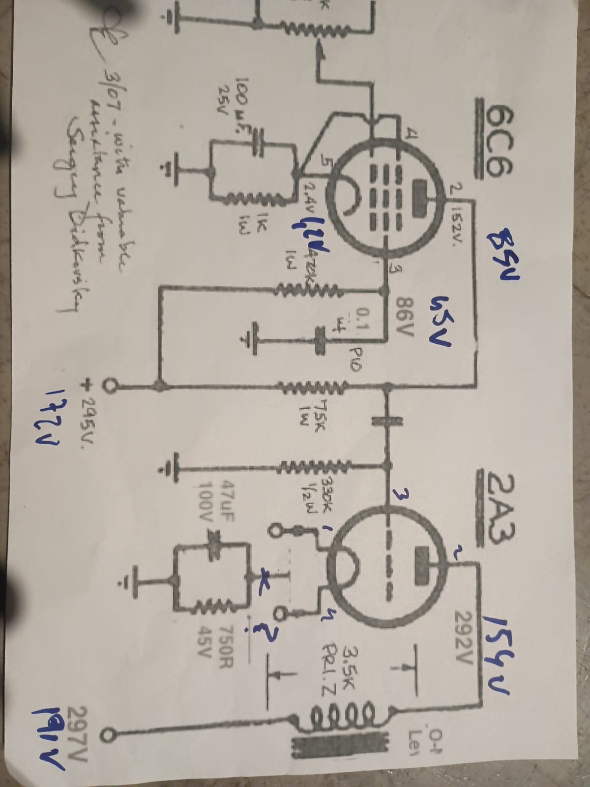

Hey, I finally finished building my 2A3 Radiotron, but I have a few questions.
1. Regarding voltage, the voltage reaching the tubes is roughly as indicated, but with the tubes installed, it drops to 100V on the 2A3 and half that on the 6C6. Maybe it's the power consumption, I don't know. The 2:1 ratio on the 6C6 remains the same. The 2.4V on the cathode of the 6C6 is at 1.2V.
2. The 45V on the cathode/filament of the 2A3 is 1.2V, not 45V, attached photo
3.and with signal, 1v 1khz, it gives me 19v rms, it is a correct value for the 2A3/6c6, attached photo
4. Should I leave the negative (speakers) of the output transformers isolated from the ground of the general circuit?
I didn't make any SE amplifier with 2a3 but I purchased a pair of 6S4S and I designed with these tubes a galvanically coupled amplifier in which I noticed that the best sound was when the limitation of the two alternations is symmetrical. Initially I tried a few static operating points and changed Zp until this symmetry resulted before clipping
Keep in mind I'm certainly no tube amp troubleshooting expert, just applying some circuit network analysis to the voltages you showed and taking a guess.
You have a lot of voltage drop, especially a lot of voltage drop across the output transformer, which makes me think your 2A3 is drawing way more current than it should be. Since the voltage across the 750 ohm cathode resistor is only ~1.2 volts, it looks like that current is going somewhere other than through your cathode resistor, hence my suspicion of a short to ground in the filament circuit somewhere.
If the voltage measurements you posted are correct, there's something seriously wrong with the amplifier, as Charles G notes. The cause of the enormous voltage loss needs to be addressed before you do anything else. It cerainly seems like the cathode circuit on the 2A3 is shorted to ground. What power supply are you using?
