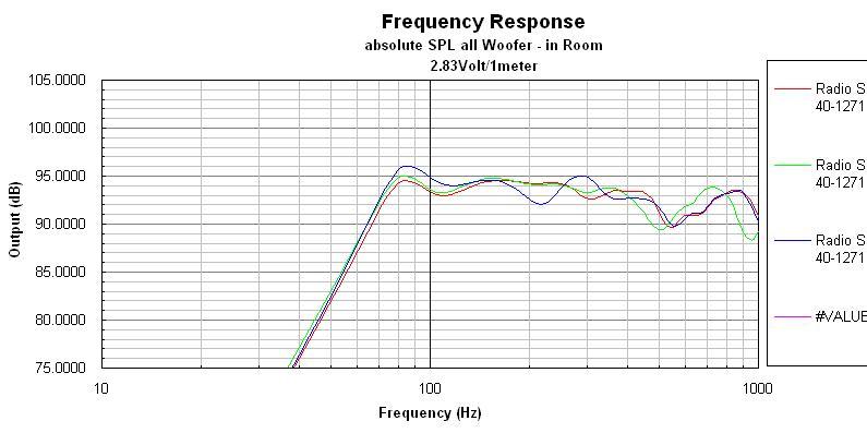

I have read through all the archives that mention the 40-1271 driver. There have been several trials posted in there that have included various baffles sizes: 16X36", 24X39", 13X25", 31X35" and the tapered design noted by GM in this threed. In addition there was a 1ft^3 closed box and a 1.5ft^3 vented box design!
Most importantly, I found a message by Thorsten with instuctions on how to properly use his spreadsheet. Using his spreadsheet, I have settled on the following:
RED GREEN BLUE
Driver Resonant Frequency (Fs - Hz): 82.93 82.93 82.93
Driver Electrical Q (Qes): 3.30 3.30 3.30
Driver Mechanical Q (Qms): 9.45 9.45 9.45
Driver Equiv Volume (Vas - liter): 32.84 32.84 32.84
Thermal Power Limit (P - VA): ???? ???? ????
DC Resistance (Re - Ohm): 7.92 7.92 7.92
Pk-to-Pk Excursion (Xmax - mm): ???? ???? ????
Effective Cone Dia. (D - mm): ???? ???? ????
Baffle Hight (mm) 1050 1200 914
Baffle Width (mm) 250 300 400
Hight above floor (mm) 900 900 700
Dist. rear Wall (mm) 100 125 100
Dist. side Wall (mm) 300 300 300
RED GREEN BLUE
I am leaning towards the RED baffle dimensions. Does anyone have any suggestions on how to improve this reponse, or this about as good as I can get using a rectangular baffle?

GM said:
Did you sim my tapered design? Using a 1/3 octave RTA, their in-room response was considerably smoother than any of these.
No. I do not think that the Thorsten spreadsheet can simulate a tapered baffle. Also, I do not have the knowledge or tools to do the simulation manually or otherwise. I don't even know what a 1/3 octave RTA is!
Since I will not be using these is a common room, I am now open to the tapered idea (since it seems like the best sounding). However, I would like to see some simulation of the response.
On the bright side, I have a 33-2050 SPL meter now! I'm going to see if I can get a FR of this driver.
I appreciate all you help to date.

So is there no way to model the response of a tappered open baffle? How much better is the tappered design compared to the baffles I posted?
Would building the baffles that I have modelled be a waste or will the sound be ok?
GM.
