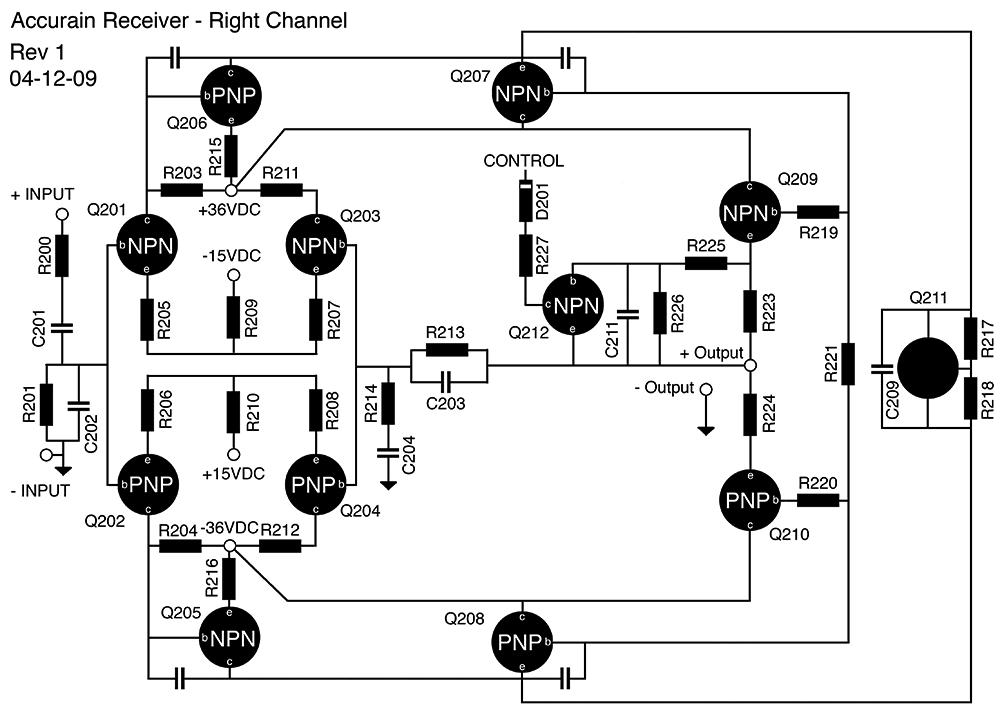

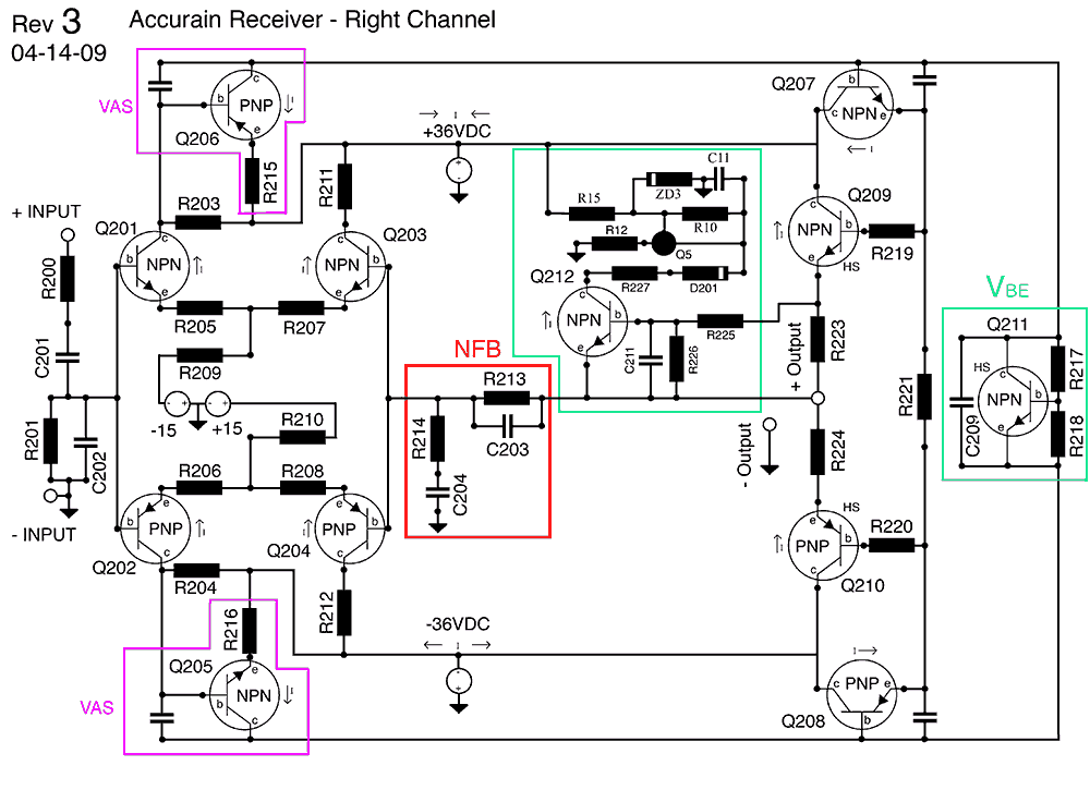

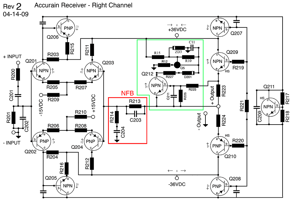

Some comments on the design. I measured no bias voltage across
R123, R124, R223, R224!!!!!
Here is the schematic for the right channel. Still working but should be close;
also an updated parts list
Accurian Amplifier
All Resistors are gold = 5%
All Resistors are 1/8W unless otherwise stated
Main Audio Board

Chris.... do you have the original Radio Shack schematic
This one seems strange to me.
Can you send me the original one?... this one you have posted was not made into the standard way...so it is confused to my old brain.... old fellow wants to see negative input in other side... VBE multiplier into the middle...drivers at output transistor left side...those things...input left..output rigth side..positive up and negative down..nothing under negative or upper positive and nothing after the output connector.

Thank you for the great input!
I drew it from looking at the circuit board--there is no original that I have. My
goal was no crossing circuits. . . I will post the picture of the circuit. . .sorry about
the unconventional layout.

I will have to email the PCB - 2MB with fine detail. . .
Very good drawing for sim.
My parts list has the correct parts. . . what about the extra transistors (Q207/208)
are they some sort of buffer?
Re: Thank you by your efforts.
Looks like the base and emitter of the driver are reversed. Swap them, then it looks more normal.
Pete B.
destroyer X said:
Another friend has made the schematic watching yours.
It seems it is fine.
I will simulate it to observe how it operates.
regards,
Carlos
Pete B.
