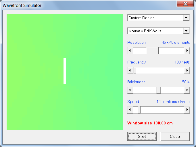

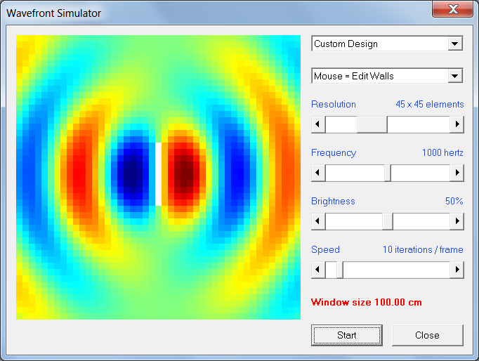

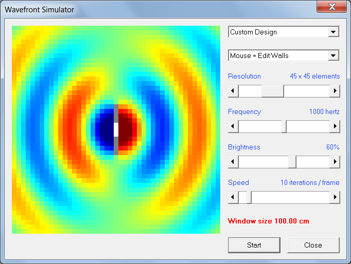

The way sound radiates is very dependent on how large the sound source is vs. how large the wavelength is of the sound. Even with a very large driver like an 18" woofer, a 50hz wave is 6.8m and therefore much larger. The sound then radiates omnidirectionaly from the cone and the front and rear cancel each other to a very significant degree.
As illustrated in Attachment 1 (frequency = 100Hz).
At 1500hz, however, the wavelength is .23m. The 18" woofer's diameter is now twice the wavelength of the sound. The wave now propagates much more forward and backward and much less to the sides. Since the front and rear are interacting much less now, you get far less cancellation.
As illustrated in Attachment 2 (frequency = 1000Hz).

Hi Ron, if i am not wrong the interference notches in the frequency response of loudspeaker in free air is due to dipole effect and in baffle radiating in 2 pi steridian the interference notches in the frequency response is due to baffle effect and the room?
I am not sure I understand the question. A 3" loudspeaker on a 12" diameter baffle will have similar "doublet" cancellation dips as a 12" driver without a baffle...

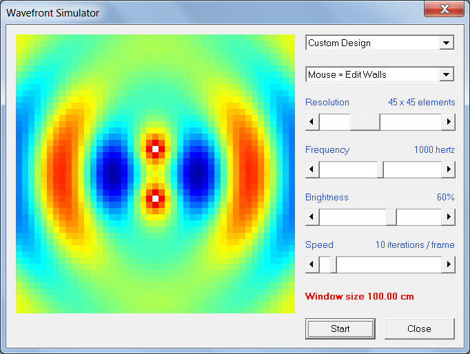

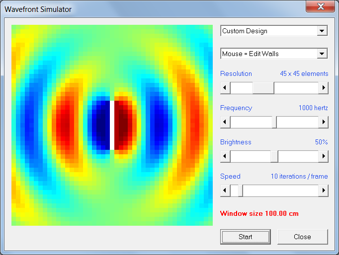

Hi David i just installed HornResp it looks very clever software, I was playing with the wavefront simulator, how do i add more monopole source with mouse click?
Hi shank1207,
To add a point source without deleting an existing one, Shift+Alt+Click the mouse twice at the same location.
Attachment 1 shows the relevant section of the Help file.
Attachment 2 shows two monopole sources - with the same polarity.
Attachment 3 shows two monopole sources - one with reversed polarity.
Note that it is also possible to create phased arrays using multiple time-delayed sources.
Kind regards,
David
