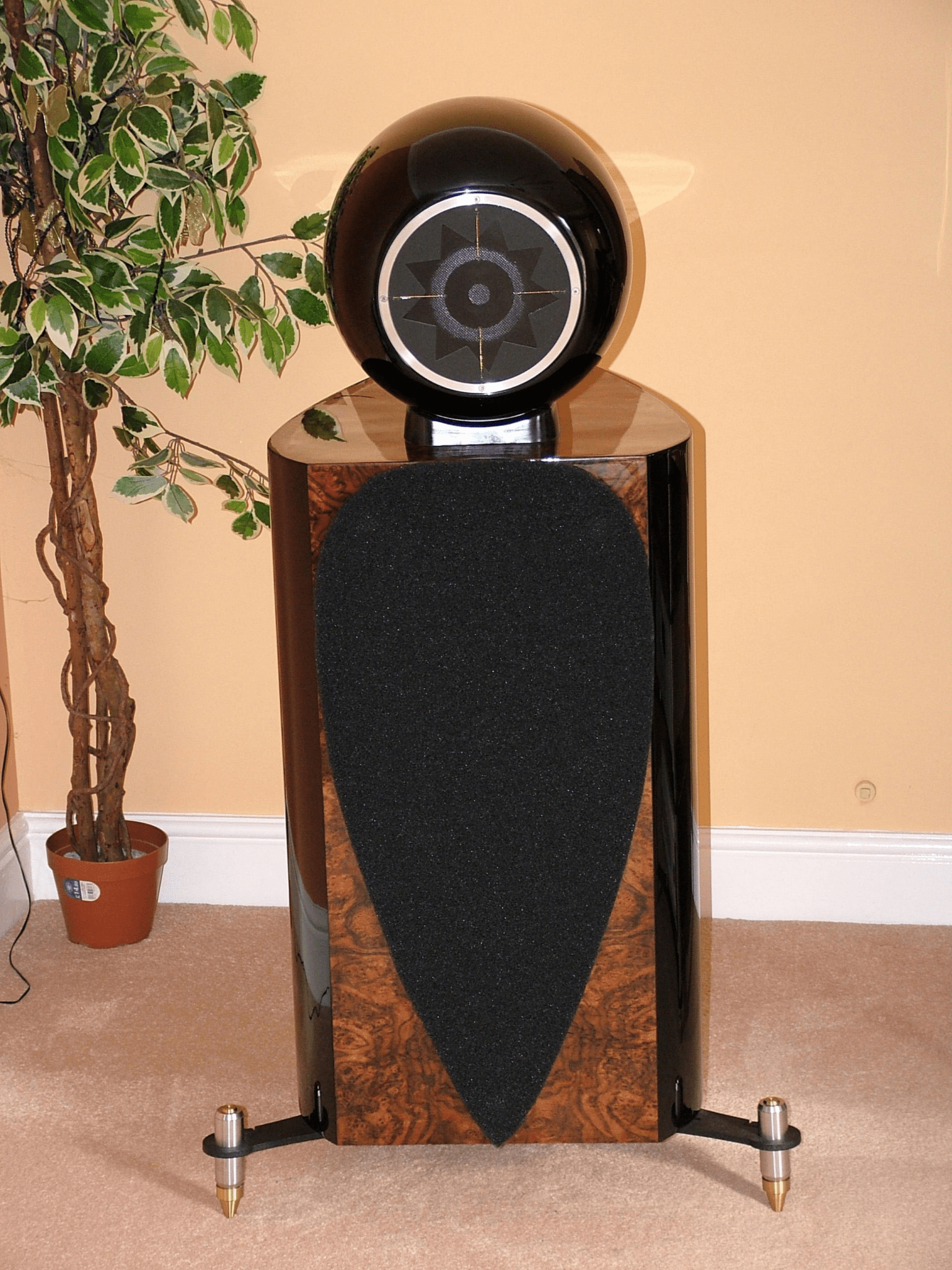

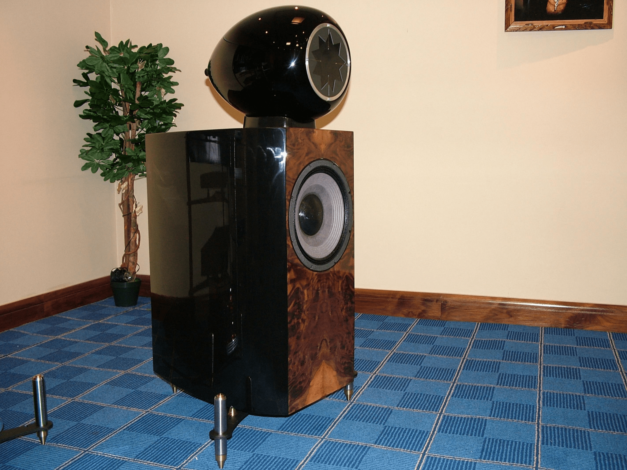

Is there a Radian planar that can be used from around 350Hz up to replace a Manger driver...? I would like to clone this speaker, Overkill Audio Encore but use a planar instead of the Manger. https://www.diyaudio.com/community/threads/system-pictures-description.23208/page-115
Grill off:
Grill on:
Grill off:
Grill on:
No, there isn't. The Manger can do that because it has a significant xmax (travel distance). You will be able to see it popping back and forwards with loud snare drums etc..

Yes sorry my late night reply was a bit of mixed thinking. This is true. A large planar like LM10 or Neo10 won't work as a replacement to the Manger due to excessive HF beaming (and geneal HF off-axis irregularities). In general, most planars that can act as a tweeter will be limited on the low end. Even the 10" ones won't like 350hz you'll need more like 500hz.The trouble you'll run into is HF beaming
I have played with foam cheeks on a Neo10 and Neo8. There is just no way it will do without a tweeter. You need to loose so much output at the top end by foam absorption that you end up with an unusuable amount of treble, even for DSP.
I've also owned Manger drivers. If they were £100- £150 each Id recommend them. Sadly they are far more expensive, I checked my emails just now and I sold the pair used for £536 in 2007. God know what they cost today?
I never got them to perform in a way I was truly happy with. They were dynamic and had a smooth response but after a longer time with them I could not dismiss the lack of 'inner detail' that you get with really low distortion speakers (such as good planars!).

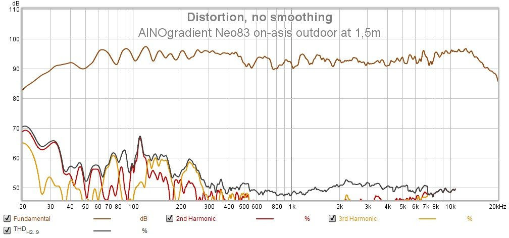

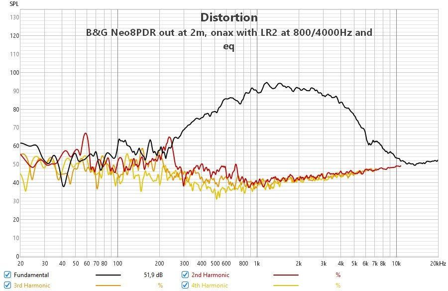

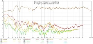

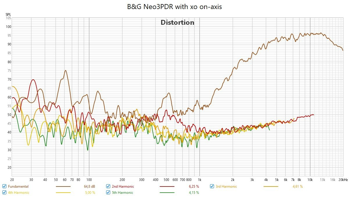

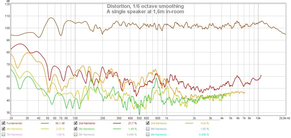

I've stressed my B&G Neo 8 and Neo3 open back sometimes, but I don't use club-like spl. Below outdoor measurements individually and as system, dipole, mic distance was 1.2 - 1.5m I don't remember. Neo8 gets rapidly stressed below 600Hz but for nearfield use it might go gown to 300Hz well
indoor at 1.6m
