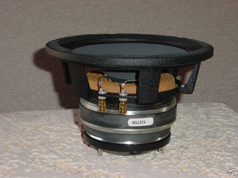

Specs for the Radian 5208C coaxial:
Fs - 73.3
QMS- 12.6
VAS- .54 cu ft 15.29118 liter
Cms- .03828276 in / lb
MMS - 0.744197 ounces 21.1 grams
RMS - 1.738285 lbd / sec
Xmax - 0.039 inches .9906 mm
SD - 34.39999 sq. in 221.935 sq cm
QTS - .45
Sens - 93 db
QES - 0.46
RE - 6.5 ohm
LE = 0.75
Imp - 8 ohm
BL - 11.69
A 17.06 liter box tuned to 62.8 cycles with a 4" diam port 1.62" long will give you an F3 of 64.9 cycles.

These 8" coax's look that they donät give "enough" bass without sub/bass? Can anyone compare 8" coax against tradition 2-way with 6,5" midbass?
If looking true fullrange, I think one must look for 12" coax with lower Fs?
