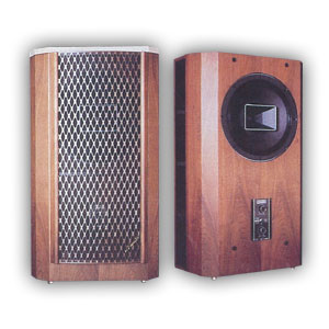

The first Coax speaker was invented by Altec Lansing in 1941.
http://alteclansingunofficial.nlenet.net/Duplex.html
If you want some original Altec Duplex Great Plains Audio makes them under model 604-8HII.
http://www.greatplainsaudio.com/downloads/604_8H_II.pdf
Bill Hanuschak worked for the Altec Lansing Corporation of Oklahoma City, Oklahoma from 1980 until Electro-Voice shut them down in 1998. During his years there, He was a loudspeaker production engineer, an acoustic design technician, and finally ended up as the only remaining in-house acoustic product engineer for the once-great professional audio company known as Altec Lansing.
So these are not clones ,they are originals.
Hardly. There were plenty of coaxes before the Altec Duplexes came onto the scene. One that I would very much like to hear someday is the German Eckmiller O15, which is a prewar design.
Wrong:
Two-Way Coaxial Speaker O15 (System Eckmiller) manufactured in 1943 by Konski & Krüger, Berlin N4
Check your refences before you make satements.
:clown:
