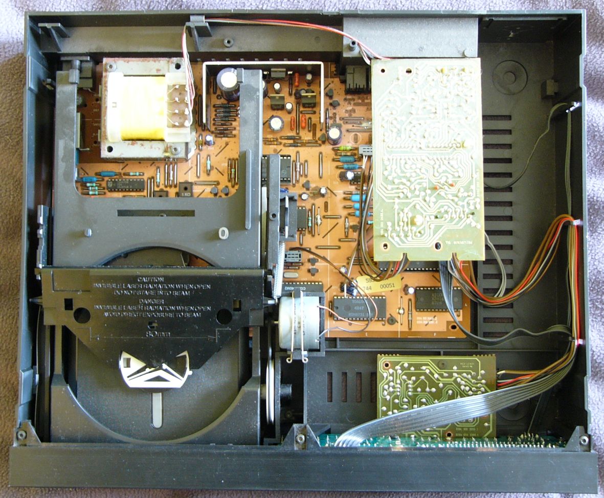

I think on this machine there is a separate PCB mounted below loader mechanism. If there is such a pcb, it contains the laser PSU and the cap you are after.

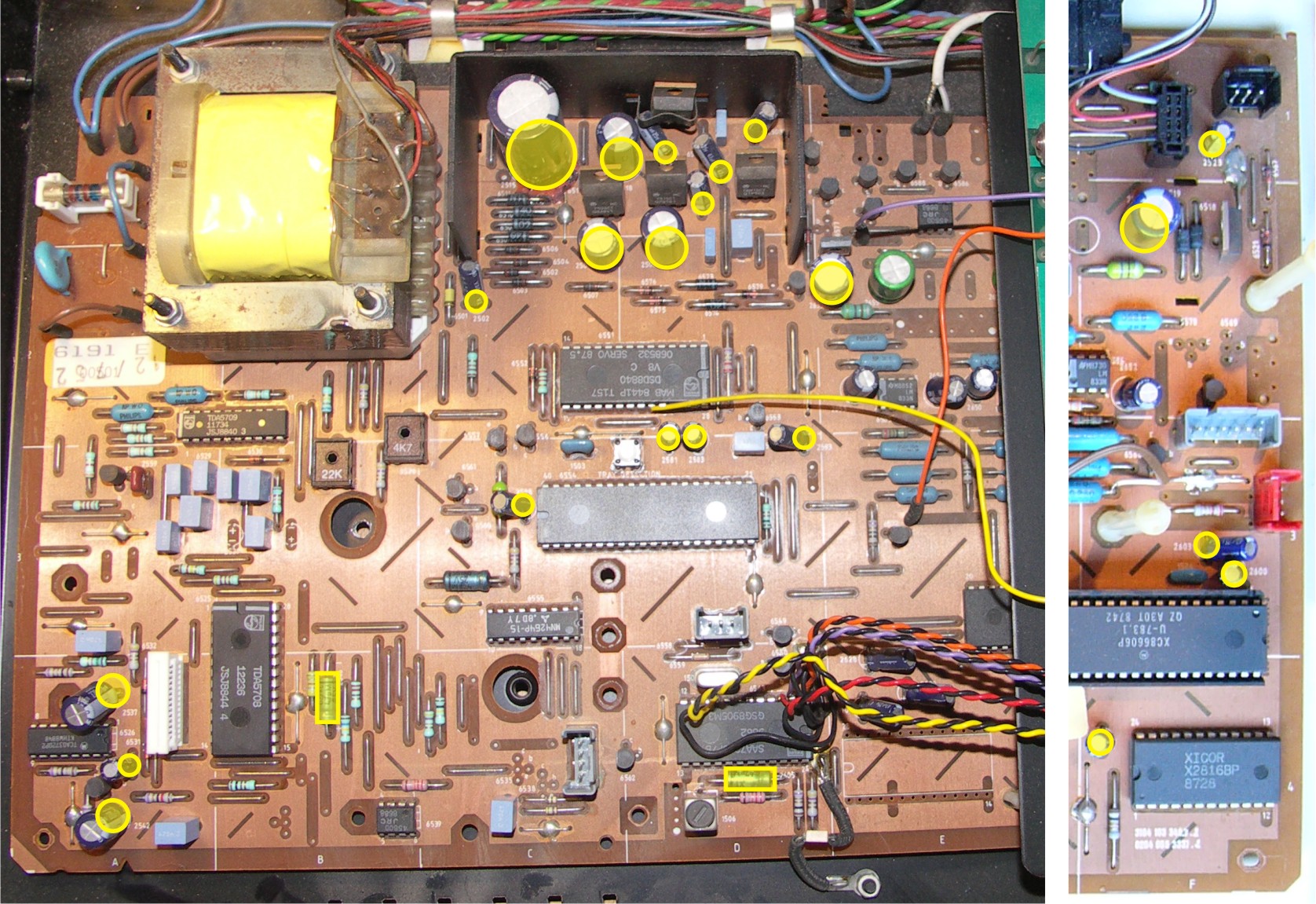

That's a really nice player, what a shame that it is not working so well. The first thing I would do is replace most of the electrolytic capacitors on the mainboard (the brown PCB), and probably all of the ones on the DAC board as well. These components are well out of date, as this player is probably 20 years old now. Doing that will most likely fix all of the problems you are having with the player.

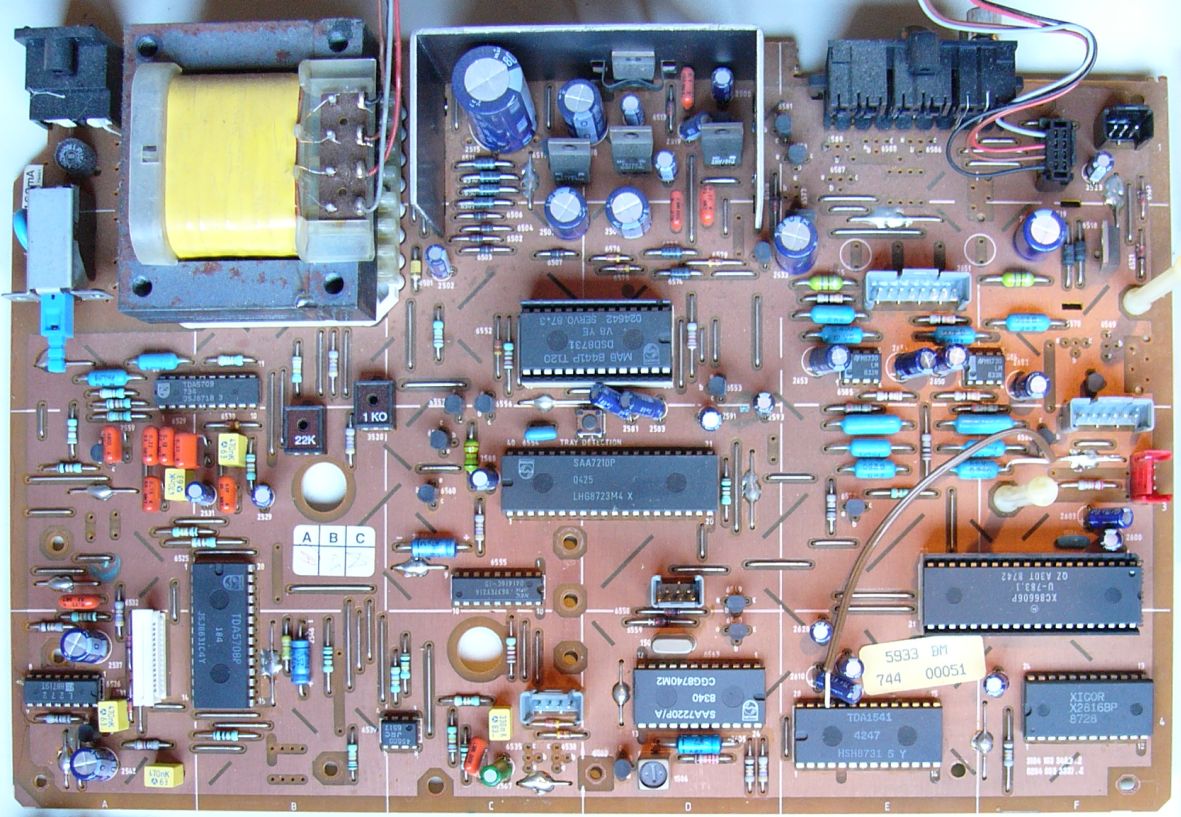

I recently worked on a CAL Tempest 2, which uses the same Philips made mainboard as your Raford, and similarly used an add on DAC board. Because of this add-on DAC board, you won't need to replace all of the electrolytic capacitors on the mainboard. If you'd like, post a high res photo of the whole mainboard (you will have to remove the overlapping green PCB), and I can mark out which capacitors you should and should not replace.
I have posted a picture below of an unmodified version of this mainboard and one of the Philips players that used it, the CD782.

Okay, here's the picture, the capacitors that should be replaced are highlighted yellow. The smaller picture at the right covers the part of the mainboard obscured by the DAC board.
You could also replace the electrolytic capacitors on the DAC board, but you don't need a diagram for that. They are the two black and three blue large cylinders towards the front of the player.

Did you replace the capacitors I suggested?
I gonna try to do that tg«his weekend.
