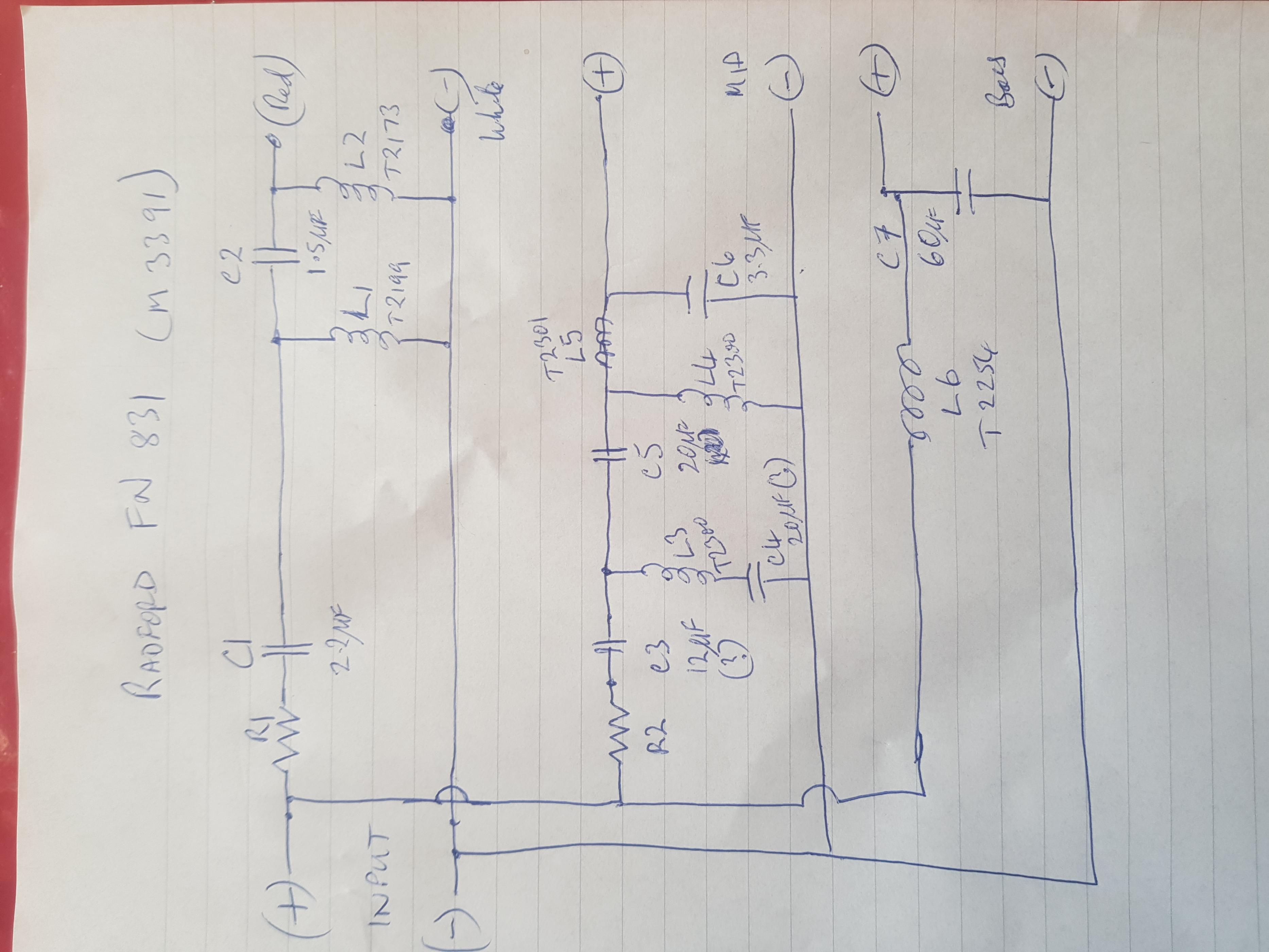

Having purchased a pair of Radford M180/50 speakers I find the crossovers have been modified (caps replaced) but there is an error in one crossover. Can anyone tell me the value of C3 and C4 on CROSSOVER FN831 M3391. The issue is that I cannot say for certain which is the correct capacitor value, one board is correct. If anyone can help I would be most grateful.

missing photos
I will try again to upload as the photos were rejected.

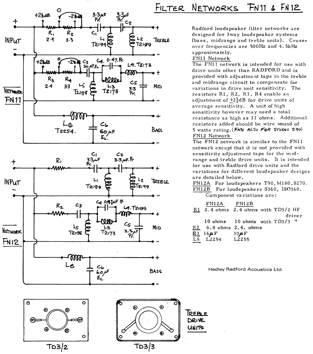

https://www.t-linespeakers.org/classics/radford.html
The S0- was the loudspeaker that really got me going. One of my gurus was building them in Calgary.
The above link has official Radford schema for FN11 & FN12.
Given the quality of bits available i figure that they could be gratly improved by substituting a good FR (Alpair 5.3/7ms/P7HD) as a sub for the mid & tweeter (Goodmans* + Peerless) and biamp, the 10” Goodmans bass driver is well matched to the line. Still haven’t gotten my hands on a set of S90 yet to try it on.

I am guessing that FN stands for Falcon Network, so if the info already provided doesn't answer your question you could reach out to Falcon loudspeakers in the UK. Although the drawing provided does seem to have the info you need for C3 and C4 values.
