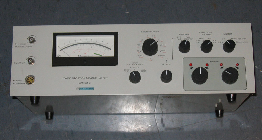

I badly want a distortion analyzer and I found this thing a while ago. It is still collecting a lot of dust in a pawn shop and I think I should buy it, even just for heck of it. I looks to be mint condition and I could get for $50.
It is a Radford LDMS2-2 and the meter indicates distortion meaurment to 0.03% full scale. I think it would be a suitable piece of kit for a beginner like me? Made in the UK by, I believe, the same Radford folks that built amplifiers? Did they even sell these things or was it for Radford use internally I wonder?
It runs off two 9 volt batteries! I could change that easily? I guess it was portable but I don't know why.
Does anyone have a manual for it?

Radford only ever made high end equipment pick it up its a bargain !

Thanks Trev, the Radford looks great but if it doesn't work I'll need a schematic...perhaps there is one inside?

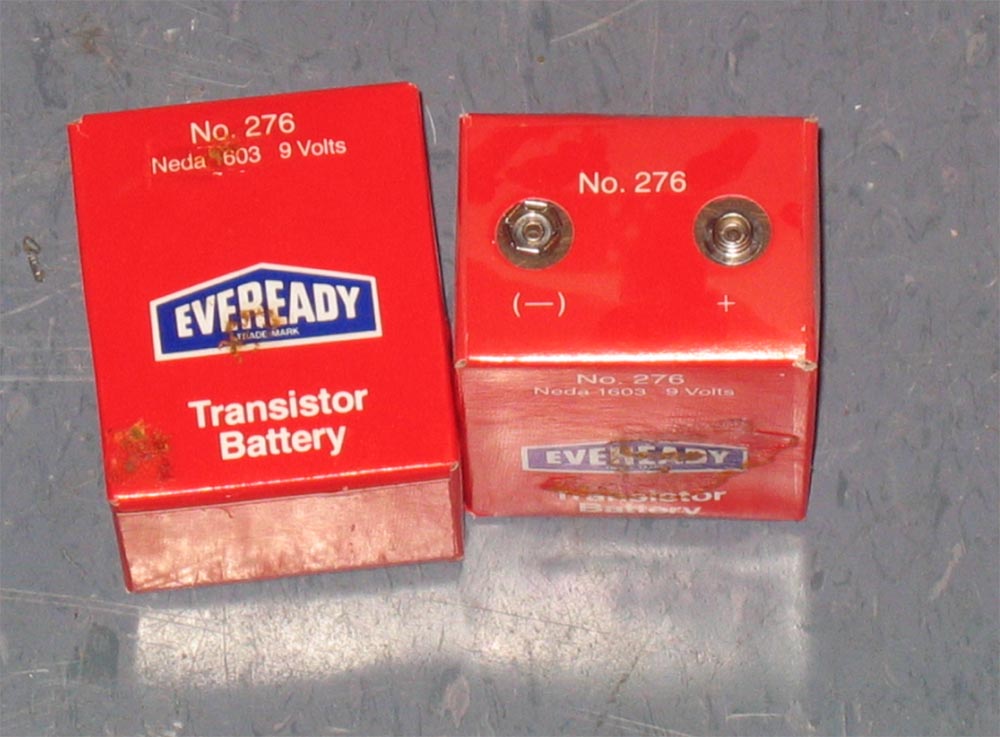

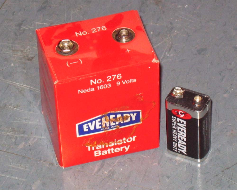

Radford Batteries ...
LINK:
http://www.lowcostbatteries.com/product_p/evr276.htm
Battery Data - These 276 are pretty hefty, so those small ones might last very long ! Good enough for a "dead or alive" test though !
Good Luck !!!
LINK:
Good Luck !!!
Re: Radford Batteries ...
Interesting link as I did not think such a cell was available anymore. If it works well, I'll build a power supply for certain.
Thanks,
Shawn.
torroid88 said:Good enough for a "dead or alive" test though !
Good Luck !!!
Thanks,
Shawn.
Those cells are PP9 over here(uk) and are still available !

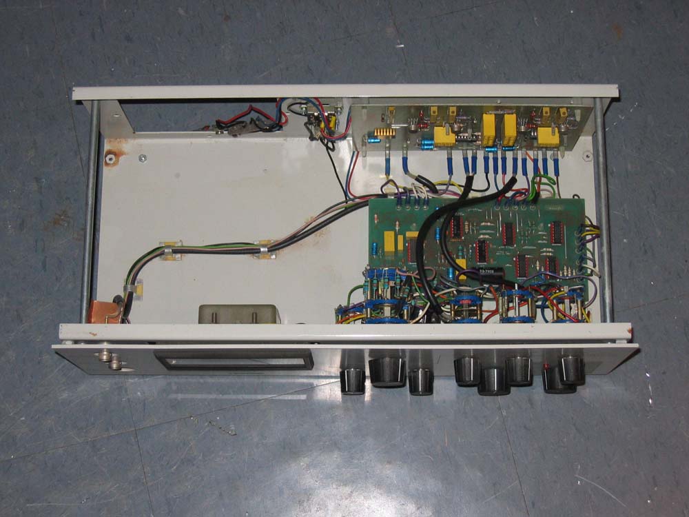

Nice to look inside the radford typical build quality for them !
I have a zd22 preamp and a large [power amp of theirs and the build style is very similar.
regards Trev
regards Trev

I have some equipment that uses a bunch of #246 9V batteries, a bit smaller than your behemoths. Curious, I carefully opened the bottom of the box to see what was inside. Amazingly, there was a little circuit board with the exposed terminals on top, a couple perfectly standard 9V batteries plugged into terminals on the bottom, and a wood spacer to take up the rest of the space! You probably won't be as lucky, but I can now just plug new 9V batteries into mine, which is about 10X cheaper than buying new #246 batteries. I didn't know one could parallel batteries, but if the voltages are matched, it obviously works. Might be a way to run your unit, as it would probably exhaust the normal size batteries very quickly.
