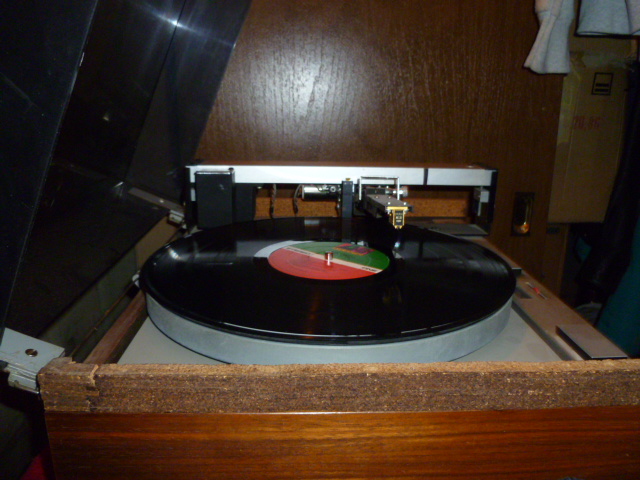

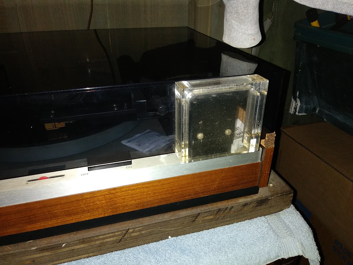

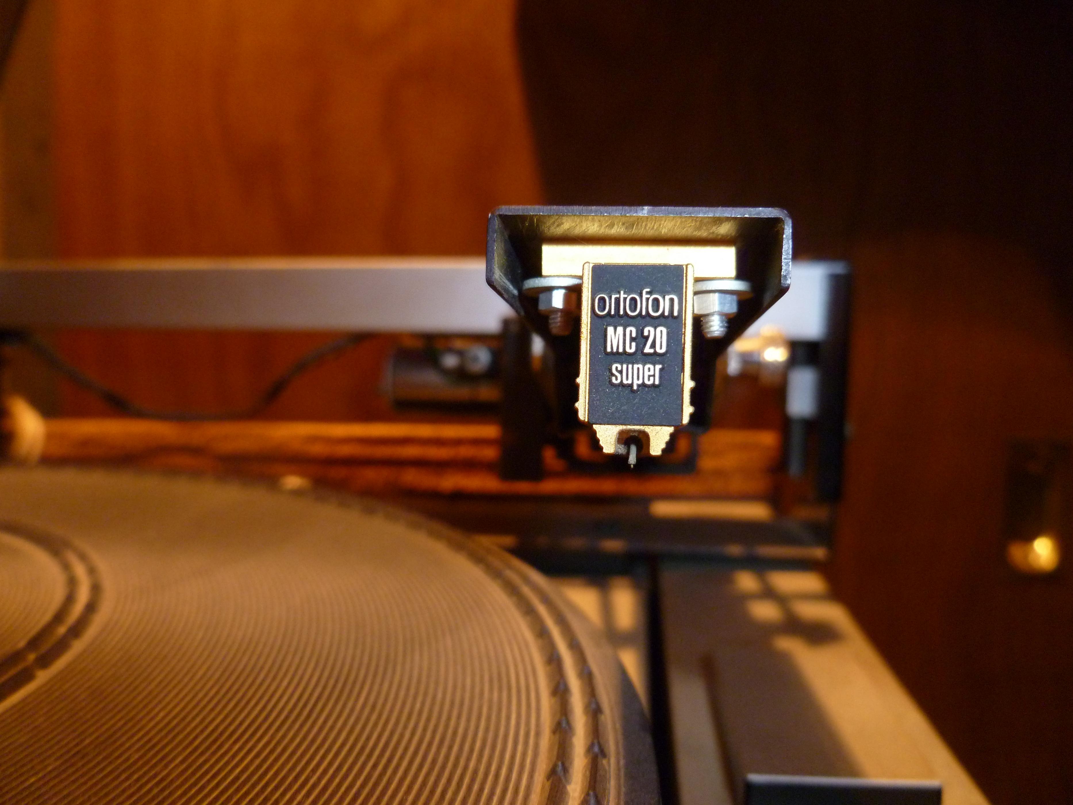

I got my Rabco SL8-E + Thorens TD 125 MK II in the early 70s. The table came with a blank tone arm board. The dealer could install, but I chose DIY :).
The dust cover was raised on cork sides, and a bay window was added for clearance .
