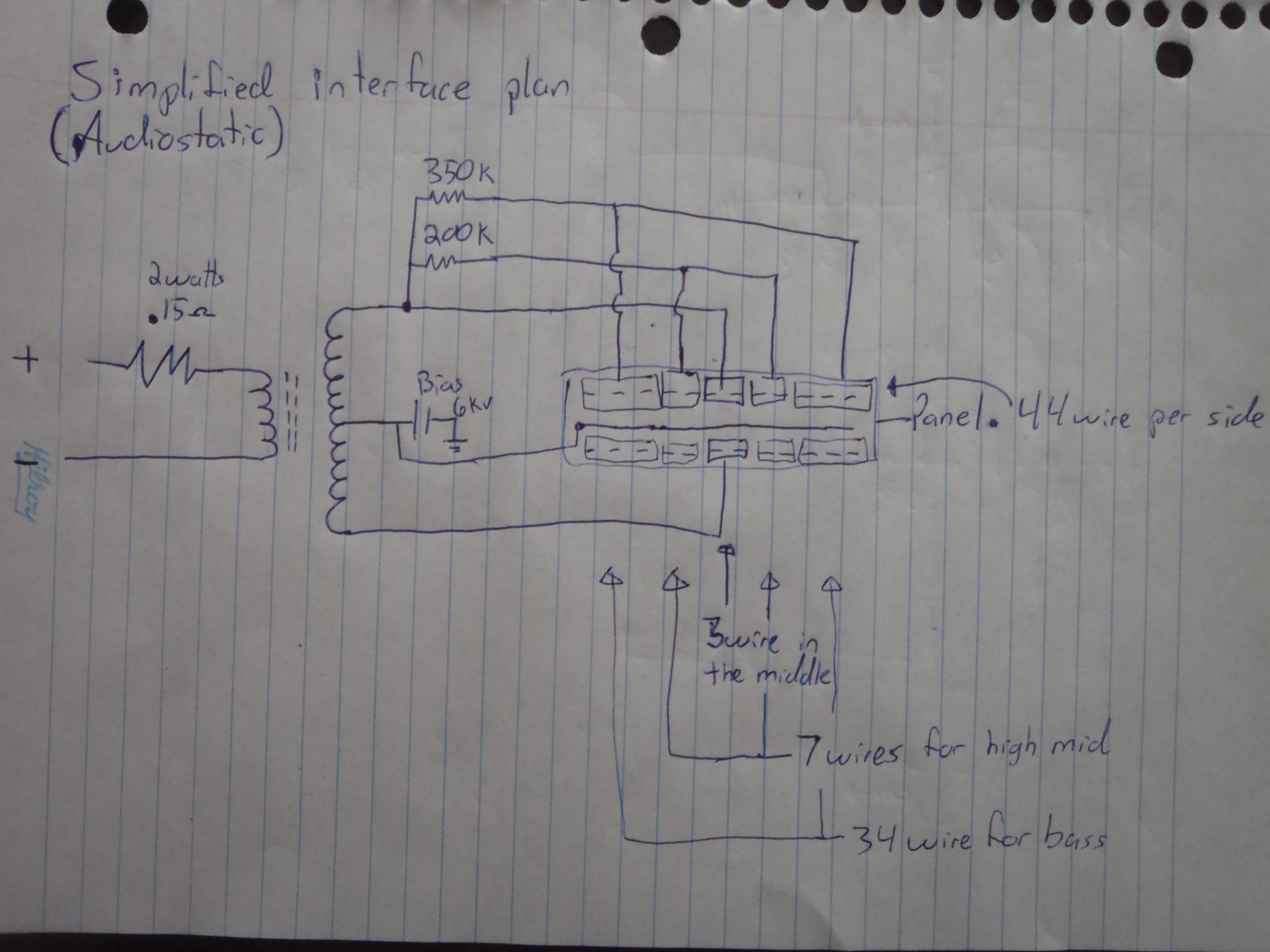

Could you describe or provide a schematic for your ESL including segmentation resistances?
In a previous thread you were discussing modifying an Audiostatic.
http://www.diyaudio.com/forums/planars-exotics/210053-calling-esl-expert.html#post2970687
Perhaps there will be a way to adjust your ESL to avoid the need for adding a tweeter.
In all of the ES-100 loudspeaker pairs I have worked on there was a 5 ohm resistor in series with the primary.
Reducing this resistance to 2 ohm raised up the drooping top end.
HEre a simplified schematic of the interface
I used a 0.15ohm primary side resistor.
stock was 1.8ohm.
Sound is much clearer with the low value one.
HF extension improved a bit. though not much.
With the shown value, I do a very flat 160 to 17k.
I could go as low as 38 with differents value but the overal frequency response wasn't very flat. Moreover, dynamic compression was limiting my max spl.
I high pass the esl at 150 and there, 2 12inch servo subs takes over.
Shown picture is giving me most accurate sound.

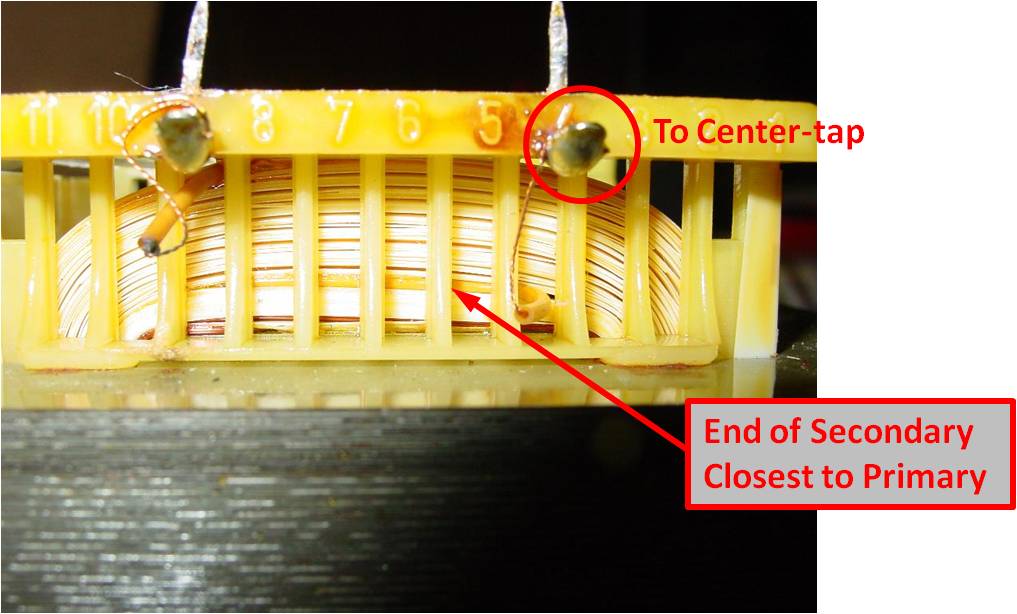

Calculated capacitive load at 20Khz for your parallel driven 3-segment is a little higher than the stock 2-segment arrangement, but probably not enough to account for the bandwidth reduction you describe.
Hmmmm...Are you using the ES-100 transformers still mounted on their PCboard?
If not, is it possible that you have the wrong ends of the secondary connected for the center-tap? To minimize capacitive load on the secondary, it is important to connect the center tap to the ends of the secondary that are closest to the primary. See attached pic.
This may be of interest...ticknpop added some ribbons to his Martin Logan CLX.
http://www.diyaudio.com/forums/planars-exotics/181041-my-2-nd-esl-attempt-9.html#post2528859

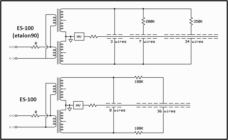

Factory, my ESL had 4 wires for the hf (4 in front and 4 in back)
I reduced it to 3.
the remainer was 40 wires for the bass and mid all together (40front, 40 back)
I went from 2 to 3 sections with few trial and error to my optimum wich is 3,7,34.
Factory had I think 12K going to the hf and 160K on the bass. (Need confirmation, it is only from memory)
I went to zero on the hf and tried quite of combinaison for the other 2 segregated parts to archive best tonal balance.
My transformer are still on the pcb board and I can't see the side.
I may upgrade them to plitron but does not know if it is worth it.
I went ahead and ordered a pair of RAAL 70-10.
Should have them next week.
Can't wait to play with them and find how sound will become.
bolserst, do you use 3rd or 4rd order for your ribbon?
Martin
Factory, my ESL had 4 wires for the hf (4 in front and 4 in back). The remainder was 40 wires for the bass and mid all together (40front, 40 back)
See attachment for comparison between factory and your arrangement.
The ES-100s I've worked on were segmented 4-40 as you stated with 376K total on the larger 40 wire section. I have seen other documented values for this resistance so it may have been changed by the manufacturer over time. There was no resistance going to the center 4 wires. The resistor "R" on the primary was 4 or 5 ohms.
I have not used ribbons with my ESLs. The link I posted was for some ribbons that another DIYaudio member, ticknpop, added to his ESLs. You might send him a PM and see if he can fill you in on exactly how he integrated the ribbon.

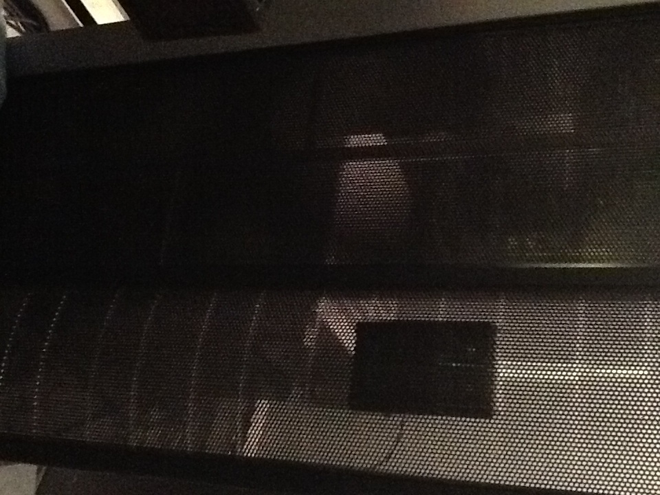

Joined 2005
I have Raven R2 hi pass filtered at about 12db/7 kHz with Martin Logan CLX
( they hang on fishing line half way down and behind the CLX mid /tweeter panel - works well). You want to try high passing into the ribbons from 5 or 7 kHz and trying different frequencies upwards and playing adjusting the level of the ribbon to find what what works best for you. I've thought of trying Raals (maybe this year), let us know how they sound. I agree with Studiotech you are crossing over too high. I've found that a very good ribbon adds top end detail that the electrostatic can't match. I have had over the years the Panasonic and Sequerra ribbons with Dayton Wrights, Deccas with Accoustats and Quad 63's , and Raven R1 with Martin Logan Requests. Mark Levinson crossed into the Deccas at 7 kHz in the HQD system, Dayton Wright at 3 to 5 kHz. Your steep slopes surprise me and the phase comments, at 17khz a wavelength is less than an inch and the ear isn't phase sensitive that high up it's in the midrange that the wavelengths and the size of your head come into play, at low frequencies it's time arrival that determines source, in the mid end phase , and at the top end your less sensitive. Plus a 24 db per octave crossover will have lots of phase shift even if it's in phase at the crossover frequency all the other frequencies will be phase shifted ( unless it's a Bessel high pass filter)
