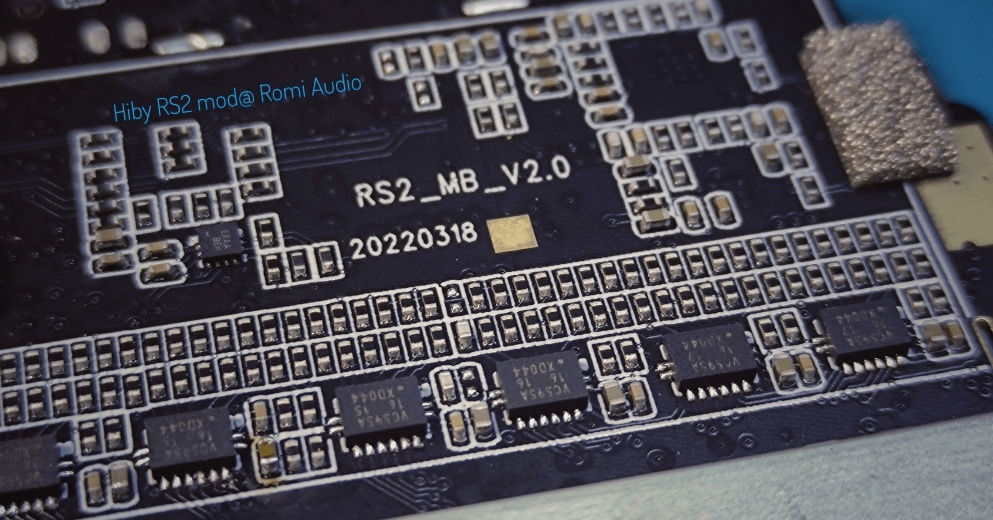

Back to the slow sound I noted about discrete R2R ... well, that speed of light thing may be part of the problem -- R's too far spaced. I have HiBy dap with a micro R2R pcb inside. This device sounds quick and punchy, not at all like Denafrips.
