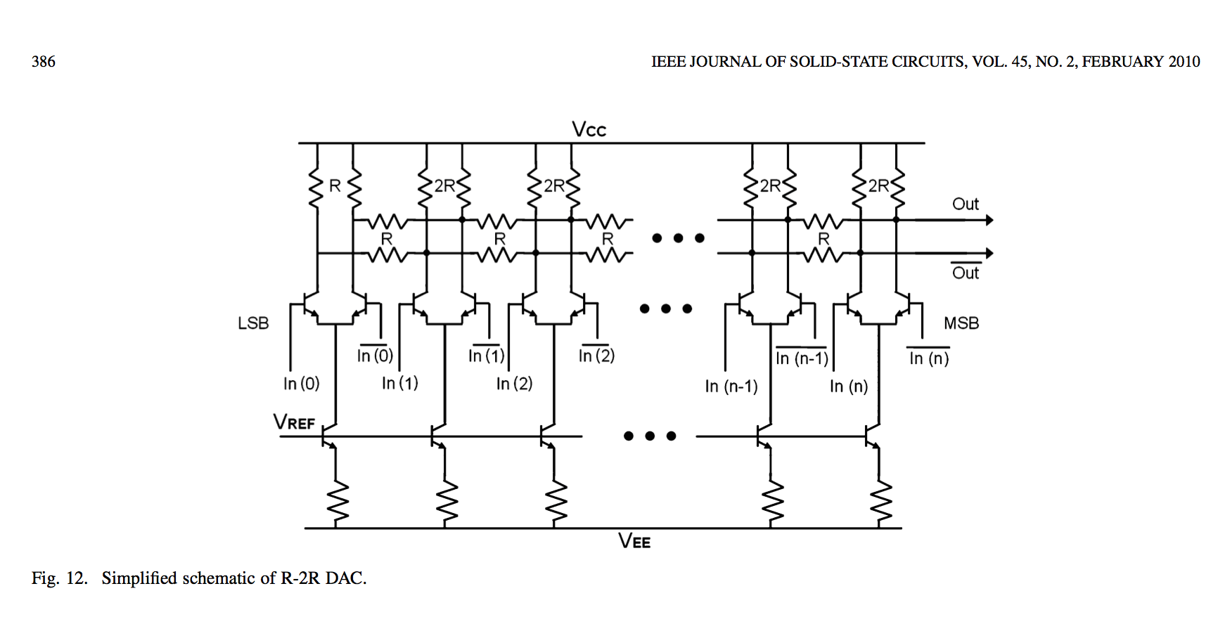

The schematic you showed had BJT switches. They have the same issue as the MOSFET switches: You need to make sure that the resistance of the switches is consistent across the signal swing. Ideally, they should have zero resistance but until we get superconductors that work at room temperature that won't be possible. To avoid distortion you at the very least need switches that show no dependency on the signal voltage.
The DAC I designed used MOSFET switches (transmission gates so an NMOS and a PMOS in parallel with their gates driven 180º out of phase). It was basically a resistor ladder from VCC (or Vref) to GND and the DAC code turned on the transmission gate switch at the appropriate tap. If all the transmission gates were the same size, the ones near the ends of the resistor ladder would have different resistance than those in the middle of the ladder. In the T-gates closer to VCC the NMOS would practically be off and the PMOS would be fully on when the T-gate was supposed to be on. And vice versa for the T-gates closer to GND. Near the middle of the resistor ladder there's much lower gate voltage available (-> lower overdrive voltage), so the MOSFETs aren't as fully on. All this contributes to nonlinearity.
A few ohm variation in switch resistance would severely limit the linearity in an R2R DAC with, say, 1k resistors. A few ohm on 1 kΩ doesn't even break ±0.1%.
With BJT switches I'd think you'd be limited by the Early voltage once you push the precision far enough.

Hi Tom thanks for good inputs.The schematic you showed had BJT switches. They have the same issue as the MOSFET switches: You need to make sure that the resistance of the switches is consistent across the signal swing. Ideally, they should have zero resistance but until we get superconductors that work at room temperature that won't be possible. To avoid distortion you at the very least need switches that show no dependency on the signal voltage.
Tom
Yes the mismatch simply cant be avoided because all of the the devises are not in the same die and from the same base...
You probably designed a IC with direct implementation of the paerts in the same DIE?
I am considering something like this for BJTs

Yep. The DAC/ADC I designed is part of the LMK04800 timing IC. The components on an IC aren't perfectly matched, but they're a lot closer matched than discrete components. That's why ICs use circuit architectures, such as R2R, where the absolute accuracy doesn't matter much but the matching does.Yes the mismatch simply cant be avoided because all of the the devises are not in the same die and from the same base...
Tom
