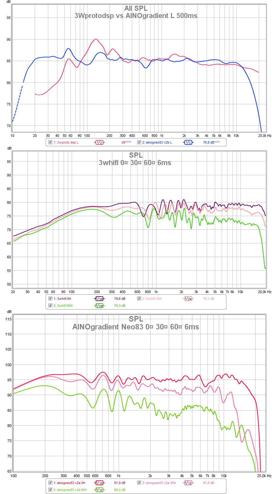

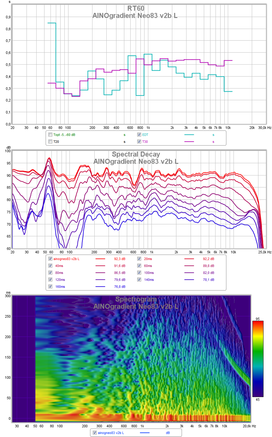

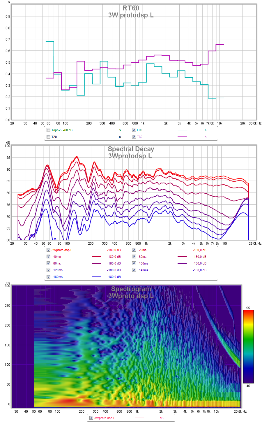

This is far out from the topic, but the discussion is very interesting to me. Here I show sets of measurements in my living room. Speakers in same location, baffle 80cm to front wall, 2m to side wall, 30¤ rotated, on-axis to mic which is in stereo hot spot 2,3m away. Speakers are along the long wall.
3Whifi proto dsp is 3-way monopole
AINOgradient is mono to 80Hz, cardioid transition 80-250Hz and dipole 250Hz up
We notice great differencies in edt and high frequency decays, and between 80-200Hz.
Sorry I have not listened to 3W in stereo, but several monopole 2-ways in this room. The dipole sounds the same around the room, acoustic music is very natural, but stereo imaging is more vague, bass is very solid. I like dipoles more than monos here, but an imaging-freak might disagree. I am sure, that if dipoles were given more space to front wall, imaging would be better, because of bigger D/R and shorter EDT.

Juhazi said:I am sure, that if dipoles were given more space to front wall, imaging would be better, ...
@Juhazi
80cm distance to front wall is way too short, when using a dipole ...
Diffusers will be of great advantage, if you don't already use some, regardless if you can increase the distance to the front wall in your current setup.
The decay of the cardioid is at least more "balanced" and noteably faster from upper bass on upwards, when compared to the monopole, if i am interpreting your graphs right.
This is why i prefer directional speakers (dipoles, cardioids) even from mid-bass to midrange. I feel that your resultes given by the decay measurements are quite typical, for "good" setups of more directional speakers.
Kind Regards

- a 500 ms window is a bit large.
- only woofer response up to ~200Hz is shown. In my case,
But even he says "Dipole woofer is not so sensitive for a single back wall reflection, but otherwise response variations are bigger". They are indeed large in the area 100-200Hz
For a dipole against a wall there will be at least a large dip at wavelength = 2d and a peak at 4d (where d is distance to wall). As you get closer to the wall, the dip is getting larger and higher in frequency - and more audible.
For d = 80cm, the dip is at 210 Hz, above the modal region and is clearly audible. It must be equalized. For d= 120cm, the dip goes down to 140 Hz and likely much less noticeable. Going even closer than 80 cm will put you in even bigger trouble.
Edit: there is one more thing: http://www.musicanddesign.com/Boundary_reflections.html
Thanks for the link to JK's page, I forgot that.
My speaker is a compound of monopole and dipole responses, which are not even concentric. This is why it behaves more like a dipole in it's "cardioid range" when near the wall.
