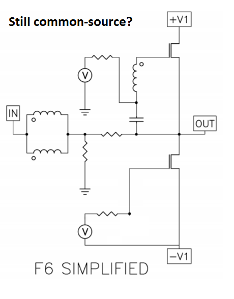

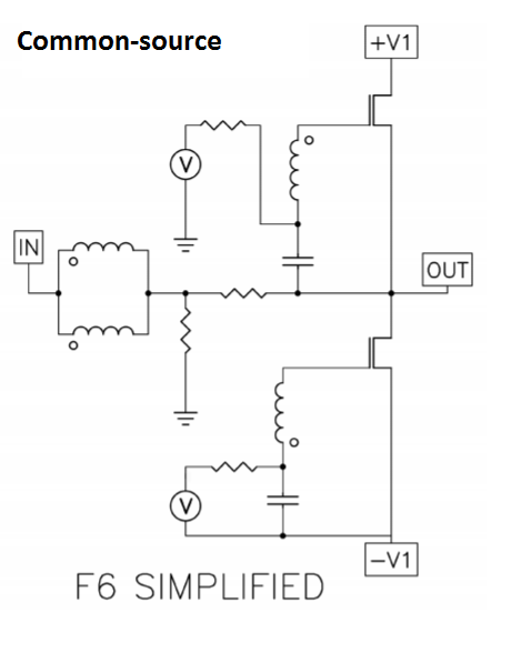

But if we take the F6 as an example:
If I've understood correctly in the F6 both the top and bottom N-channel FETs operate in common-source because of transformer magic.
So lets go further and lift the transformer secondary on the bottom FET and remove the capacitor. If I've understood correctly this makes the bottom FET operate as a pure CCS making it a single ended amplifier. The question, however, is if the top FET is still operating in common-source or if it has been converted into operating in common-drain?

It looks like it will work fine. You’re right... the way the signal is presented between the gate and source floats it above the output so it should act as a common source stage.
I Guess only one thing to do now ... is to try it !
