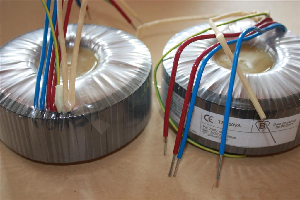

Thanks tinitus, I am already using toroids custom made for me by Mr Lachowski from toroidy.pl 😉
While I believe they will be hard to beat in powering a solid-state amplifier, I am not so sure about my CD player and DAC. Toroids have inherently (relatively) high inter-winding capacitance, and even with a shield between windings I suspect they may be letting in a bit too much mains noise for a digital component.

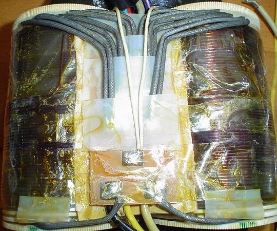

I think the Selectronic ones feature a shield.
That's what the yellow wire on the primary side is supposed to be.
That's actually well spotted... Now that I looked at the pdf again, it does say "Ecran" on one of the drawings...

of their transformers doesn't mention any shielding
They do have or at least used to have one interwinding shield. Pretty well build units IMHO, I liked them!
Hannes
