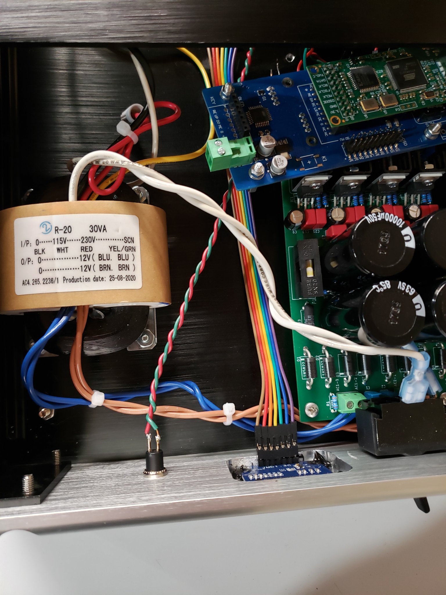

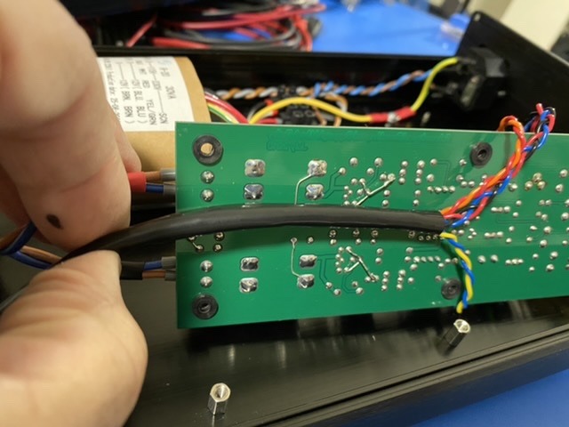

Is the secondary of this R core transformer in the picture wired correctly? The legend on the transformer indicates both blue are 12 volts and both brown are 12 volts. This is wired to an LDR attenuator. Or am I not reading that correctly?

The blue wires are the two ends of one winding, and the brown wires are the two ends of another winding.
I think that the two blues should be in one of the connectors, and the two browns should be in the other connector.
But it would help if you have the actual schematic of the equipment.
Agree with rayma. I actually have the same transformer. Your PS looks to be a half-wave rectifier, but I could be wrong. Mine is a full-wave, but you can see the two blue's going to one connector and the two browns going to the other.

Ok, checking again, the transformer windings are different than above. There is one secondary winding
with blue/brown leads, and also another secondary winding with blue/brown leads.
So you must use an ohm meter to pair the leads for each winding. Find two of the leads that measure a few ohms
(not open circuit), and that's one secondary winding. Then the other pair of leads is the other winding.
Then we have to determine how the windings are connected, which is a completely separate issue.

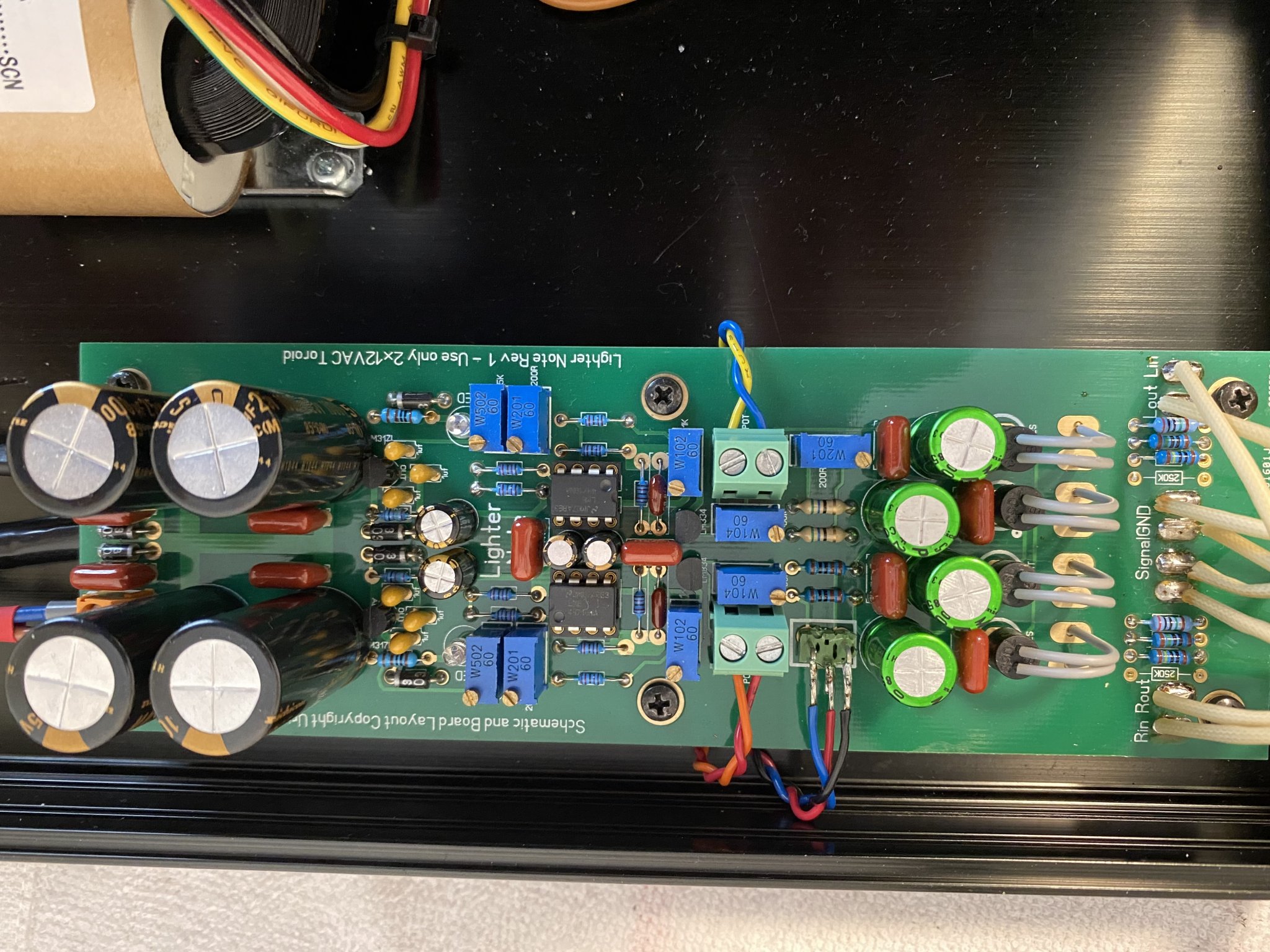

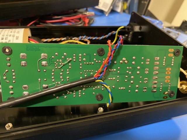

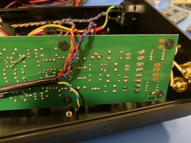

This power supply is different than the usual one, so take a photo of the bottom of the board.

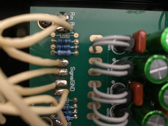

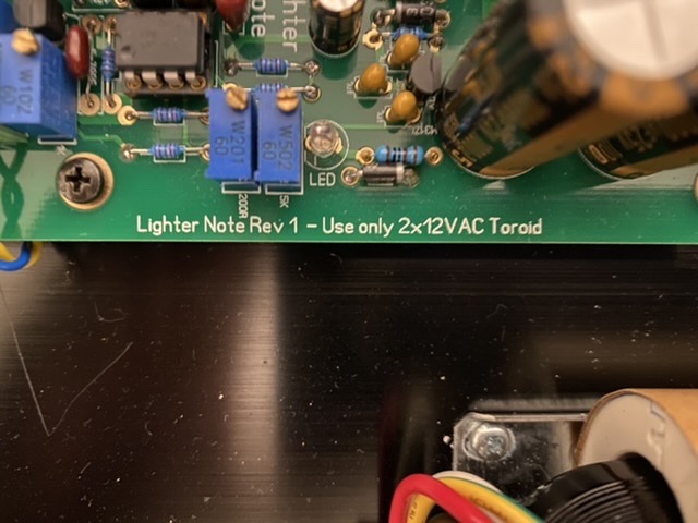

Here’s a couple pictures:
I’m also wondering what if any difference the R core might make?
The note on the pcb says “toroid only “

R core will work just fine. Your R core winding has two secondary windings instead of what is shown, a center tapped single winding. You can check the windings with an ohmeter as stated above. I have the exact same transformer and the blue leads are one winding, the brown leads are the second winding.
