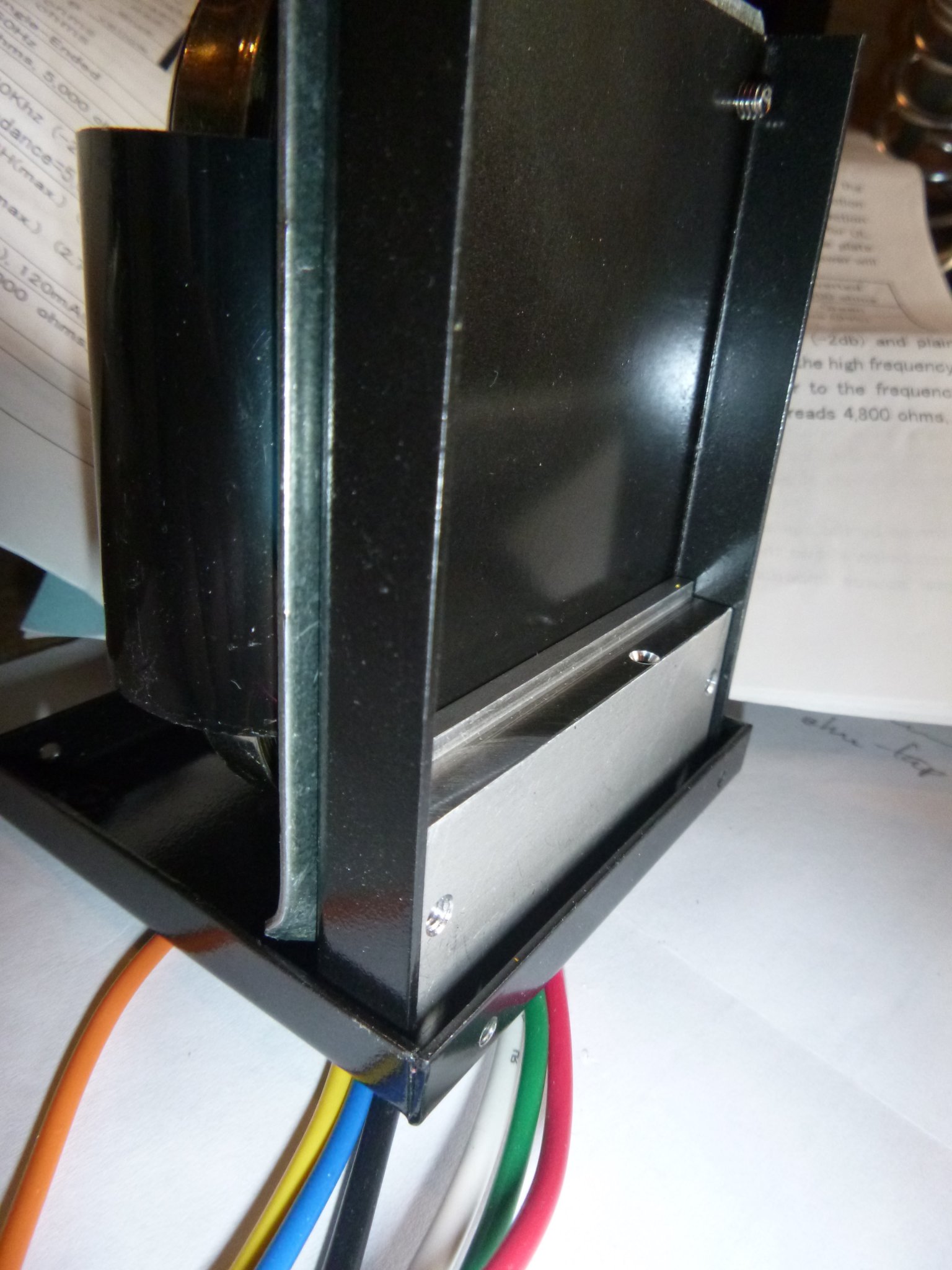

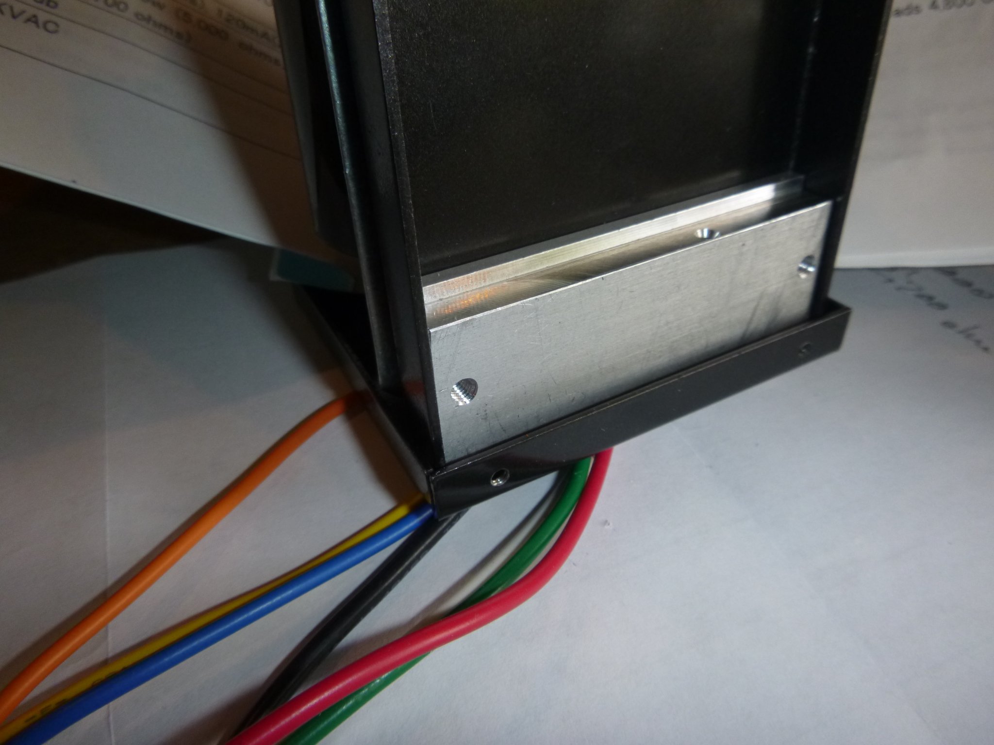

Mine had a crappy little spot welds holding the vertical trans mounting plate to the base. I made a little brace to join the two more securely out of scrap pieces of 3/8" aluminum. See pictures.
