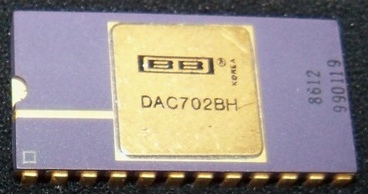

I bought DAC702BH chips from ebay, not tried it yet 😀
Nice chip design.
