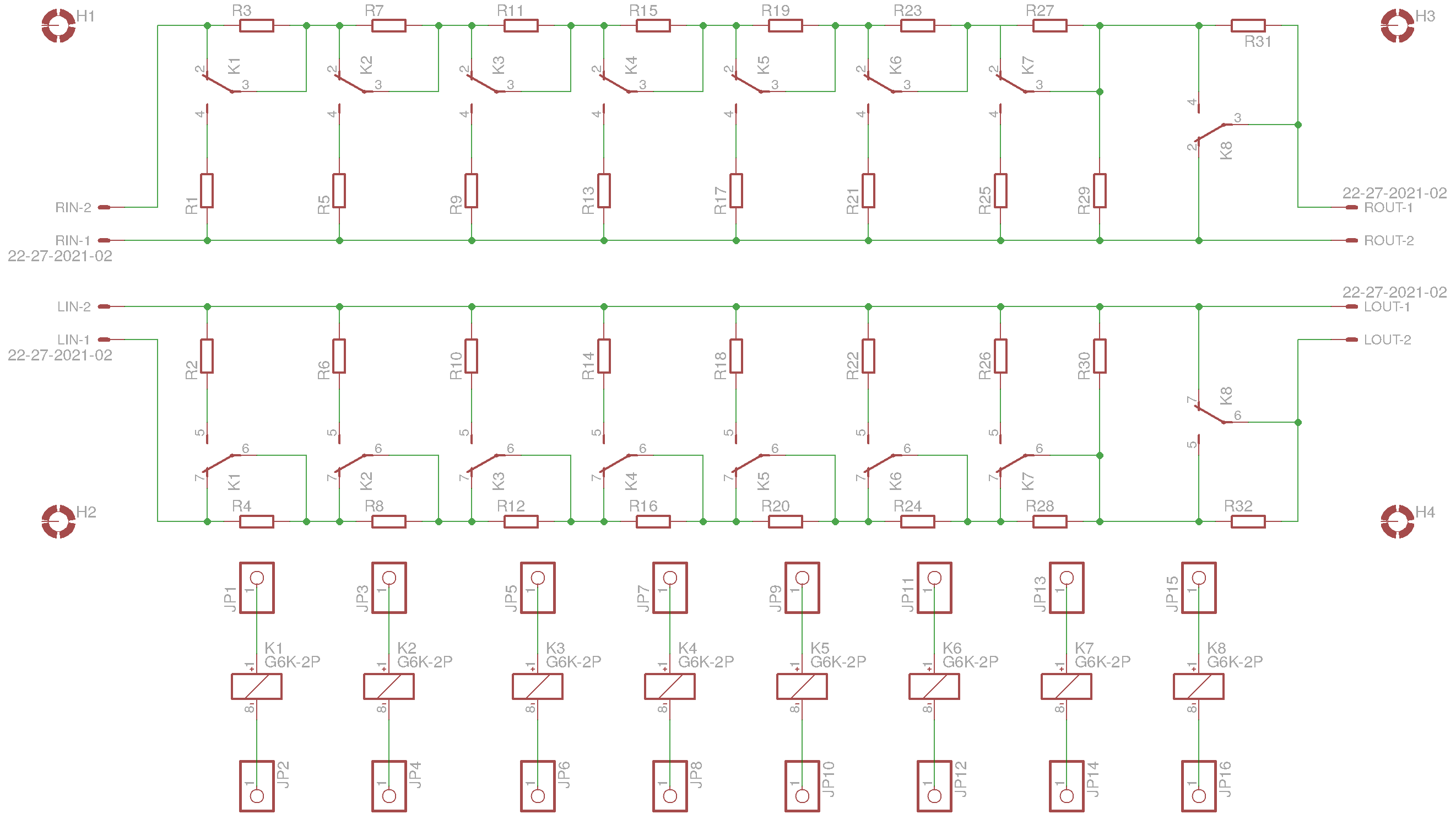

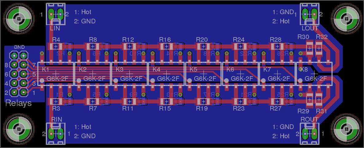

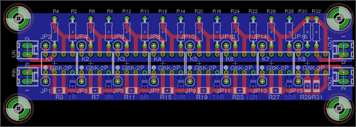

I've been playing around with R-2R attenuator board for my diy system. The attenuator will be controlled by the Arduino. The attached schematic is fairly standard. I have sketched two possibilities: with through hole and SMD resistors. I have not decided yet which way to go but am more inclined towards SMD version. I also decided to wire the relay coils off board via the pinheads. I've tried to follow the signal while routing the PCB but may have overlooked something. I am new to the PCB design.
Could some of the gurus advise me if either side of the PCB (through hole or SMD) have problems? Any input is highly appreciated!

I'll try to be more specific about my worries.
Could the connection scheme of the relay coils induce "switching" noise into the audio signal when relays turn on/off? There will be an unavoidable loop created by the wires feeding the relay coils. Four layer PCB would be easier but it is too expensive.
You need to add back-EMF snubber diodes across the relay coils, as close as possible to the coil (surface mount on the bottom?). I also would try to bring out all connections to one side of the board (one common for the relays?). This way you could flip the board for troubleshooting. E
Thanks a lot mickeymoose,
I just checked and SMD version of 1N400x would fit perfectly between the relay pins on the underside of the PCB. Initially I wanted to have them on the controller side... As for the connections I'll have to think how to route them to one side.

If you use a relay driver IC like ULN2003A there is no need for the diodes.I just checked and SMD version of 1N400x would fit perfectly between the relay pins on the underside of the PCB.

I would go SMD and keep all the resistors on one side of the PCB 🙂

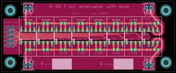

Below is the current state of the PCB. I'm in doubt if the relay coils wiring isn't too tight? I checked the creepage distance between traces for 5 VDC and it seems to be sufficient. Now I'm wondering if PCB producer can handle such a spacing...
Now regarding the termination resistor. The attenuator supposed to see a fixed load which is a combination of input resistance of the following stage and the resistor to ground on the board (if necessary) to match the desired value. Would it have any drawback if I use a DIP switch and install a set of different resistors to ground? This way I could adjust the load seen by the attenuator by simply operating the switch... Are there any sonic concerns of such an approach?

PCB manufactures will state their tolerances and sometimes even let you load them into Eagle with the DRC file and then Eagle will tell you if it's too close in the DRC check. OSHPark do this.Below is the current state of the PCB. I'm in doubt if the relay coils wiring isn't too tight? I checked the creepage distance between traces for 5 VDC and it seems to be sufficient. Now I'm wondering if PCB producer can handle such a spacing...
I also discovered that my manufacturer has the DRC file for Eagle too. Will try it on my board before ordering.

Below is the current PCB version. I finally changed the pads for 0805 resistors.
Now is the time for a small relay driver board to place between the arduino and the attenuator. As I understood the ULN2003A driver is 7 channels only. Will look for an 8 channel alternative.
