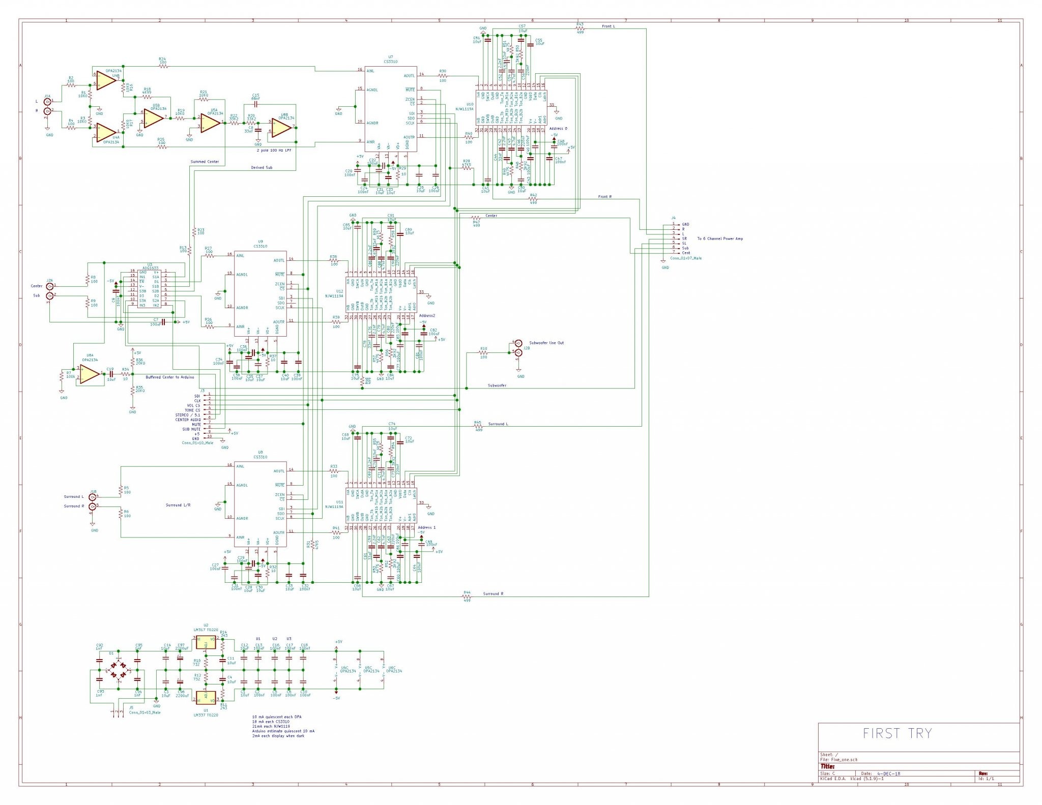

The analog outputs may or may NOT have the volume controlled by the remote. If it has an
earphone jack, that will be controlled by the remote. An old amp or receiver connected to the
earphone jack would be the esiest way to use external speakers. Toslink audio is NOT controlled
by the remote and if you DO try that route, the TOSLINK to ananlog must be capable of decoding
5.1 audio. If your DAC can not decode 5.1 you will get the most aweful noise you've heard in a
while. Here is what I came up with 3 years ago for your same problem.
https://www.diyaudio.com/community/threads/5-1-channel-preamp.342102/
For stereo only I started with one of these in 2016.
https://www.ebay.com/itm/1113892245...B1Mu9ntQcA%3D%3D|clp:2334524|tkp:BFBMyJuJotxf
At the time I discarded the micro controller and remote and used an Arduino because I could program
it to listen to the LG codes so I did not have to use a second remote to run the audio. The LG remote
and cable box remote runs everything and it works just like a plain old TV - Power, Channel , volume and
source selection from 1 remote so easy an old huy like I can use it.
BTW I'm working on a newer preamp with DSP for room EQ which should fit in the same box - if you don't
mind SMD.
It's DIY so have fun.
