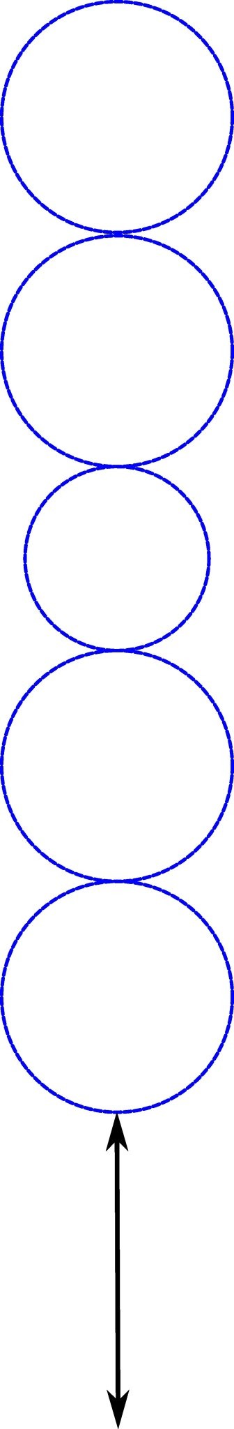

What do you think of this baffle-less MTM: Baffleless Aesthetically more challenging, but maybe fun to build? I really like the MTM idea with narrow or no baffle, but I'm not sure about the spacing in that picture—shouldn't the drivers be closer together or since its mid to woofer 1/4 to 1/2 is fine.
Since I'm using a coax and the system is time-aligned what would the benefits be to MTM? If I go narrow baffle I might experiment with wings but really I want light bass (it's a loft apartment with no insulation between floors, a little in the walls and very uptight landlord). It does have carpet, though. Normally I hate living with carpet but the silver lining for me was at least something going for me acoustically. Like I said I plan on playing appropriate music through the system at a quiet volume in what will amount to the near field.
I appreciate your comments on imaging in regards to baffle size. I can always get more MDF and experiment in the future.
Benefits of MTM with a coax: if you choose xover freq wisely* it can help mitigate floor/ceiling bounce.
Another benefit is it will help to make the whole loudspeaker even more 'point source' in it's behavior.
If you go with 4x low end drivers in WW+coax+WW ( something like this but with a coax in place of horn: https://www.pinterest.fr/pin/pureaudioproject-quintet15--1125968643622624/ )i can see an advantage in the acoustic design over a WWT: coupling to floor help make thick bass/low mid but sometimes it is too much with outcome of unaturaly sounding voices, 'bigger than life'. This can be pleasing but not accurate in my view.
By lifting a couple of WW above coax you should have a bit less coupling from floor and it re-center low/low mid at same height than mid and high emmissing point.
That said i observed this with boxed drivers not with OB, but i'm sure it would happen too in that case.
Here again i think a bit of prototyping would help you define if it matter to you, suit what you are after.

Thank you for sharing the calculator, it's a very valuable tool. I found some high Qts 10" woofers on close-out that are just too cheap to pass on for experimentation purposes. I'm going to buy 8 to play with. My ceilings will be very high: 3.5 to 5 meters. The floor bounce from top to bottom will be very asymmetrical. I'm not sure yet if the land lord will let me put up treatment yet. Something tells me no.
I've been thinking for some time of lifting the woofer from the floor, so thanks for reinforcing that idea. I want to avoid boominess. With an 8" at ear height using four 10" woofers I estimate I have about a foot between the floor and the bottom woofer.
