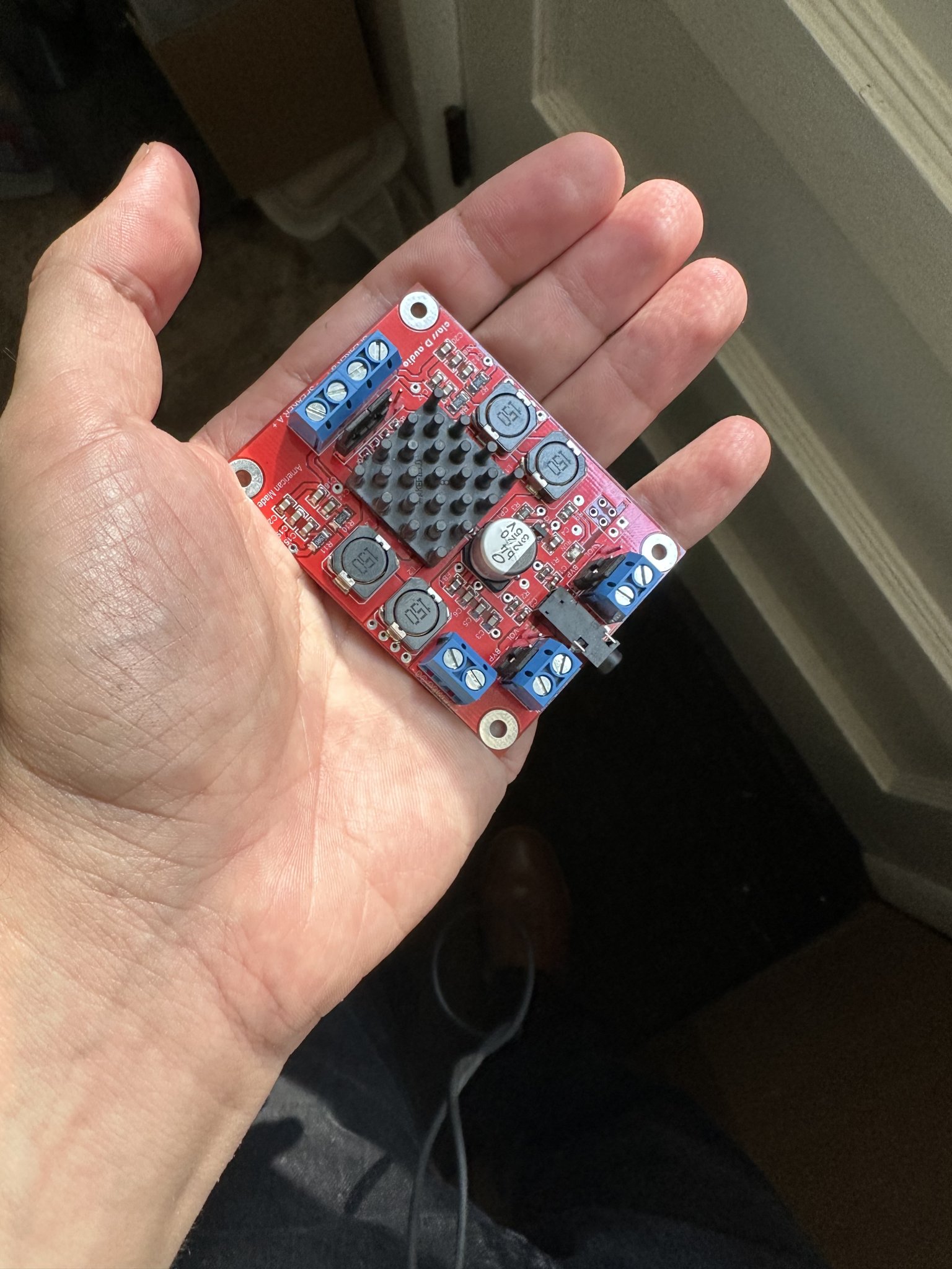

I just ordered two 2x15w boards from classdaudio.com to power the 12CXs/tweeters, but I also have an inuke1000 at my disposal if I need more power for the woofers. Question: I like dynamic systems, if I use a more powerful amp to power the woofers and EQ nulls will I loose dynamics? The woofers are 97db with 250watt RMS power handling. The inuke puts out about 160 watts into 8 ohms. Like I said, I'm not trying to get super loud with lean bass. Any tips for designing a DSP based system for quiet listening?

These are the boards I got from classDaudio.com. They are 2x15w bridgeable to 30w mono and I'm using 24v 3a power supplies for LEDs. I'm excited to use them. Like I said earlier my hearing doesn't extend beyond 16000hz so I'm not even sure if the more boutique amps out there would really be effective for me. Maybe I'll plug in my IcePower amps from my last project and see if there's a difference audible to me. Anyone is welcome to chime in on that debate!

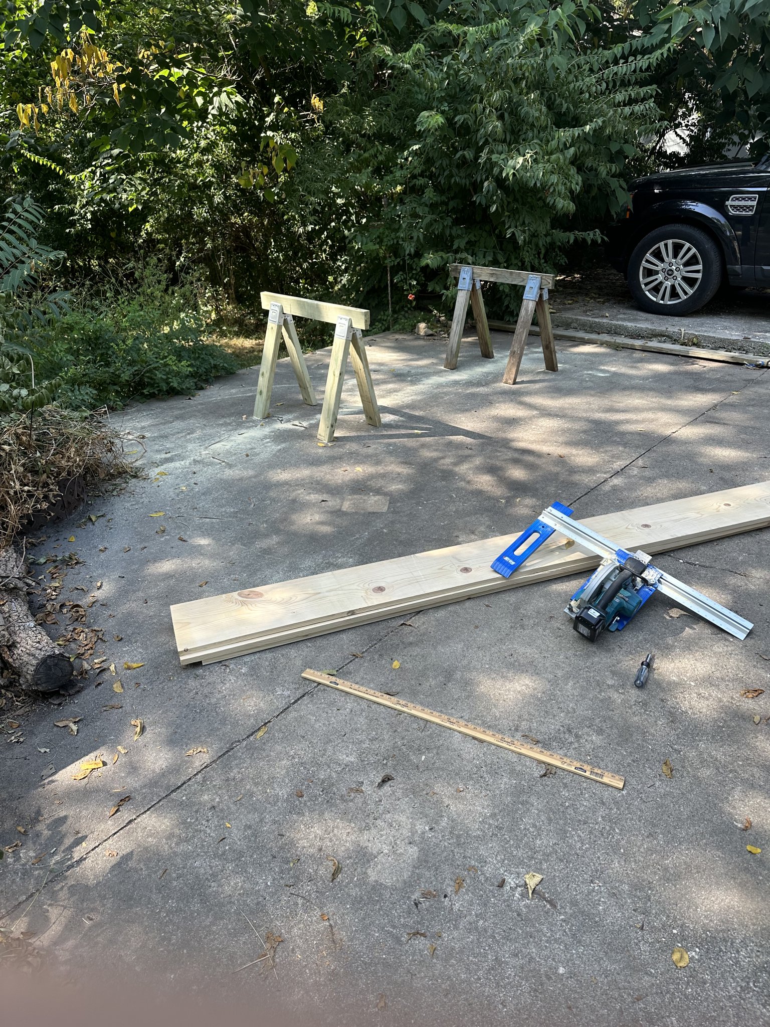

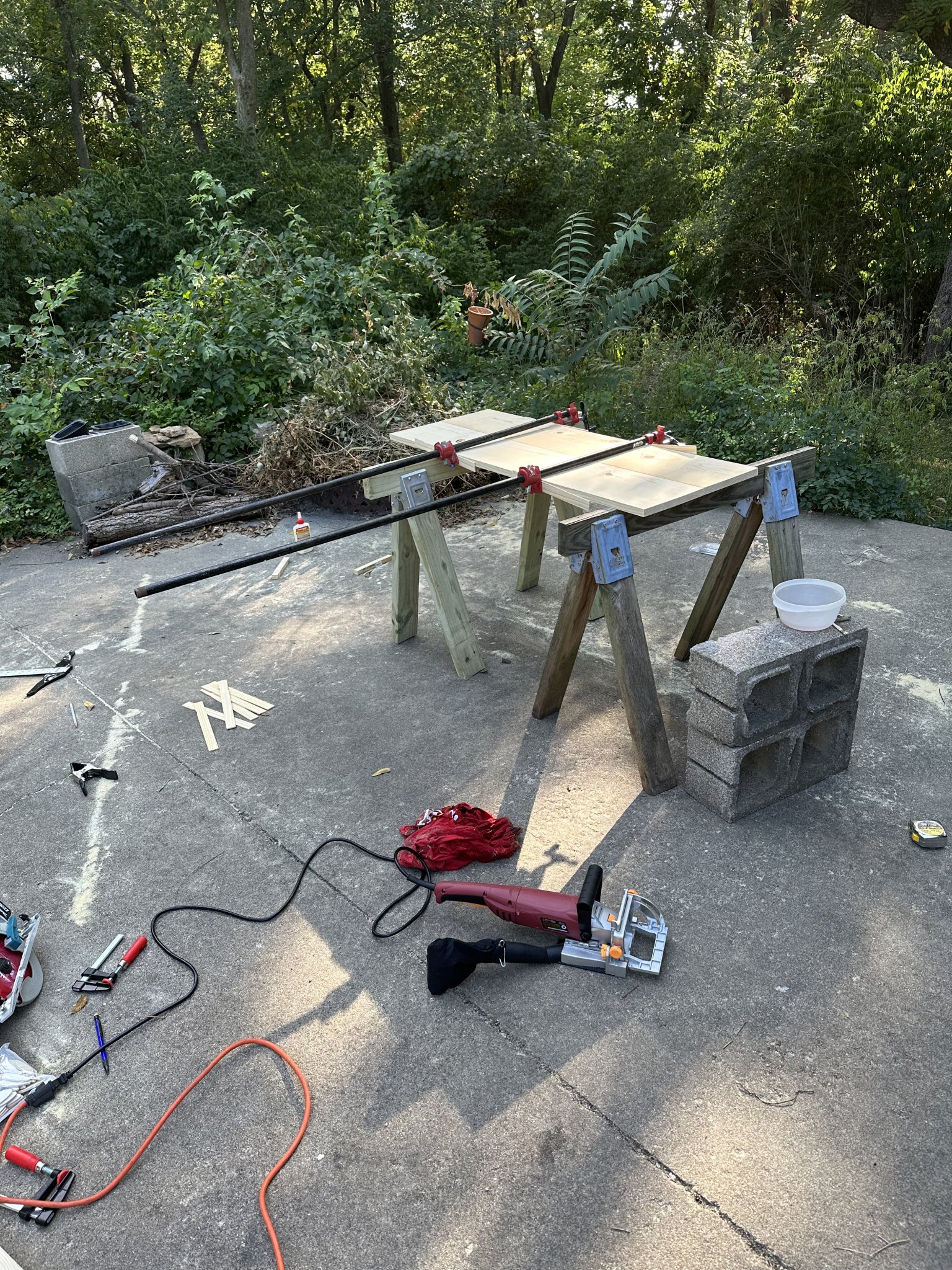

Well, I managed to rip some boards this weekend. Not as much work done as I'd like—it just got too hot to work outdoors. I'm using a Kregg jig to make the rip cuts since I don't have a table saw available at the moment.

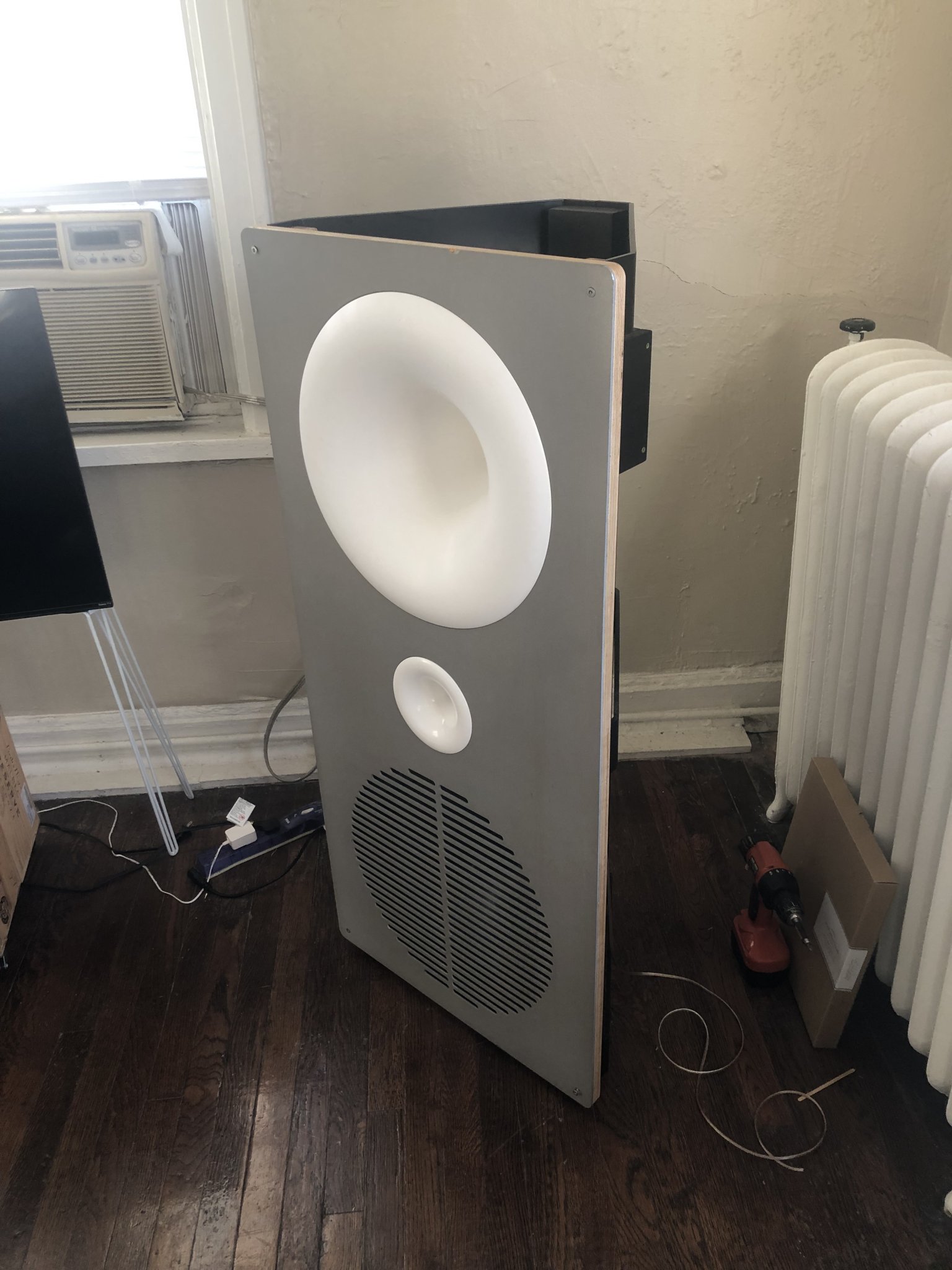

Here's the last speaker I built. A mono system. It probably doesn't sound as great as it could without some more work done in the DSP. If I could make one change it would have been to use a constant directivity waveguide on the tweeter instead of a horn, but it's been well received. My friend comes over and we spin records until late on it. It was my pandemic project and it does vocals like magic.

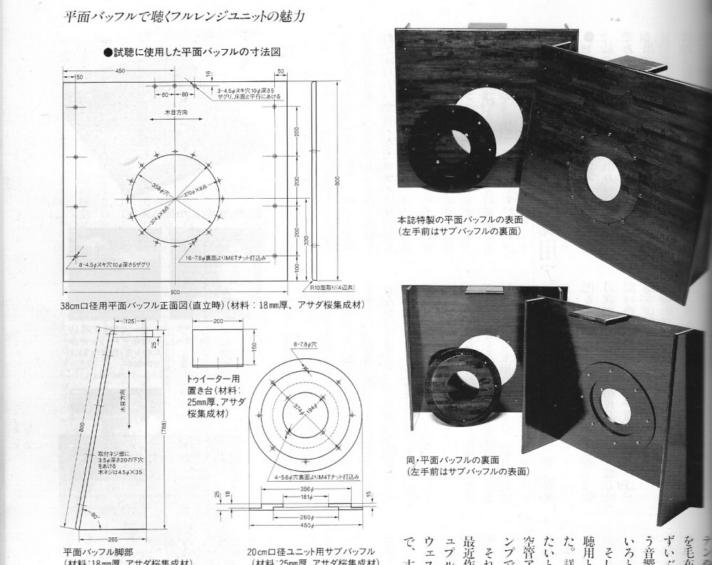

My goal as a DIY audiophile is never to have the speaker I want voted out on aesthetic grounds. I really dig the JE Labs Open Baffle plan from the Japanese magazine. I reminds me of Donald Judd's sculptures for its economy. For the last speaker I looked at the old Apple iPod Mini as inspiration and Dieter Rams era Braun products that inspired it in turn.

Only have enough clamps to join one baffle at a time.

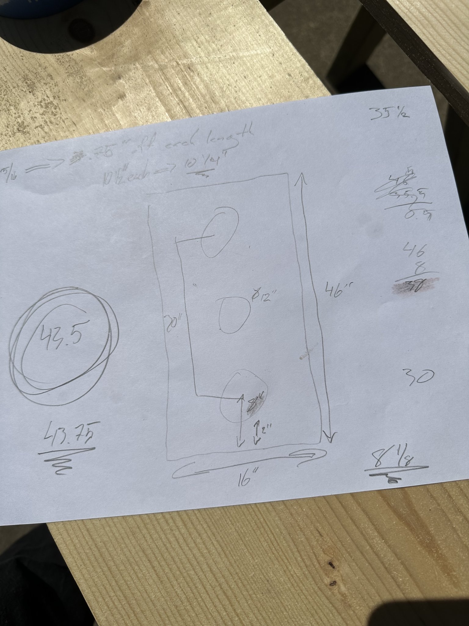

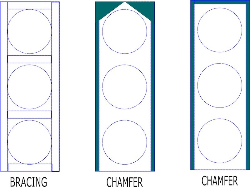

Never start without a drawing.
I should have access to a proper shop come December. I'm considering everything I do at this point a 1:1 scale model which I'll refine a second time over. Still looking for inspiration in the furniture of Donald Judd.
I intend to stick with pine all around with flush mounted drivers. Like a long version of the above stool stood on its side. Here is a drawing of how I intend to brace the baffle with 2x2s and chamfer the edges.
I'm thinking a 1" chamfer at least on the sides and perhaps oblique angles on the top. What do you guys think—which chamfer is worth the time and effort?

Chamfer: it's mainly related to diffraction so if you keep baffle width as close to driver diameter you don't really need it ( except for aesthetical reason). To gives you an idea and put things in perspective: E.Geddes used 2" radius for diffraction management of freq around 1khz for Summa. Shorter radius shift higher in freq the diffraction management...
Maybe it's worth prototyping with a narrow baffle and use removable 'add ons' chamfer to see if it is worth the effort.
One thing i would not do is to have same distance between driver/side and top.

One thing I would not do is to have same distance between driver/side and top.
Could you explain further please? I assume you mean off setting the tweeter from center, but do you mean to vary the distance between woofers?
Could I get away with an inch between the driver and the edge of the baffle and still get away from the diffraction?
