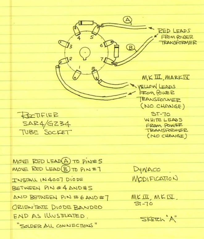

I would just do the "yellow sheet" mod to your amps, unless someone here has a good reason not to. That will prolong the life of those 5AR4's.

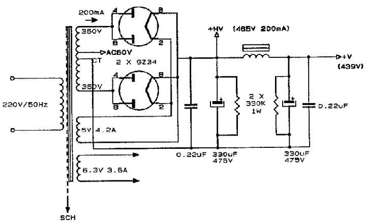

Is there anyone out there that also owns Quicksilver amps? If so would you happen to have this model? I would be more than willing to purchase a copy of the schematic. I have contacted Quicksilver and am told that they don't have a copy of this model, how strange.

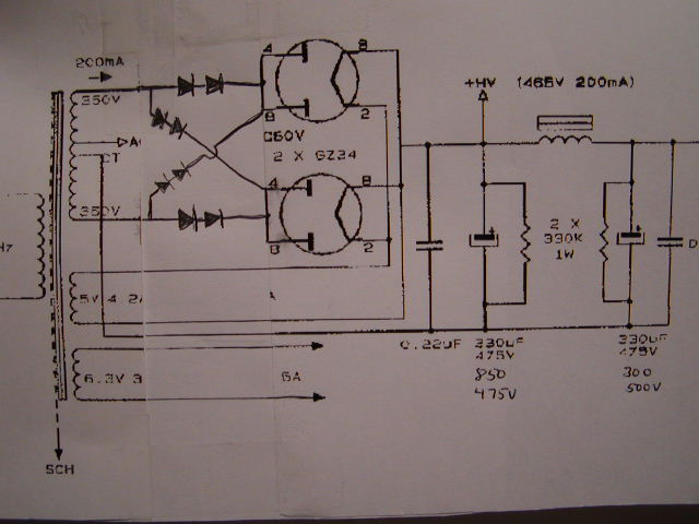

I've had a few pairs of the Quicksilver mono block amps. One pair of the KT88's like you purchased. As mentioned they do eat the rectifier tubes unless you add the diodes as shown in post #32 of my thread above. With the mod they will last for years.
The design of the Quicksilver is flawed because the size of the filter cap exceeds the rectifier rating. Before doing the mod I actually watched a pair of rectifier tubes flash with brilliant light a split second before the amp died.
Wait a minute, that can't be right, can it? You're shorting the high-voltage primaries together that way. The 5AR4s are wired in parallel, one tube acting as a single diode for each leg of the secondary. Those crossed diodes are not needed.
Agree. The high inrush current would cause the power transformer to vibrate excessively, causing a mechanical type of hum. This is true when silicon rectifiers are used. I wouldn't expect that if vacuum tube rectification were used, since the tube's heater warm up time provides a soft start that would eliminate that. Another remote possibility is that if the amplifier has a push-pull output stage, and one of the two output tubes starts to conduct before the other does, then there would be hum that would fade out once the 2nd tube starts to conduct current. This could happen if tubes of different brands or ages were used in the output stage.
I think the biggest problem was the sudden current draw on only one leg of the secondary, causing a huge imbalance between the two secondary legs, exceeding the secondary current rating and stressing the tranny.
Is that the same as "yellow sheet" mod mentioned above?
It's supposed to be, but I don't think it's correct. The crossed diodes are not needed and may hurt the transformer. Otherwise, yes, a pair of UF4007 diodes in series with each 5AR4 would reduce the strain on the tubes. In this case, the diodes are doing the rectifying and the 5AR4s are pretty much just providing the slow warm-up.
