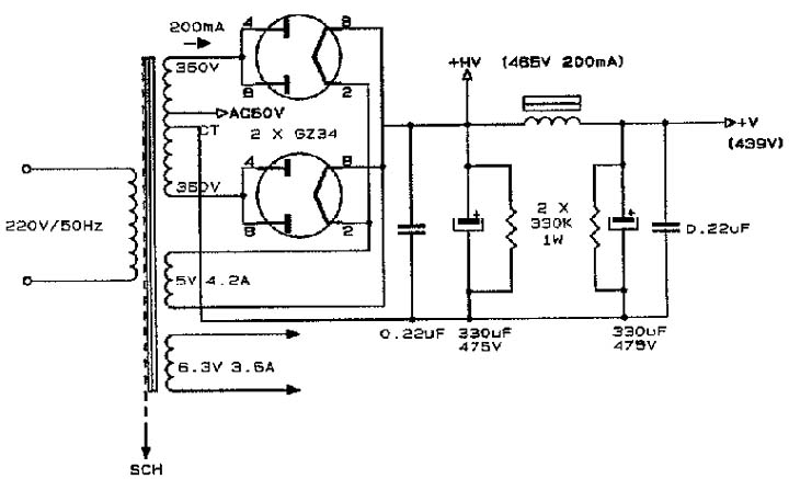

With respect to the short life of the 2) 5AR4 rectifiers.... back in 2002 I fitted my Quicksilvers with diodes prior to the rectifiers. The result is the amp retains the rectifier sound and the slow B+ warm up. The power supply caps were left stock. The amps STILL have the same 5AR4's that I had installed years ago. Thus the rectifier problem has been solved.
Info in my Quicksilver section.
I've also carried this idea to every Dynaco that I come across and the results are very positive. What a difference a couple of dollars worth of diodes do make in increasing the life of the rectifiers.

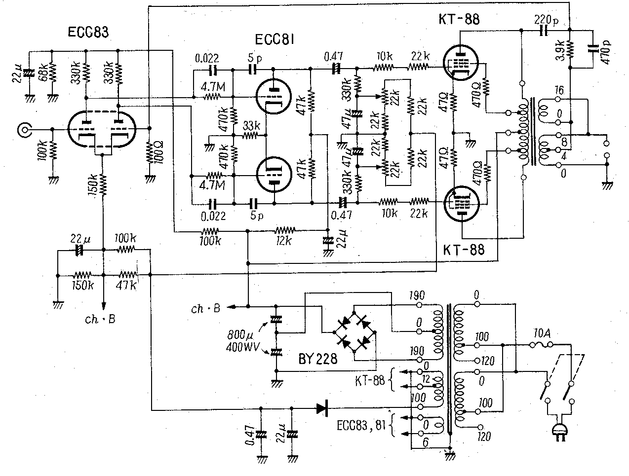

The key point seems to be forgotten.
Direct connected voltage amplifier and cathodyne phase splitter is a compromise.
It is working well only when a pentode amplifier is used, since this operates at optimum point with sufficiently low anode voltage.
Was waiting for this to come along. Why are we so bent on using a high gain triode input? In NFB circuits the fact that the input impedance is left at the mercy, thus may be anything from low to several 100K can affect the circuit stability or at least optimal h.f. performance, by virtue of the first triode's variable Miller capacitance. (Personally I have never seen a demand for an ECC83 in power amplifiers. I start with ECC88 or better.)
This is not the case with an input pentode, with the several other advantages. Something like an ECF80 works well within it limits, with hardly any capacitace at the signal input. Generally input pentodes also generate about 25% of the distortion of triodes. This not a great tribution to the total; still.

I need +/-30v to do the full 54 wpc on the 8417, while I plug in the KT100, and the same 430v B+, 60 ma per tube and the +/-30v swing gets me only 20 wpc...meaning the 8417 is really easy to drive and remain linear. It takes upwards of +/-50v to do the same 55 wpc with KT100.
So maybe a 6922/6DJ8 or 12AU7 with less gain than the 12AX7 would be more than enough to drive the 8417. I have 12AU7, and 12AT7 I could try...
