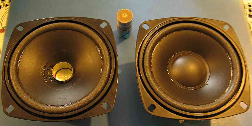

I tried out a quick and easy way to make a phase plug. It is not long lasting I guess but enough to make some tests . You can also shape the plug as you want it.

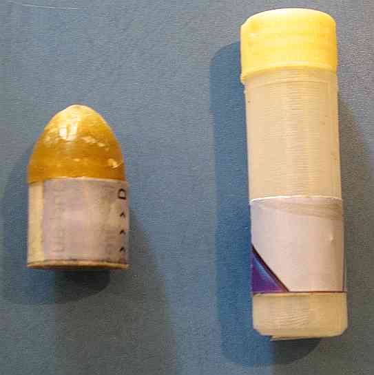

First make a small paper ring by wrapping some thin paper around a suitable former . Use a former slightly smaller than the diameter of the required plug. If your former is much smaller , you will need to wrap several layers of paper.
Then put in a small iron screw into the bottom of the paper ring and pour a little molten wax into it. Place the whole thing on a smooth metal surface.Let it harden fully. Then after it has cooled pour in some more. Not enough to melt all of the first layer. If that happens all the wax will flow out the bottom. Keep adding two three times till it is full to the top.
The initial paper cylinder should be just high enough to protrude out of the voice coil of the speaker.

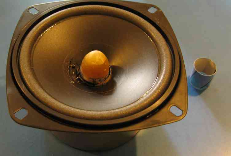

After the wax cools , wrap another layer of paper around this wax filled paper cylinder to get a new longer cylinder which is the height of the full plug. Then pour in more wax a little at a time. This time you could do it a bit faster . Let it cool slowly. If you put it in the fridge to cool the center will sink and you will get a huge depression.
After it is cool , you can unwrap the outer paper layer and then use a sharp knife to chip / scrape away the wax to get a conical plug with the shape you want. It takes a while for the insides to solidify. If its soft you will have to do it all over again !
The plug will sit easily on th epole piece due to the metal screw. Do not use a 'big' screw as you don't want it 'magnetically locked' in place.

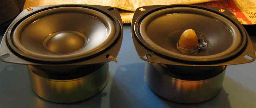

Here are some basic measurements I made on a 4 inch driver.
The data appears as follows.
Parameter - stock driver - driver without dust cap - driver with phase plug
Resonance freq ( Hz ) 121.2 - 131.0 - 131.0
Qms 5.4 - 6.26 - 6.25
Qes 2.38 - 1.92 - 1.93
Qts 1.65 - 1.47 - 1.47
