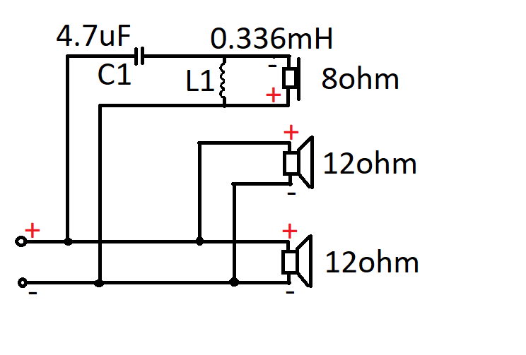

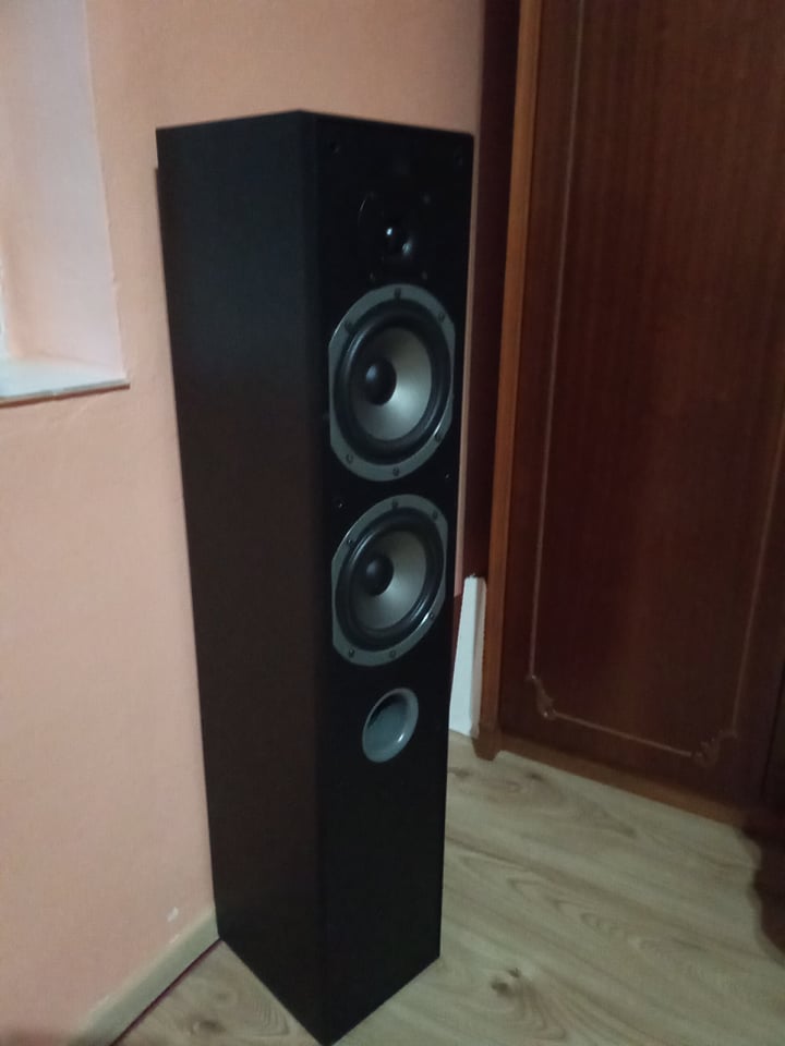

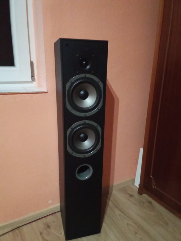

Here are the speakers, (two 6.5inch for bass mid range ) and sorry for schematic I used paint to draw it LOL ( for some reason I opened LTspice and it didnt work )
L1 is an air core, 0.6mm cu
Plastic former ? , what you typically see in crossovers.
Used an online calculator for inductance based on the size, how many turns, etc. , measured on actual LCR meter, its surpinsingly exactly the value it should be.
( Original Tweeter was 6 ohm )

If you do not know anything about specs on the woofers, you may want to measure the speakers if possible.
REW is fairly easy to set up and use.
Using an 8 ohm tweeter rather then 6 ohm may leave a little peak at the crossover frequency. You are loading a 2nd order crossover a little less and increasing the Q of the filter.
You could add something like a 16 ohm 10W resistor across the tweeters if you seem to hear a peak.
Also 4500 hz is a little high of a crossover point for 6.5 inch woofers. You could consider lowering the crossover point.
If the speakers sound good enough with the new tweeters then you should be set.
