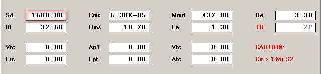

Hi, yeah HR is great, & about to get even better with the soon to be added Filters
I just now tinkered around in HR to try & get it to Auto derive Sd by wiping out the TS entries, & then entering as many as i could, in various different combinations. Hoping Sd would be Auto calculated. Unfortunately it "seems" to require more TS parameters to able to do that
It can however Auto calcaulate quite a few of them, after entering certain ones
WinISD though will Auto calculate Sd after entering the other parameters. The drivers in the screenies are not the same, i only posted them to show the Sd issue
