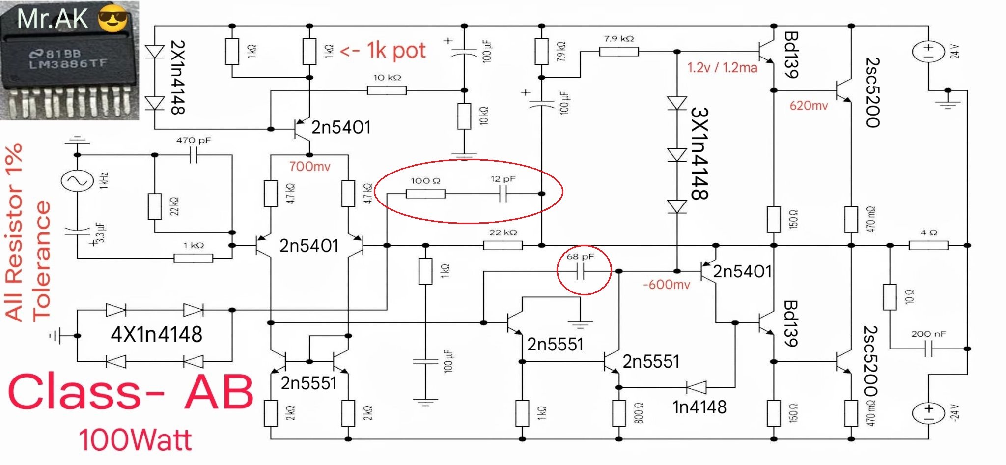

Hi, My question is : does the position of R1 C1 matter? C1 first or R1 first ?. In an amplifier output zobel.
- Bruno.

Zobel network is used to compensate the inductive rise (with the frequency) of the speaker impedance
and to assure the amp stability. Since it is connected in parallel with the speaker, care must be taken
to properly dimension the power/AC current ratings for these R-C.
To answer your question the capacitor must be connected to the ground, because it has bigger size than R
and will work as antenna, collecting all the el-magn. or el-static interference, and has the smaller
impedance, keeping the node of R-C connection at a lower impedance to the grnd, shorting that interference
signal to the grnd and preventing it from getting into the FB input node.
And, following this rule, the outer layer of the cap "winding" must be connected to the grnd, shielding
the internals of the cap.
I fact, the same considerations need to be applied to the grounding leg of the Voltage NFB R-R-C network,
where the cap will be electrolytic.

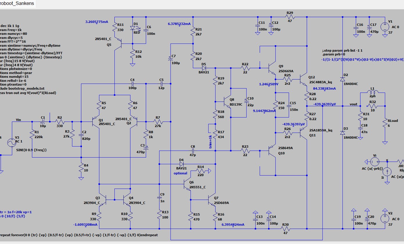

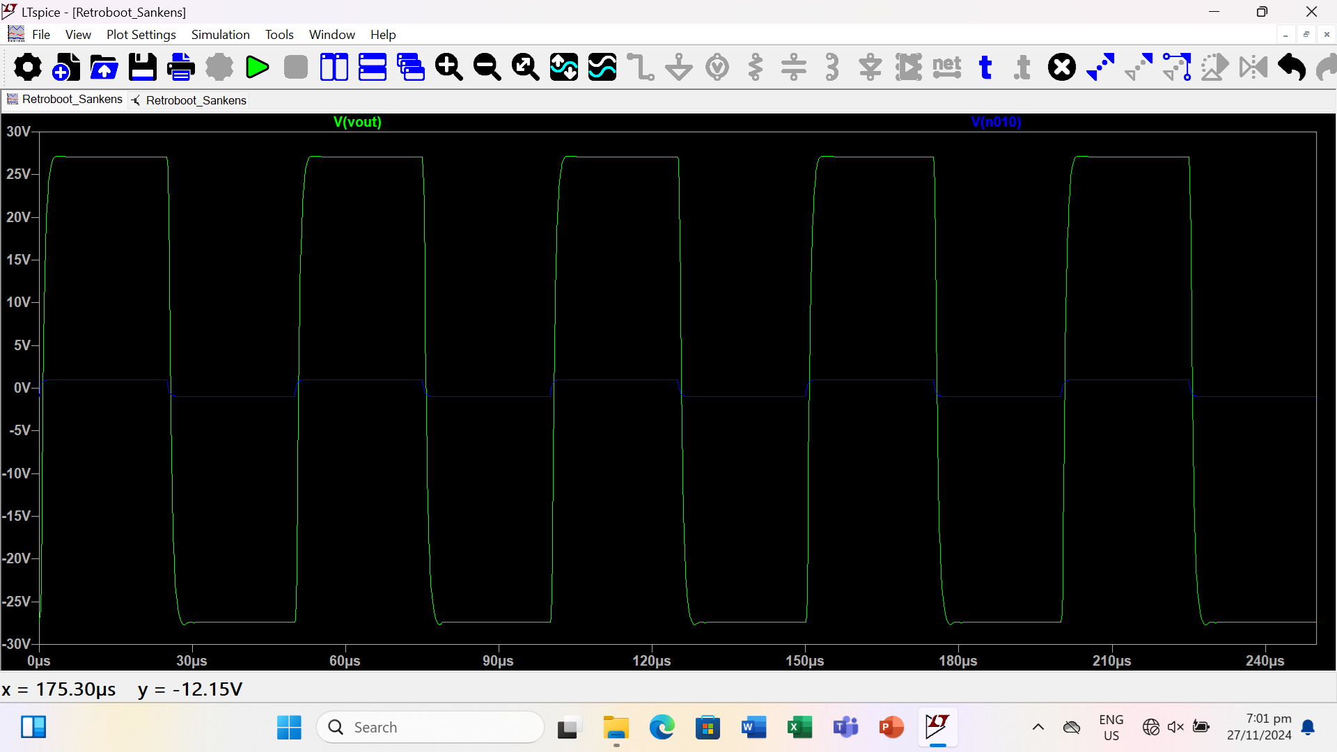

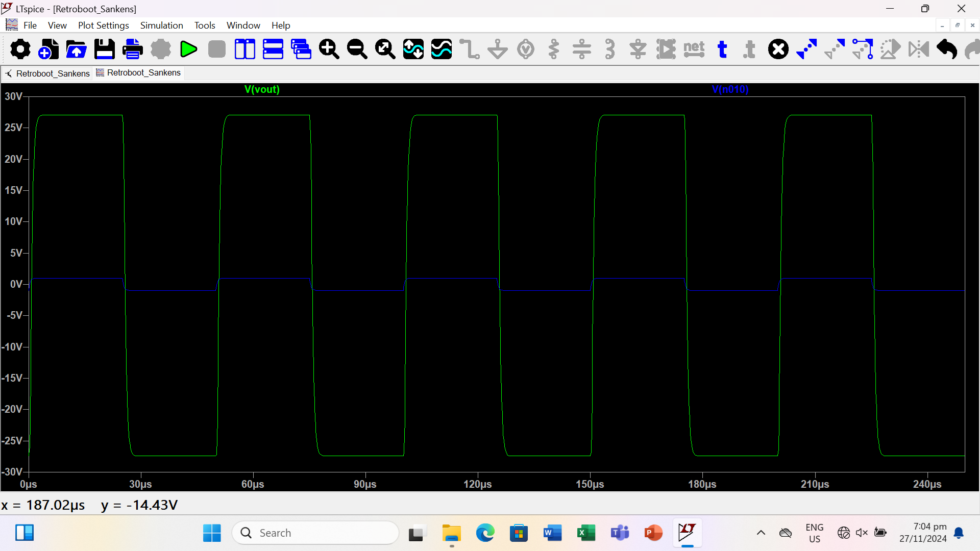

While working with my bootstrap amp to handle 6ohms load, a small spike appeared at the minus rail while injecting a 20KHz squarewave in simulation. It was surprising that what flatten it was lowering the value of 100nf to 47nf in the zobel network. I was using Sanken models for the outputs but when using the stronger Toshiba 2SC5200/SA1943 the spikes did not appear.
PS You may have to zoom-in the attached image to see the spike mentioned.
jxdking,
the schematic, still in simulation stage. I may have to increase the tail currents to handle 6r load and use the Sanken outputs or remain as it is and use the stronger Toshibas for the outputs.
You are quite right! I must have downloaded a different datasheet I was under the impression that the Sanken model was a TO-3P device. So that explains why, I was using the wrong Sanken model for the outputs. Thanks for finding the error jxd!
