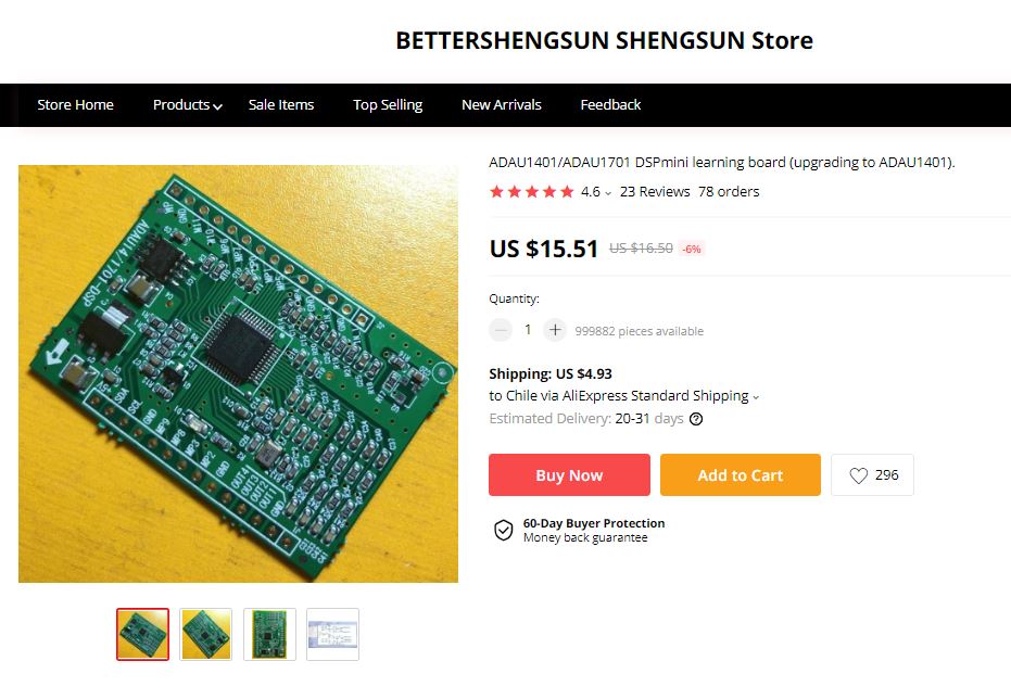

the setup consists of a cheap ADAU1701 DSP:
Buy Products Online from China Wholesalers at Aliexpress.com
Amp is Anaview Abletec ALC110-2300.

Your Aliexpress link takes me nowhere. Here's a link to the DSP.
WONDOM ADAU1701 DSP Audio Digital Signal Processor Kernel Board - Audiophonics

The DSP is the cheap green pcb ADAU1401/1701 from Aliexpress, which is basically the same as the Wondom.
About the amp, yes, you are correct... it's the ALC0100-2300.-
