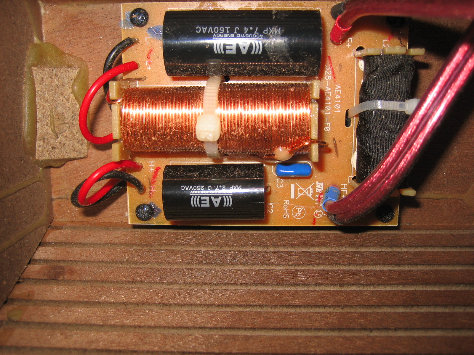

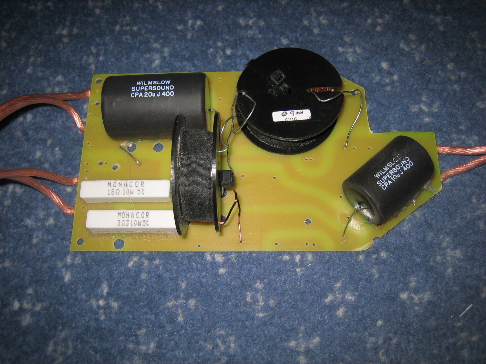

Ok, further update, just to recap. I was using Acoustic Energy Radiance Ones with a Scanspeak 3004/66000 tweeter. This worked fine, but the tweeter was so good I decided to upgrade the mid/bass driver from the pressed alloy to Scanspeak 15w8530koo. So I ordered a pair of Scanspeak mid/bass units, with a x/over to match my existing Scanspeak 3004/6000 tweeters.
I fitted these and the sound was as described in previous posts. Awful. So put the speakers back to were they were before I started and everything was fine. Anyway, I decided to put the Scanspeak mid/bass drivers back in with the the original Acoustic Energy x/overs, and guess what, It's fine, they work really well with the AE x/over. The bass is has should be, better the the AE alloy drivers if anything. So there you go, the problem is the x/over. Here is a pic of the x/over and the AE x/over

The crossovers are entirely different (you just have to look at the capacitor values) so no wonder they give wildly different results!
The supplier may have made a mistake when they designed the crossover to match the Scanspeak 15W/5530 to the Scanspeak D3004/6600.
