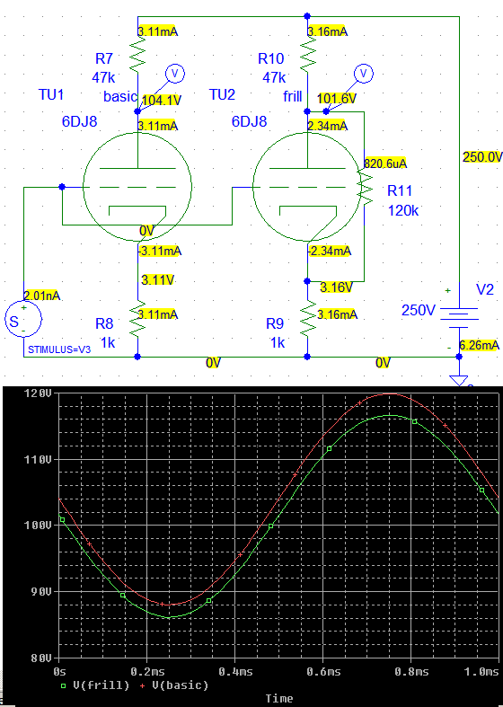

I have been experimenting with feedback options for an input triode tube in a simple se el84 amplifier. The input tube is 7dj8. The plate resistor is 47K and the cathode 1k. So on a lark I connected a 120k resistor directly from the plate to the cathode and the amp seems to sound better. Just wondering what is going on electrically. Any ideas.
Well, from a DC perspective some current is going to flow through the 120k, pulling up on the 1K, making the voltage drop across it a little higher. (You might even be able to measure that change with a DMM...)
Typically, this would bias the tube so that the quiescent grid voltage is apparently (from the tube's perspective) a little bit more negative, perhaps putting the tubes operating point in a somewhat better spot, at the expense of amplification stage gain.
AC wise I couldnt begin to offer a descriptive analysis. FAIK, that's the change you might be hearing, vs from the change in DC operating point.

From the basic AC perspective, you have cut the impedance loading the triode down, though we can't say by how much without having the schematic drawn out and posted. Connecting the resistor from plate to ground vs. plate to cathode will make a little difference, as you are injecting a little bit of what's going on at the plate back into the cathode. The only place I've seen this done is on the split load phase inverter in some of the old Fisher amps. The cathode is pretty tough to drive though, so I would expect a rather modest difference when comparing connecting the non plate end of this resistor to ground vs. cathode. Perhaps you could start by measuring the difference in gain between the 120K resistor connected to the cathode vs. connected to ground?
Since you are driving an EL84 with a 7DJ8, I would guess the EL84 is triode strapped, so we'll guess that your B+ is about 300V. In this case, the 47K plate load and 1K cathode resistor would give about 3.7V of bias and 3.7mA of plate current with 125V on the plate, so there's nothing wrong there.
It has around 250-260v on the input of the 47k plate resistor and maybe 3.6v on the cathode with the 120k resistor in the circuit. It does sound like there could be some negative feedback but likely a small amount because the overall gain of the amp isn't very diminished. Yes, the el84 is indeed triode strapped but I have it is running a little hot at 330v and 30-35ma on the plates.
It's positive feedback. Just not enough to matter.
In a related scheme, Bogen used to run a resistor *from B+* to an under-size cathode resistor. This gave them the DC bias with a small cathode resistor and more gain without a cathode capacitor.
But in general I think "the amp seems to sound better" is essentially meaningless.
THD at 10V out is raised from 0.4% to 0.7%.
FOURIER COMPONENTS OF TRANSIENT RESPONSE V(basic)
TOTAL HARMONIC DISTORTION = 4.131270E-01 PERCENT
FOURIER COMPONENTS OF TRANSIENT RESPONSE V(frill)
TOTAL HARMONIC DISTORTION = 7.277961E-01 PERCENT
Tube is driving 2/3 the load with 3/4 the current, so "double" makes sense.
