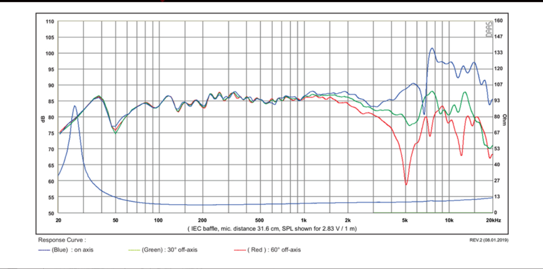

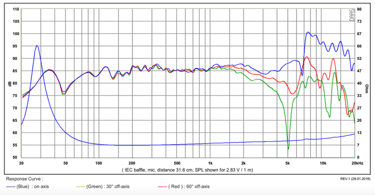

"SB Ceramic cones consist of an aluminum/ceramic dual layer cone"
Do you see any similarity?
Technically speaking this is not a ceramic cone.
It's a oxidized aluminium cone.
Which should not be a surprise when you look at those two pictures side by side.
But they do look pretty with the surface treatment.

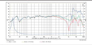

Also notice that the cac 35-8 has the magnitude with 4ohm impedance in both versions on the site.
