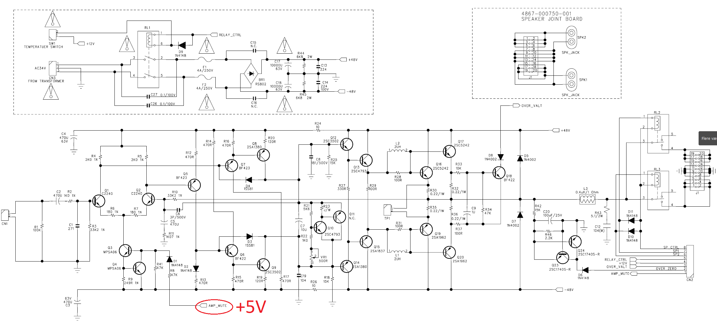

I have a quick question about the function of the "Mute Amp" pin on the Harman Kardon 670 (early 2000s model).
I am not very versed in electronic circuits etc, but it seems like you need to supply +5v to the pin, in order to "un-mute" the amplifier board?
I have bypassed all the relays, so it they shouldn't have any effect on the output.

If you consider the front section as a totem pole differential amplifier. Q1 has the base held at ground or 0v through R3, Q2 has its 0v point taken from the output through R10.
To allow these components to work, they need a current source on the emitters through Q3, R9 sets the threshold of Q4 which limits the collector current through Q3, R4 holds the base of Q3 at -ve rail ensuring Q3 does not conduct. When a voltage is applied across R41 Q3 will conduct allowing Q1 & Q2 to conduct and amplify. R6 & R7 helps to balance the hfe of Q1 & Q2 and stops the gain from being too high which in turn may cause instability.
Lots of computer generated silly values for resistors I notice.

So I wouldn't be wrong to put 5 volts on the "mute pin" since Q3 completes the "circuit", making current flow? I have to triple check. :p

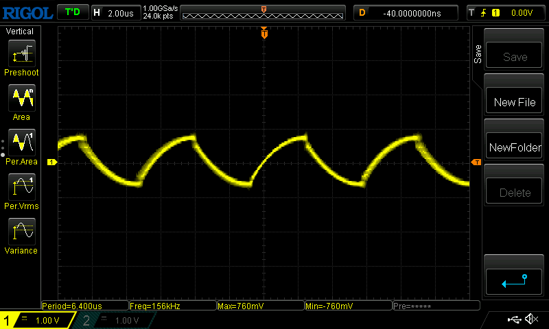

I tested it, and it works. Thank you for the confirmation. Now I just need to eliminate this stuff from the SMPS.
It's measured from the speaker output, and it's the same regardless of the set volume.
And it goes away if I disconnect the output of the pre-amp, into the amplifier board.
There are no ground loops, but oddly enough, if I connect an additional ground from the pre-amplifier's ground to the amplifier-board's source input ground, the noise reduces by 300 millivolts from one peak to another...
Could the pre-amplifier board be in need of shielding, or does it travel through the aux power output of the SMPS, and end up in the pre-amplifer though the 15v-0-15v is regulated to 12v-0-12v?

My guess would be that the ripple may be injected into signal ground on the preamp board. At 156 kHz, the usual 78xx regulators would not provide too much PSRR (and neither would typical amplifying circuitry), and on-board bypass capacitors would do the rest. The only ground path for bypass capacitor ground currents may be via the power amp connection, explaining why strengthening that reduces the amount of ripple seen.

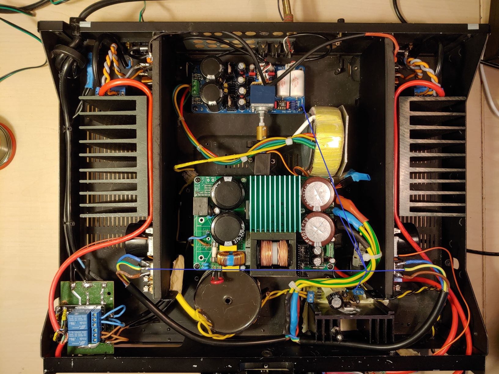

A couple of years back the amp gave out. I located multiple problems with it back then, such as dead caps in tone-board, and the "logic" power supply.
Relays didn't work either.
Forward til today, and I wanted to reduce it's weight, so it could be placed on a floating TV-stand. And since it was gutted years back, there wasn't really any other options.
A picture of the whole thing would not hurt. How much of the amplifier do you have left? Are you following typical wiring guidelines (twisted V+/V-/Gnd etc.)?

Where is the rest of the schematic going to CN2
I rather think there is only 12V and not 5V available
I posted the service manual link. The amp is playing with 5v in the pin, as the schematic said.

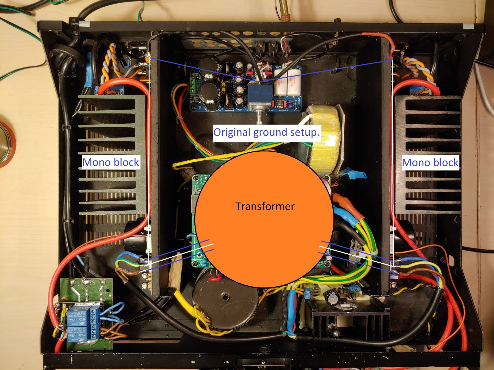

I have thought a little about it and when you think about it, the amp was actually originally two mono-blocks which shared ground through the audio input, and not on the power side.
The only thing connecting them on the power stage, was the transformer, and that wouldn't work. Center tap or not.

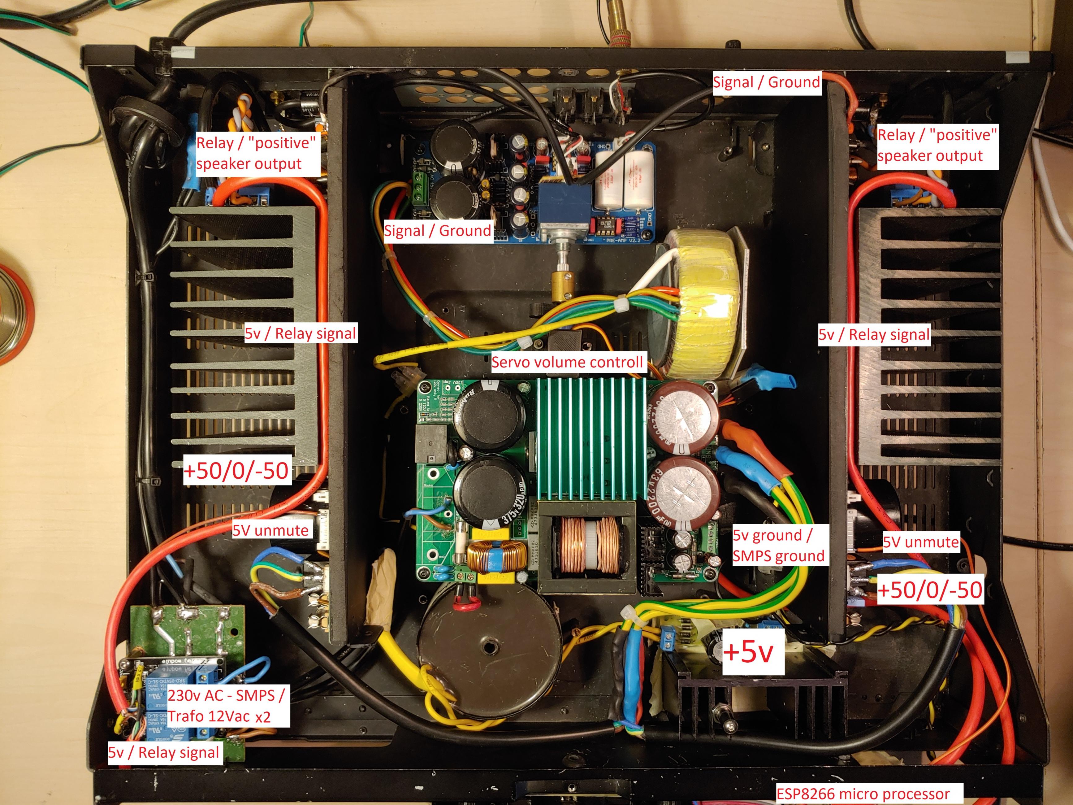

I have attached a picture with simple descriptions of the wires and a zip files containing the sound of the noisy hum.
The hum isn't that loud, and the amplifier plays very nicely, minus the hum of cause. The hum remains the same regardless of the potentiometers position/ volume, so the noisy hum is not coming from the pre-amplifiers output.
I had some cables refitted for the main power rails, so no, they are not twisted at this moment.
I also tried to move around the transformers inside the chassis and even move them out of the chassis, without it making any difference at all. So I assume it's not the censer wire in the SMPS' transformer picking up the electric field from the other transformers.

I have now put in twisted wires on the power rails, and it makes no difference to the hum.
It seems like there is a little reaction on the oscilloscope when a touch the chassis of the amplifier.
The amp is NOT earthed originally, and there is no earth in my apartment's wall sockets.
This haven't been a problem with other SMPS based amps before, and frankly, I do not know if it's the root of the problem?
I am now.
First of all, replace jumper GND Jmp (next to main output) by a resistor of 100 ohms to 1 kOhm, or leave open temporarily.
Believe it or not, but my version of the SMPS does not have the jumper.
There is no continuity between the chassis and the 0v, according to my Brymen multimeter.
The thing I'd want to know most of all is which mounting holes are connected to mains IEC earth directly (and if not, where else they connect).
No earth on chassis at all. It's a floating circuit though.
The right mounting hole next to the mains input on the SMPS has an earth connection.

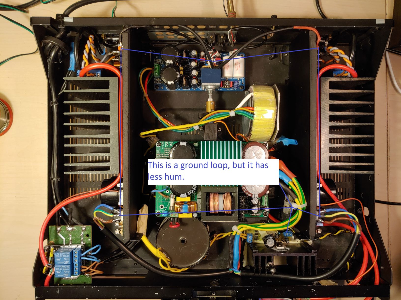

I can't get rid of the noise by anything I can come up with.
having the earth on the SMPS connected to the chassis reduces high frequency noise on the speaker output significantly, despite the chassis not being connected to mains earth.
But I can't get rid of the hum, no matter how the ground connections are arranged.
How I see it right now it could be 3 things.
1. The amplifier was originally only designed to have common ground through the signal path.
2. The SMPS is the culprit.
3. A combination of both.
