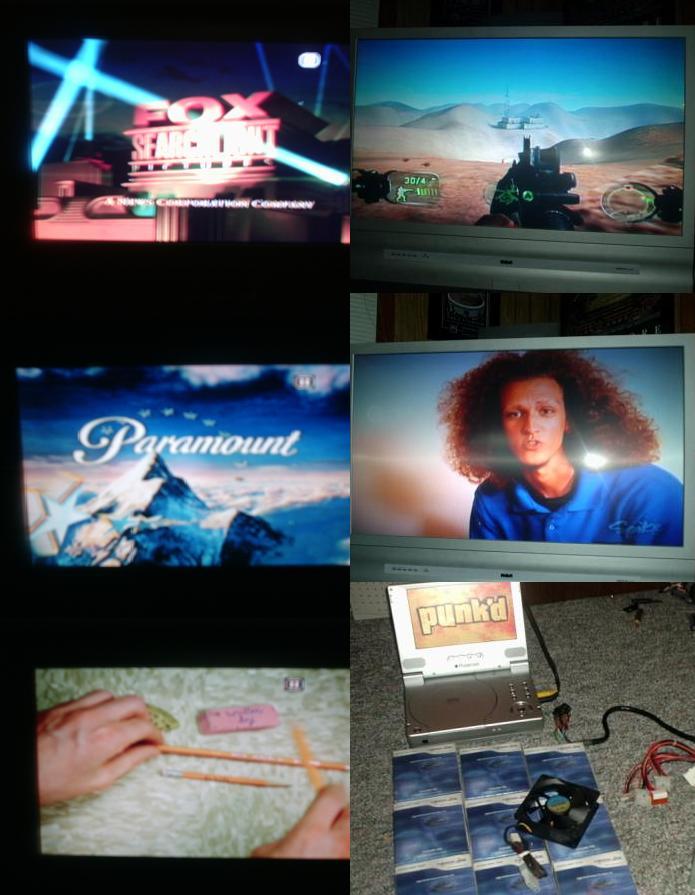

Heres some pictures of the polaroid DVD player compared to our 52" HDTV RCA widescreen.
obviously the flipdown isnt nearly as nice of a picture as the HDTV but I am going for a movie-theater-like enviroment and I think this should be perfect...But the portable DVD player's picture is phonominal, as you can tell in the last picture. even on basic cable, which is usualy terrible on smaller lcd's...the pictures amazing.

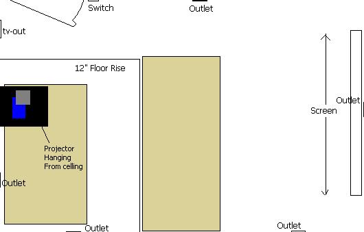

heres my layout...gonna rise the back a foot to give a movie theater feel and for better visibility.
also. to answer another expected question... the 52" is in our family room, theres a 40" in the living room...but we have a 10' x 14' room with wasted computers stack on top of eachother...and 2 beautiful suade couches.... plan on having a nice theater room to relax in and get together with friends...

It is possible to make some optical keystone correction with a split fresnel projector design, but you would be much better off if you can put your projector perpendicular to the center of the screen. DIY LCD projectors (even with 8" LCDs) tend to be much bigger than commercial projectors. Not many people hang them from the ceiling.
